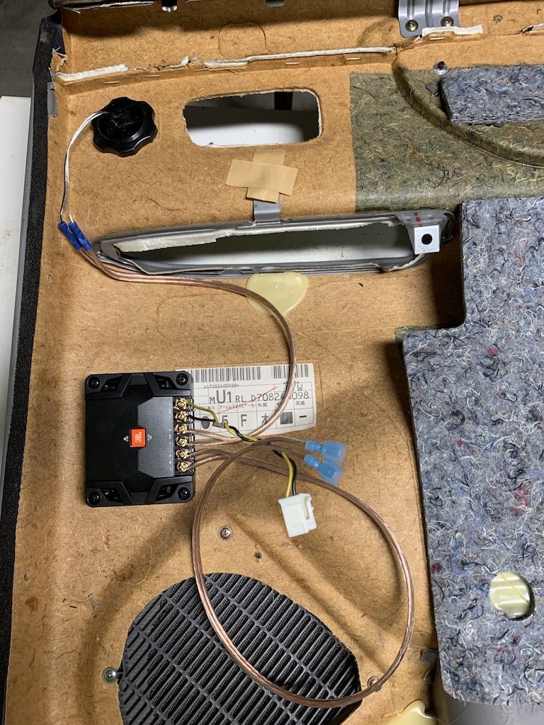

Where did you install the new tweeter's I haven't done this this before but would like to install something similar. Found some good prices on infinity speakers on Ebay. IF you have them, I would love to see pictures. Any more insight on the install is appreciated. Thanks
I just looked through my photos and i don't have any that show the crossover. Mine were Infiniti kappa and they were small, but in my case i put them next to the woofer on the elevated panel.
Look at the door panel that you took off, there's a space right next to the speaker grill, that's where i put it on the door.
For example, on the drivers door, if you're looking at the woofer straight on, the crossover is on its 9 o'clock position.

I need to find the pics of my front doors, but here are the rears dismantled. You will get the idea of how to mount the crossovers for the fronts.
