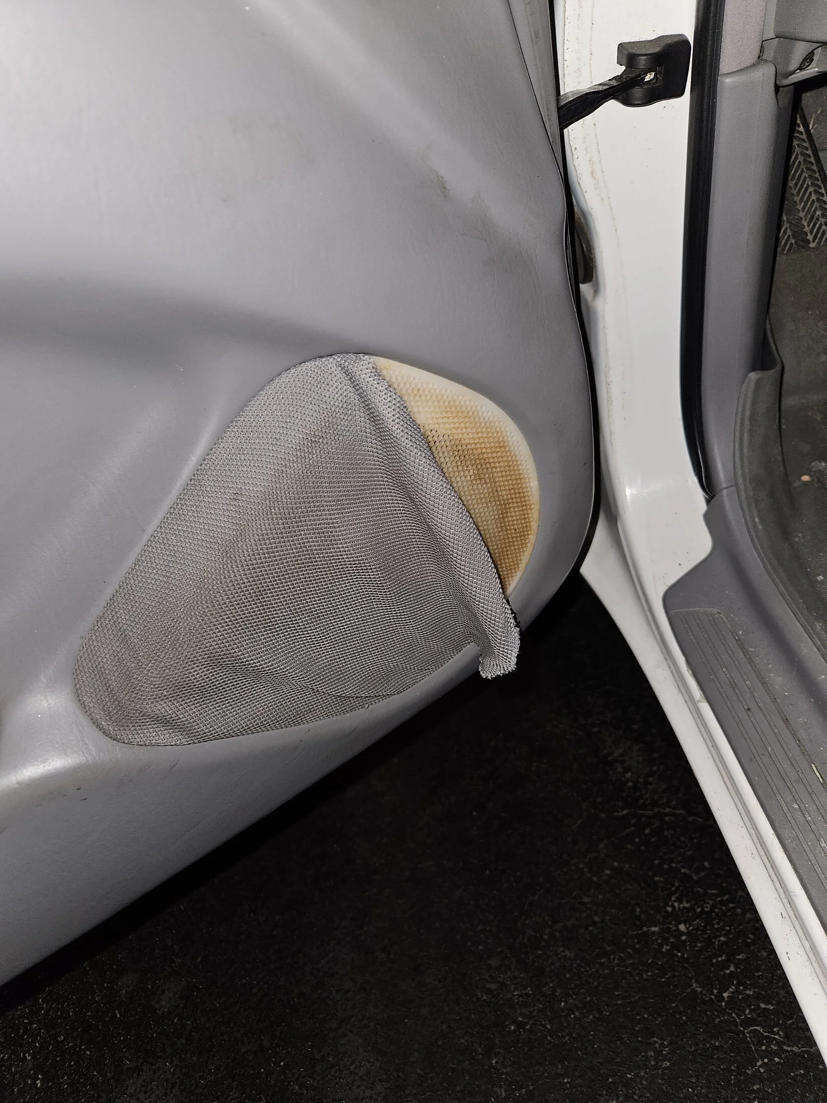

Searched the forum, but couldn't find anything, on my 100 series LC, the cloth that covers the speakers is pulling off (see pic) and I just want to try and make it look nicer. Before I try gluing in place, do these speaker covers pop off where I can take them inside and glue or re-secure them, or do I have to try and re-glue in place? Any help is appreciated, thanks!

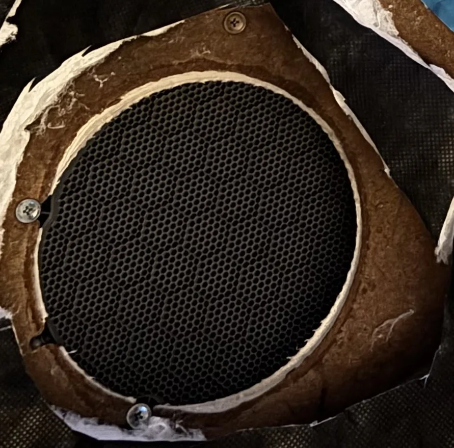

Remove your door panel, and the grills come off with a few screws. See a few of them below. Get similar colored grill cloth from a fabric store/online source, or re-glue what you have if it’s in decent condition.

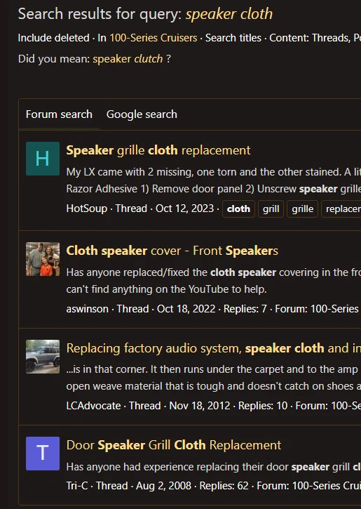

Here's 4 threads that cover it, first one has great how to and pics.

Unfortunately the door panel does need to come off to get them off, they don't just pop off.
