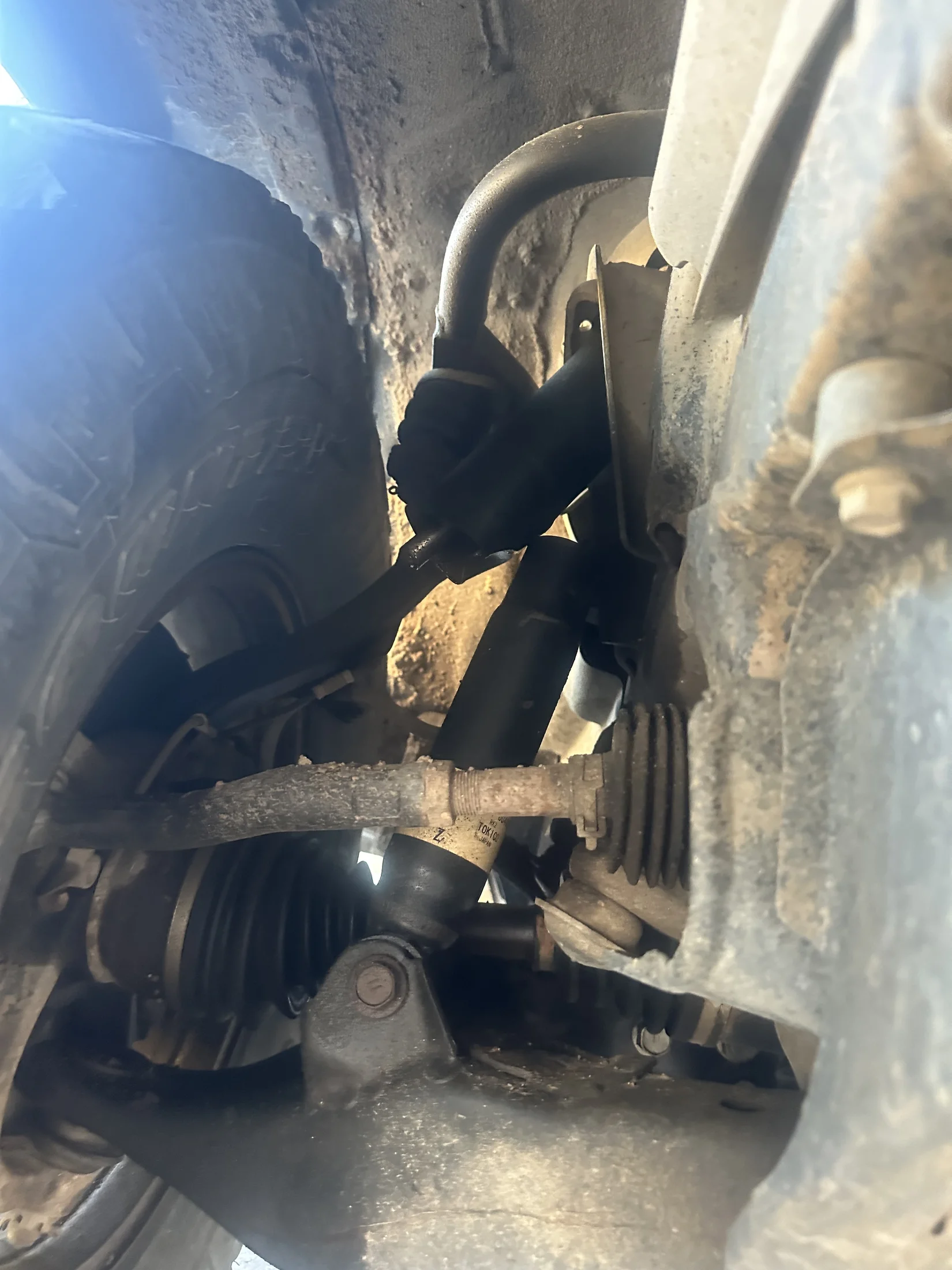

Hey,
What front shocks do you recommend for 2.5 lift, indexed front torsion bars, no added weight? Want comfortableish ride while spirited desert and rocky mountain trail off-roading but am on a tight budget.
I had previously replaced OME with OEM for better comfort and less $ and they’ve suited me fine for the last 5+ years, BUT I just broke my passenger side shock in half on my last trip over the mountain from Joshua Tree to Big Bear CA.
I’m trying to keep costs down…
Thanks,
Ted

Any ideas what would cause it to break like that?
The shock in the stock set-up is also used to limit suspension extension. Limited up travel (lifted IFS) will increase frequency of topping out the shock. A limiting strap would do a better job and take the stress out of the shock.
