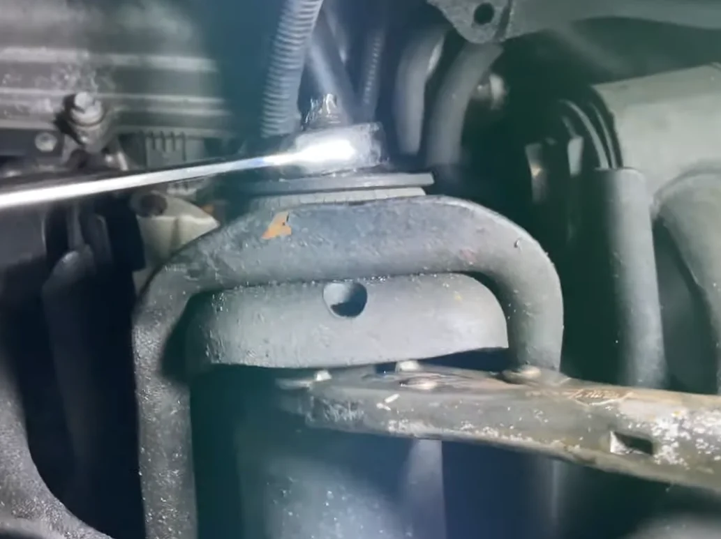

Whenever you get around to re-installing for the OEM shocks a 8mm wrench can be used on the very top of shock to hold it while you tighten the top nut. The longest 8mm wrench you can find is what you want to use.
Edit: The 8mm only works for the front shocks.
Appreciate it. The other front shock top nut came out rather more easily. May be i showed more patience to it and i dont have any rust issues on my car. Used the propane torch around the nut and then held the shock with a mega pliers and i was able to break it free.
Thanks for the 8mm tip, i like it. It seat perfectly.
