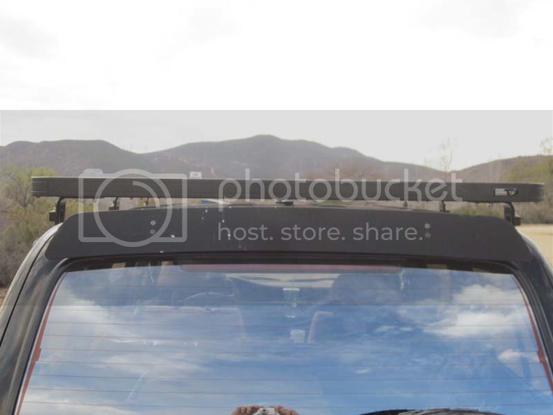

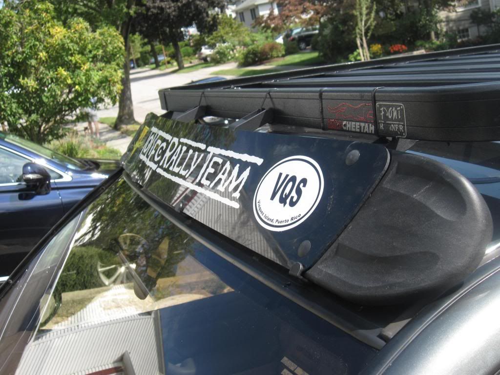

The Front Runner air dam? If so, I don't know, never installed it. It obstructed 80% of the sunroof. Generally, the south africans engineer great products, but they missed the mark on vehicles with sunroofs...
Thus the jerry-rigged option I came up with below. This one is on my UZJ100. You can see similar on my grey FZJ80 posted in my Garage.

I never had any adhesive foam pieces. I just centered it and fastened per instructions and it is super quiet. REDrum, we are talking about the slimline II series, not sure of the difference between the Wind cheetah but they come with a wind deflector and for me it is quiet. You can also omit the installation of the cross members over the sunroof if you like for an unobstructed view or access to the rack from inside the vehicle.
2.5 inches from the roof to the center of the air dam with the 'tall' legs. That is just in front of the sunroof opening.

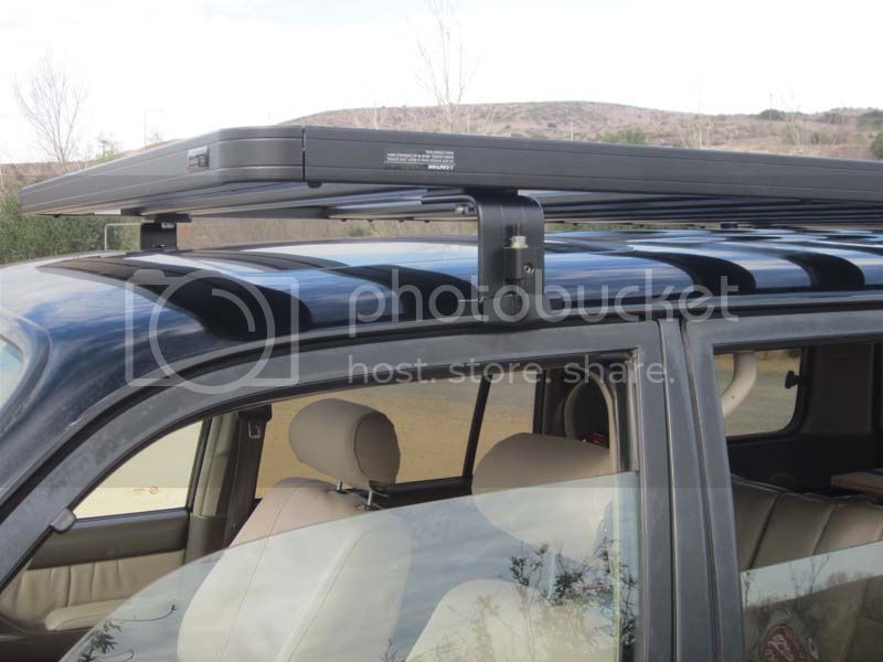

I took a slightly different approach to the Slimline 2 and got this setup through Paul at Equipt. I used 8 of the Front Runner gutter mounts and it's pretty flat all said and done. If I were to go further forward with the mounts I would need the longer legs to keep it level. The crossbars barely clear the factory roof rails. I am fairly sure these are 130mm legs but they look shorter than others pictured in this thread which makes me wonder if they are the 120's. I also need to figure something out for wind noise, it can howl pretty good with any type of crosswind.

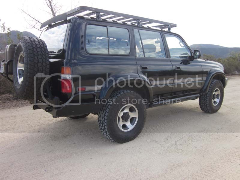

Some installed pics. Tall legs with slide-in table.

Here are some installation pics. I have the 120mm legs middle and rear and 120mm with 6mm spacers up front. Even with the spacers, the fronts are too short and the legs do not seat all the way in the gutters. I will be getting some 130mm legs for the front and using the extra pair of 120mm legs elsewhere to more evenly distribute the weight (will have to grind them down a couple mm however)

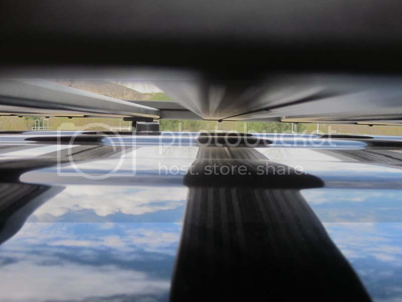

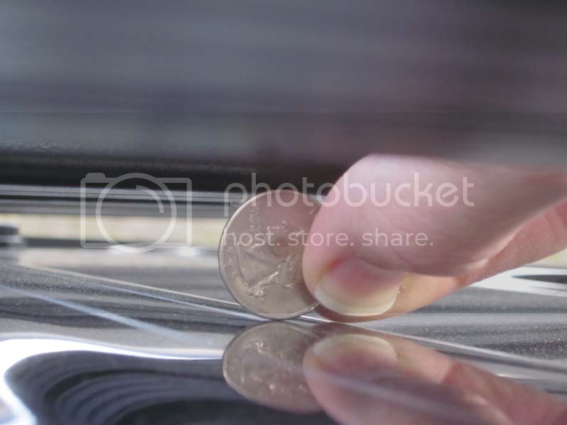

I have about 7/8" clearance at the closest point (slat to raised roof rib above the rear axle). If I put all my weight (200 lbs) in the center of this one slat it will contact the roof. Shouldn't be a problem if I stand on two slats at a time.

Well, how is the wind noise? I noticed you omitted the wind deflector...
My comment too, its gotta howl like a banshee between 50 and 65MPH.
Yes, it is loud without the air dam. I wanted to see what it was like without it for comparison purposes. At highway speeds with the sunroof and shade closed, I can hear it over the tires (tires are pretty quiet though). With the sunroof open, it's noisy from 20 mph up and you wouldn't be able to have a conversation at highway speeds. Next I'll install the air dam and see how that works. If not enough I will try to find a fairing like you (REDrum) have. Problem is I want to put a LED light bar where the fairing would go, so...
