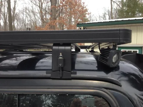

image-3907778657.webp Measured with the strips on (the runner tops slid off) and 1.25" clearance in the back, gradually tapering to the front where there is much more clearance. Nice thing about this height is the ability to add lights at the corners.
Sorry, don't mean to hijack the thread here, but 8720, where did you get the lights and how did you route the wire to them? Looks good!
lights
flood lights from China - eBay, ~$25 a piece, all 4 corners, I wanted some floods for camp lights. Rubber washers so you can turn them, wires run from my aux. power block under the passenger seat clear back and up the rear hatch support, you can see the wire in the picture coming up, then I used the channels in the rack to hide the wire.
View attachment 858450 Measured with the strips on (the runner tops slid off) and 1.25" clearance in the back, gradually tapering to the front where there is much more clearance. Nice thing about this height is the ability to add lights at the corners.
