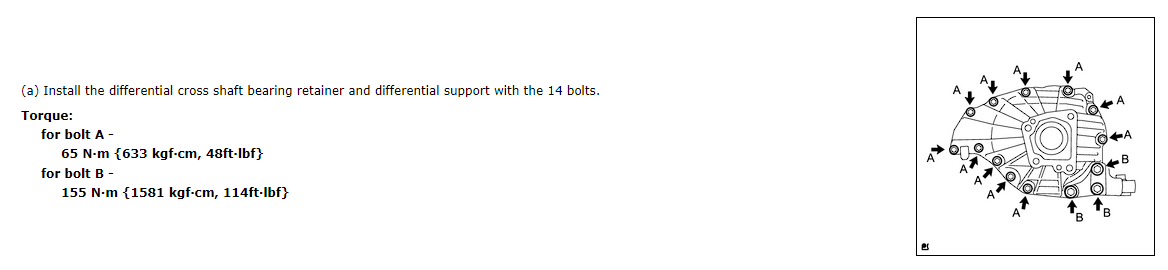

What is the proper torque spec ? Please advice

155Nm/114ft-lbf for the three bolts through the mount into the diff.

Torque specs vary. I think those 3 bolts are the ones which should be 114 ft lbs, vs 48 ft lbs for the other 11 bolts. I suspect when your diff was reassembled all the bolts were torqued to 48 ft lbs. Grab a torque wrench, set it to 114 ft lbs, and tighten these. If they were not tightened correctly it'll be immediately obvious when they rotate like a full turn. If they are correct you'll know right away.
If you don't have a torque wrench or can't get good leverage, ask a local shop to put it on a lift and do it. Should be about 5 minutes of work to check/tighten them.
It has never been pulled apart only work done was right side drive axle seal. But I will check the torque thank you very much for your advice really appreciated.

I just checked the torque it's tight to spec. I pull them out one at a time put some red red loctite 510 and torque it back up to 115NM . The bolts are very slightly bent I believe it's under so much stress. And you are 100 percent right at some stage the diff has to be split open to reseal it I see some other bolts which comes through the clamp shell is very slightly wet. Maybe I am a unlucky owner or it is a common problem yet to be discovered by other owners.
