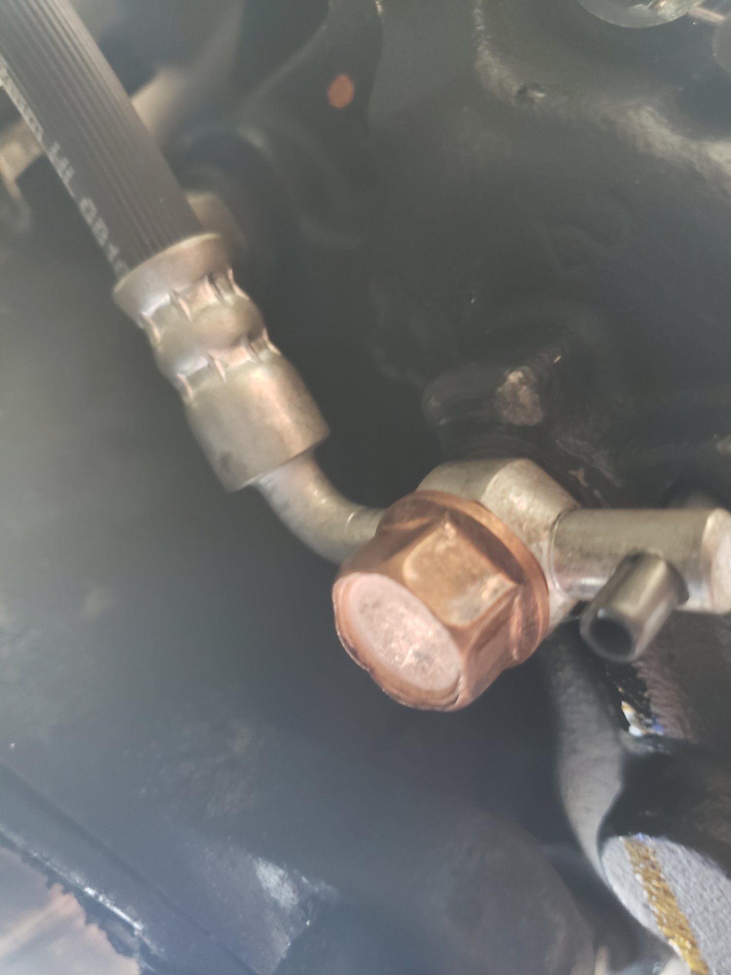

Ok...fluid leaking out of HP fitting. Is 22 ft lbs correct? I did install new copper washers, but had to remove and reinstall...does this mean I need to install new ones again?

YES!!! All compression fittings washers or olives are one time use only!
ive found that sometimes the replacement crush washers with aftermarket washers are too hard to seal and generally suck, there pretty much flat washers with a skim of copper on them. id stick to the factory crush washers as they are softer and seal better.
All OEM lines, crush washers and banjo bolt. 22 ft lbs just didn't hold on either side. Upped to 30 ft# and seems good there.
