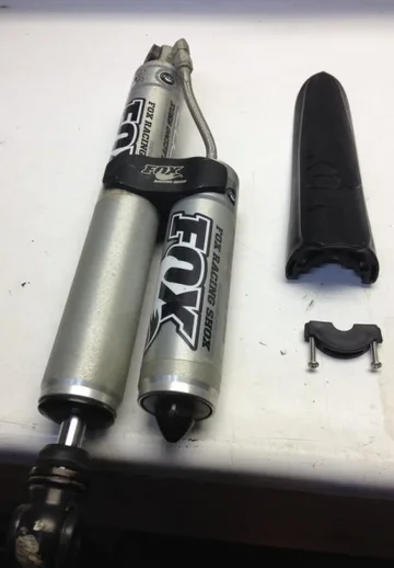

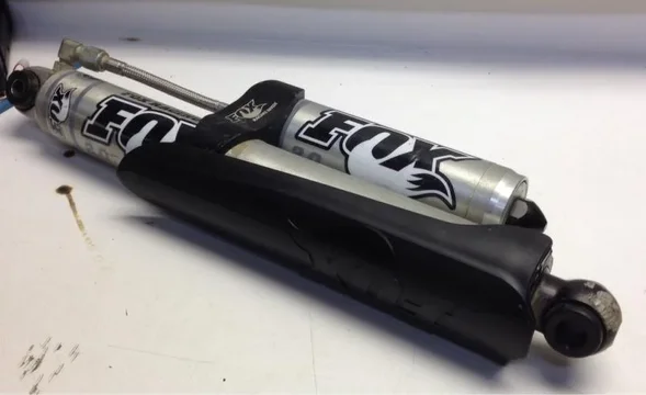

Got my hands on a set of pre-production shaft guards for my Fox shocks. Kind of like shin guards for the exposed shaft. Hi impact plastic, 11 inches long. Looks like they'll work on the fronts as well.
I really like those guards. I'm not a fan of the shock boots, they trap a LOT of garbage in them. I ran them for one trip and they packed themselves full of junk.

Rb4638 Which version fox shocks are those? I know they were working a a res version, but thought those were going to be out next year.
The shocks in the pic on the work bench are from a Jeep. Just used to show detail of the guards. I have non res 2.0 shocks on mine. You can be sure that when Fox comes out with the 2.5 with res and compression dampening knob I will be getting a set.

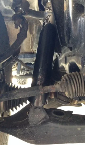

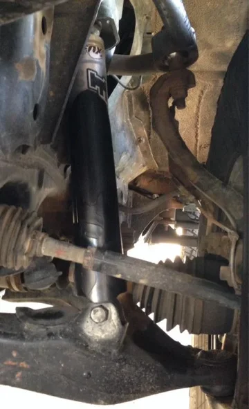

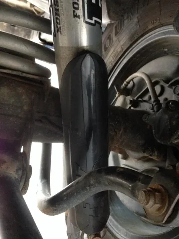

Here's a few pics of the guards mounted on the front shocks. Seems like they'll provide protection without the drawbacks of a rubber boot zip tied around the shock body. These should be available from Fox by January.
