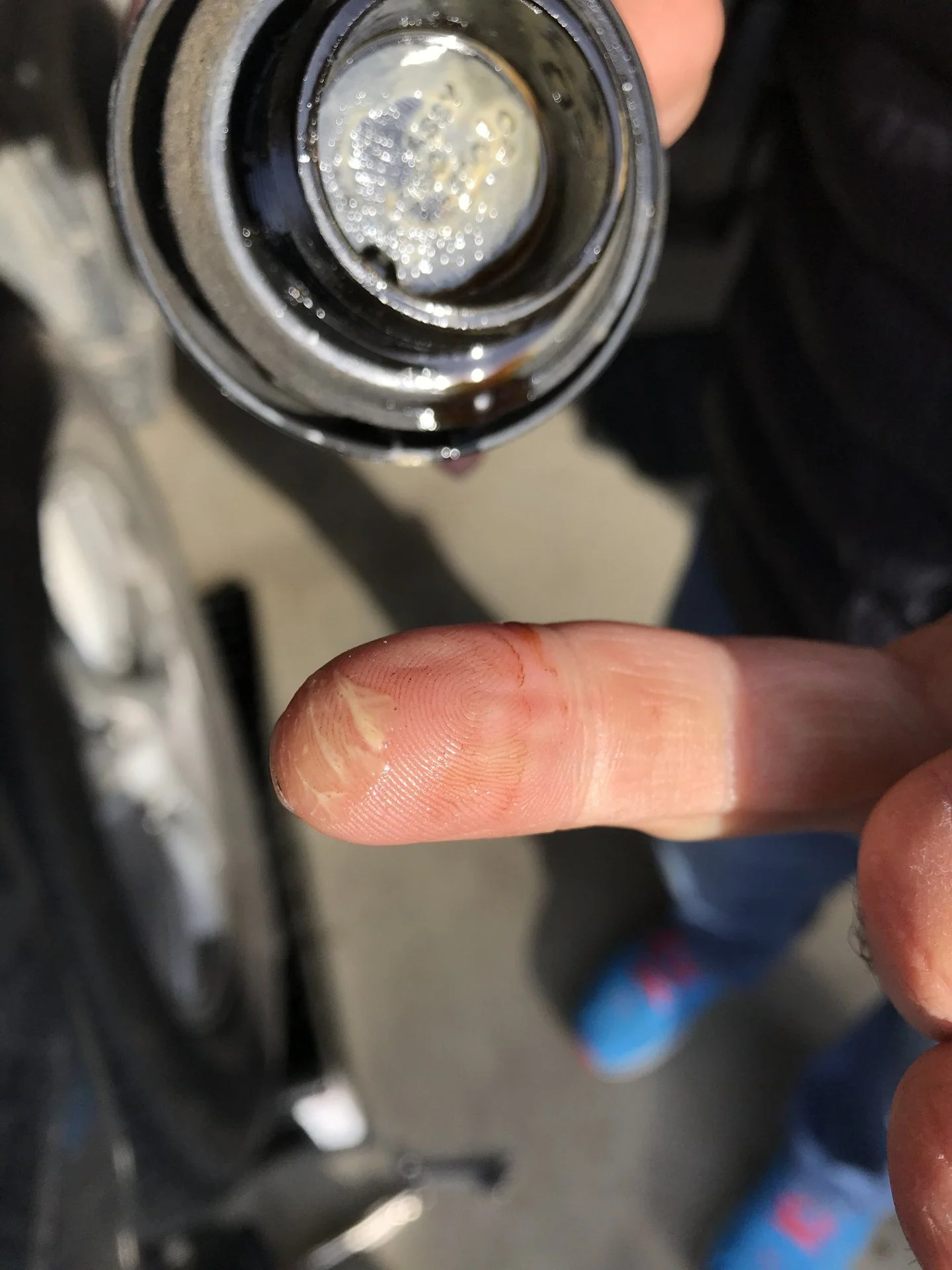

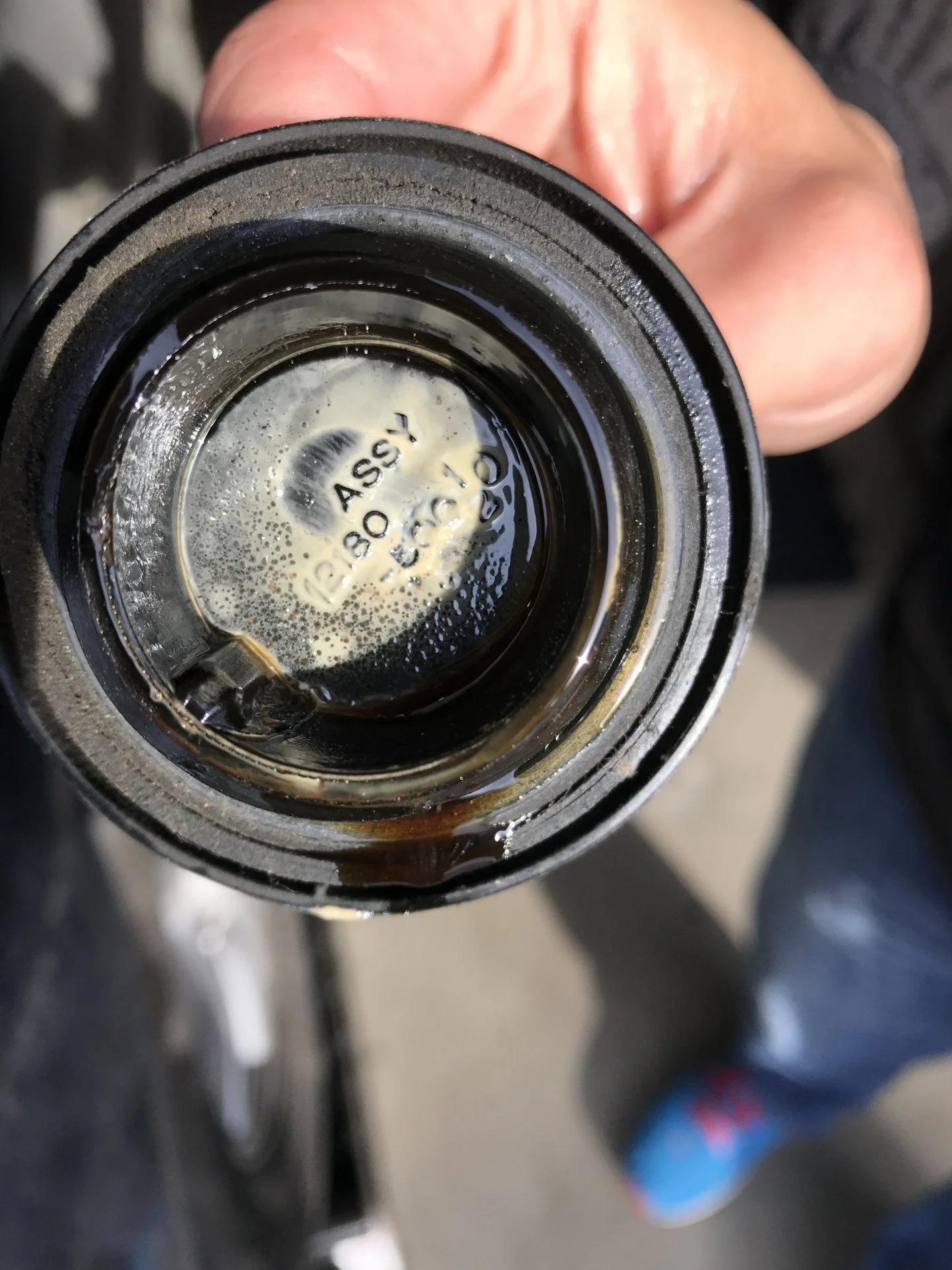

while changing my engine oil, I took a look at the engine oil cap and found a small amount of white sludge/cream build up under the cap.
Also after changing the oil I kept checking the oil from the dip stick and feel like I could see streaks of that white sludge on the dip stick. Please look at the pics.
No leaks so can anyone tell me what this is and if it’s serious
Kinda hard to say. Dont want to jump to conclusions. Do you drive this truck daily? Do it get up to temp every day? Could just be condensation. Keep checking every day. Unless you had overheated it at some point before then we probably know the answer. What's the miles?

Drive everyday. 30 miles probably. Gets up to proper temp no problems. I’m 2nd owner but as far as I know never had any overheating issues.
Currently has 138,000 miles on it. 2004 lx

I've had that before ( under the cap ) and it was condensation.
Not sure about streaks on dipstick, that sounds more concerning to me.....
You could do an oil test with blackstone if you're really concerned or your local auto parts place probably sells an inexpensive block tester kit which checks for gases in the coolant.... good luck

Not losing any. The streak on the dip stick are now gone. They only showed up when I added the new oil and then was checking to see oil level.
Also I’ve been checking my dip stick 5 times a week almost and can say with confidence that I’d never seen any streaks before.
Check your PCV valve. Most likely, it's jammed up, and the crankcase is not venting right. The moisture in the engine that gets blown out the PCV will mix with the oil under the cap like that if it has no other path to get out.
Likely just condensation. Typical in cooler and cold temps we see this time of year. Check under the oil cap after a long highway drive, I am guessing it will be gone. Short trips often don't allow enough time to rid the system of all condensation.

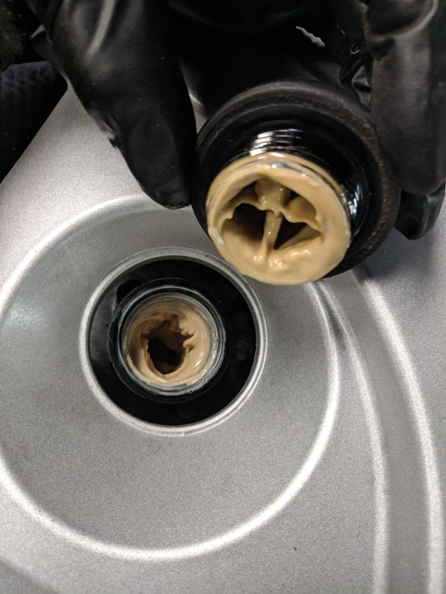

It's NOT condensation, and it's NOT normal.
Had this scare with the 5.7L in my 2011 200-series, at about 110K, about a year ago. Sludge just like that on my cap. I was freaking out. Several people told me it was condensation, took it on some longer trips, got worse.
Took a chance, swapped the PCV valve, which was probably the original one, it was totally clogged. It was SUPER easy, took only a few minutes, $10 part. Problem totally went away. Gone.
Before:
After new PCV, couple hundred miles later:

Sounds like from @gatormark91 that the PCV in the 4.7L is very different than the later 5.7L. The later one screws in, is right dead center in the front of the engine in front of the intake plenum, under a thick hose. Uses a 22m deep socket (O2 sensor socket works well). I had the epiphany idea on a Friday night, and none of the dealers near me had one in stock, so I just bought one from NAPA. Looked and felt exactly like the OEM one. Honestly, you could probably just hose it out with brake cleaner, it's a simple thing, just listen for the little jiggler that should rattle when you shake it, mine was stuck solid.

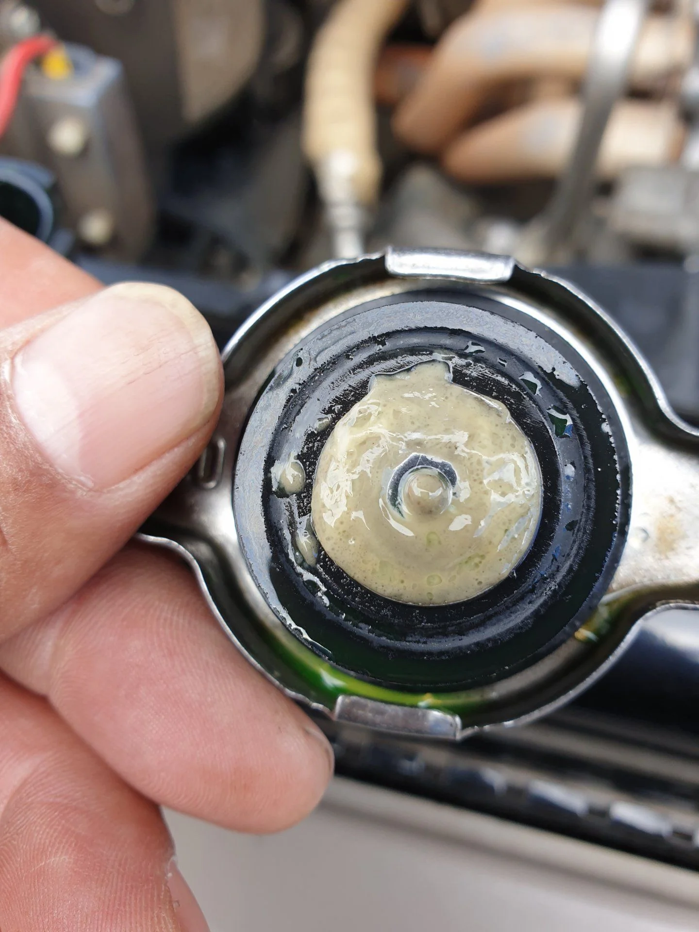

I've had blown HG r
I've just replaced a cracked cylinder head just two months ago on my 80's series 1fzfe(93) and found today a creamy colour sludge on radiator cap could this be a PCV valve problem!!! or am I reliving the same nightmare..will be taking it back to mechanic after Easter holidays break. Down under (AU) check the pic below..cheers
