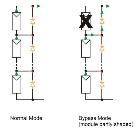

I would add a schottky (low thereshold voltage) diode to the broken solar cell (bypass diode).
If that particular cell fails (loose cell, not the whole panel), you will still have some output.
This picture illustrates the fix:
Be aware that a bypass diode can limit the output of your solar panel.
Some more information on bypass diodes can be found here:
