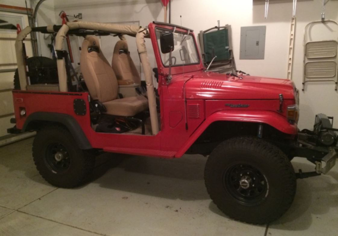

For a convertible, I drive my FJ40

@Romer - exactly my plans to meet the air in the face desires....... it'll be my 5th 40, but the first time I ever really had funds to make it civil instead of just transportation.....
