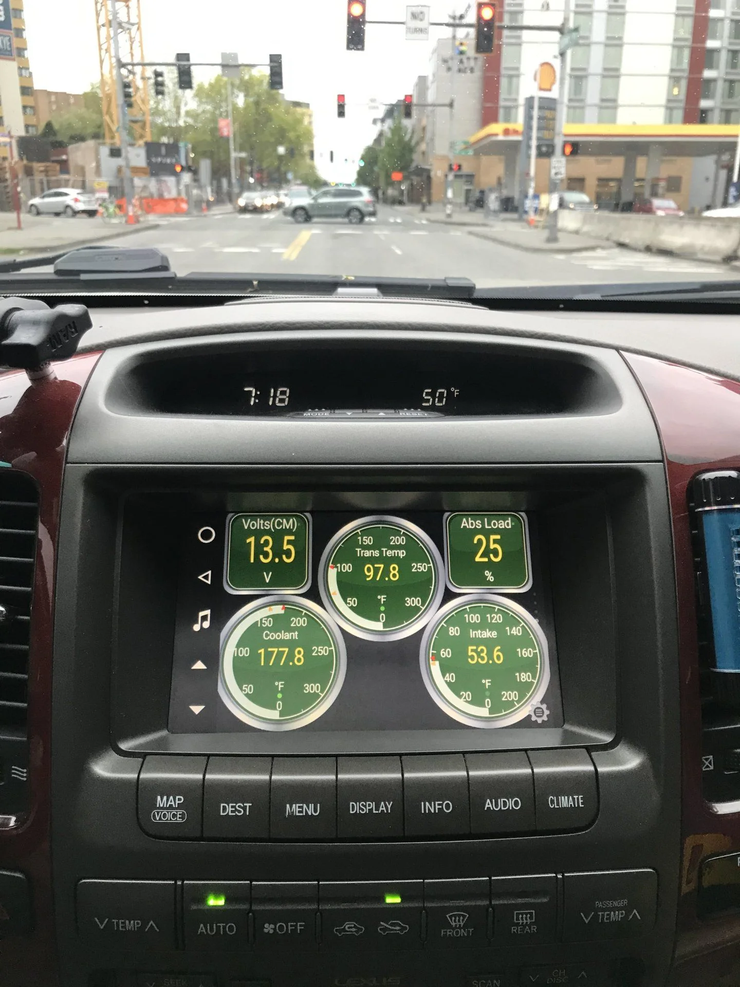

I took out “abs load” and put “gps altitude” in its place and bottom center I have “gps speed” because it’s more accurate than my speedo with the bigger tires.
What product are you using to display your phone on the stock nav?
A lot run the grom unit or car play
That would be awesome. I'm currently running it on my phone and I've been playing around with the overall layout.
Main screen shows AFR, Lambda and MAF so I can basically know if there's something wrong with my fuel pump (common problem down here). Trans and Water temp, engine load and TPS and voltage.
