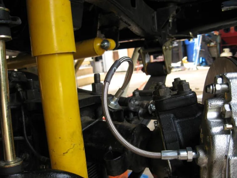

Sounds the same as the 60. Can only see the hose in the pic below, but I ditched the short hard line and bracket on my 60. Re-plumbed straight from the housing tab to the caliper with covered braided SS hose.
This pic might make it clear. Its a common mod to make. No special notching or rivet replacement involved its no more than a line replacement.
There is no difference in a 60 to 62 at the knuckle. I own one of each and have an extra 60 front axle in the yard as well.
Don't bother with changing the rivet to a bolt. Just source a single stainless brake line that goes from the axle bracket direct to the caliper. Available from numerous vendors, just happened to get mine from sor.com.
No backing plate as I installed an eliminator kit from specter which includes the brake lines by the way. Lines can also be purchased seperately.
