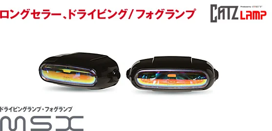

These HID's are just about 2" in height
Slim ones from CATZ

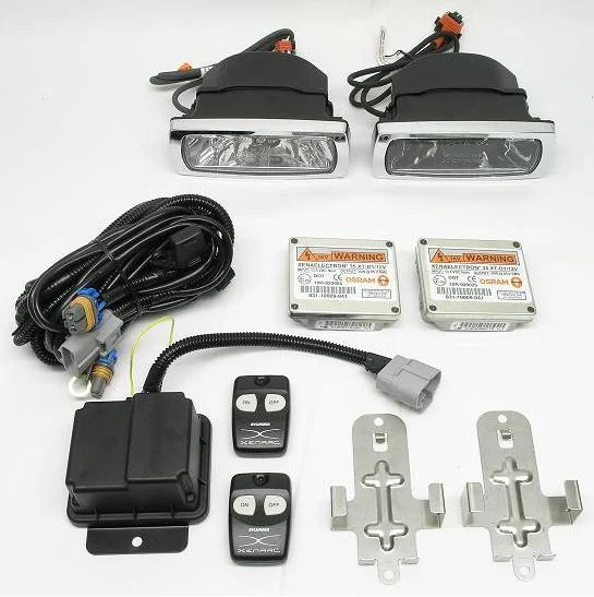

Or I would take a look at the Sylvania Xenarc's (SUVlights site)
Supposedly you can remove the shield and make them into driving lights, too.
I've tried them little bit (w/o removing the shades) and they were pretty decent. Got pretty warm when on.
Installation is relatively easy since they use wireless remote (Mine came with two).
I would go with the Xenarc's since even at $350US that is a relative bargain. However if I wanted driving lights in the first place I would mount a pair of big-ass lights on the bumper. :D
Pic 1: IPF
Pic 2: CATZ
Pic 3: Sylvania
