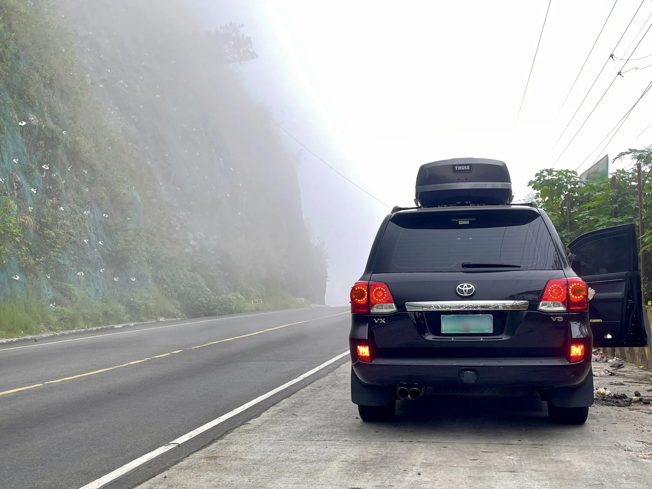

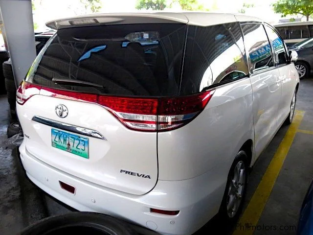

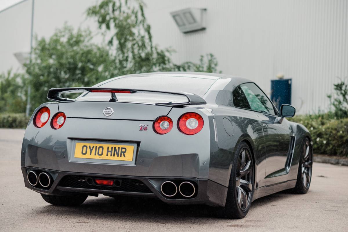

I suspect fog lights integrated into the standard lighting eventually ran afoul of tighter regulations. While a all-in-one solution looks cleaner in terms of style and would be likely cheaper to manufacture, when overtaking such a vehicle in the fog it will not give you the depth perception that a separate lamp mounted apart from the tail lighting will.
i agree here too ,
wouldn't a driver have there full head lamps ON Foggy driving conditions in general ?
so , hence the rear RED running lights would be On as well , so how would a additional 194 peanut bulb ( 40 series speaking ) or a #67 / #89 Gum-Ball bayonet twist-lock ( same socket as a #1156 ) make any additional difference ?
would the 4th additional rear fog bulb sharing the Tail / Brake Red Lenses chamber be ON by it self ever ? , so far the ( 40 Series answer is YES ) , but i do not know how that occurs / what device turns it on when the headlamp pull switch is in the OFF / fully pushed in position ?

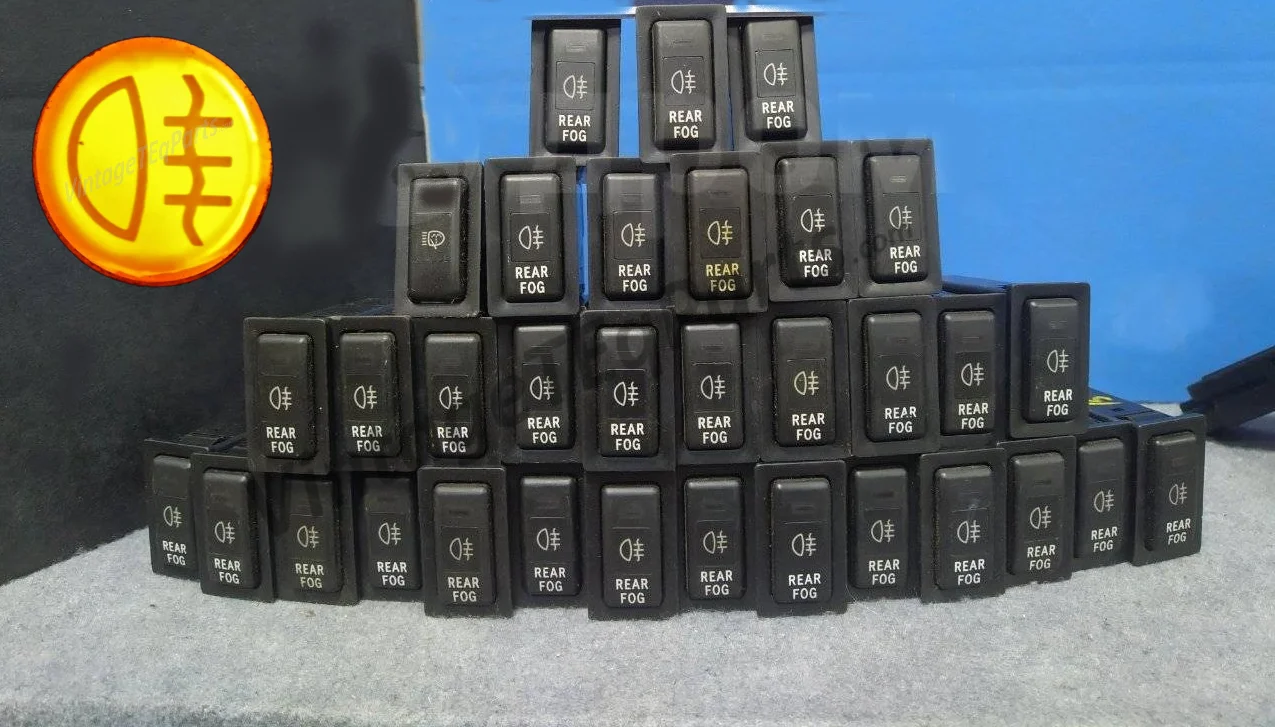

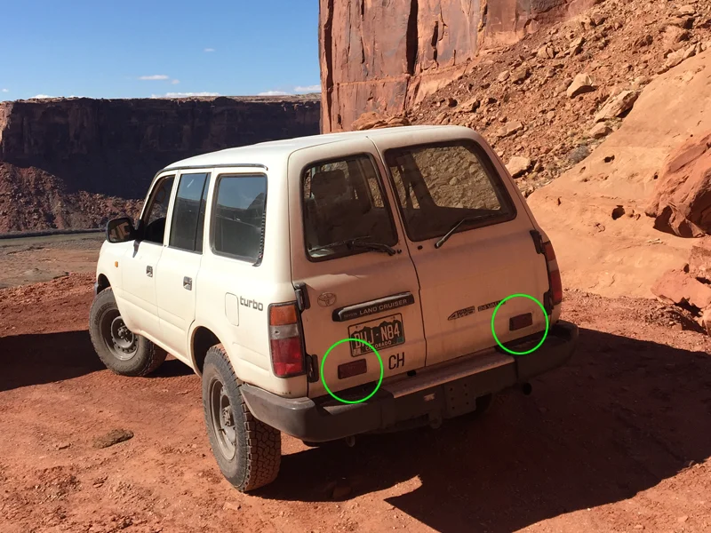

the above HJ60 Finland Spec. does have a stand alone Rear Fog push button ON = push-lock-in / OFF = push-un-lock-out ....

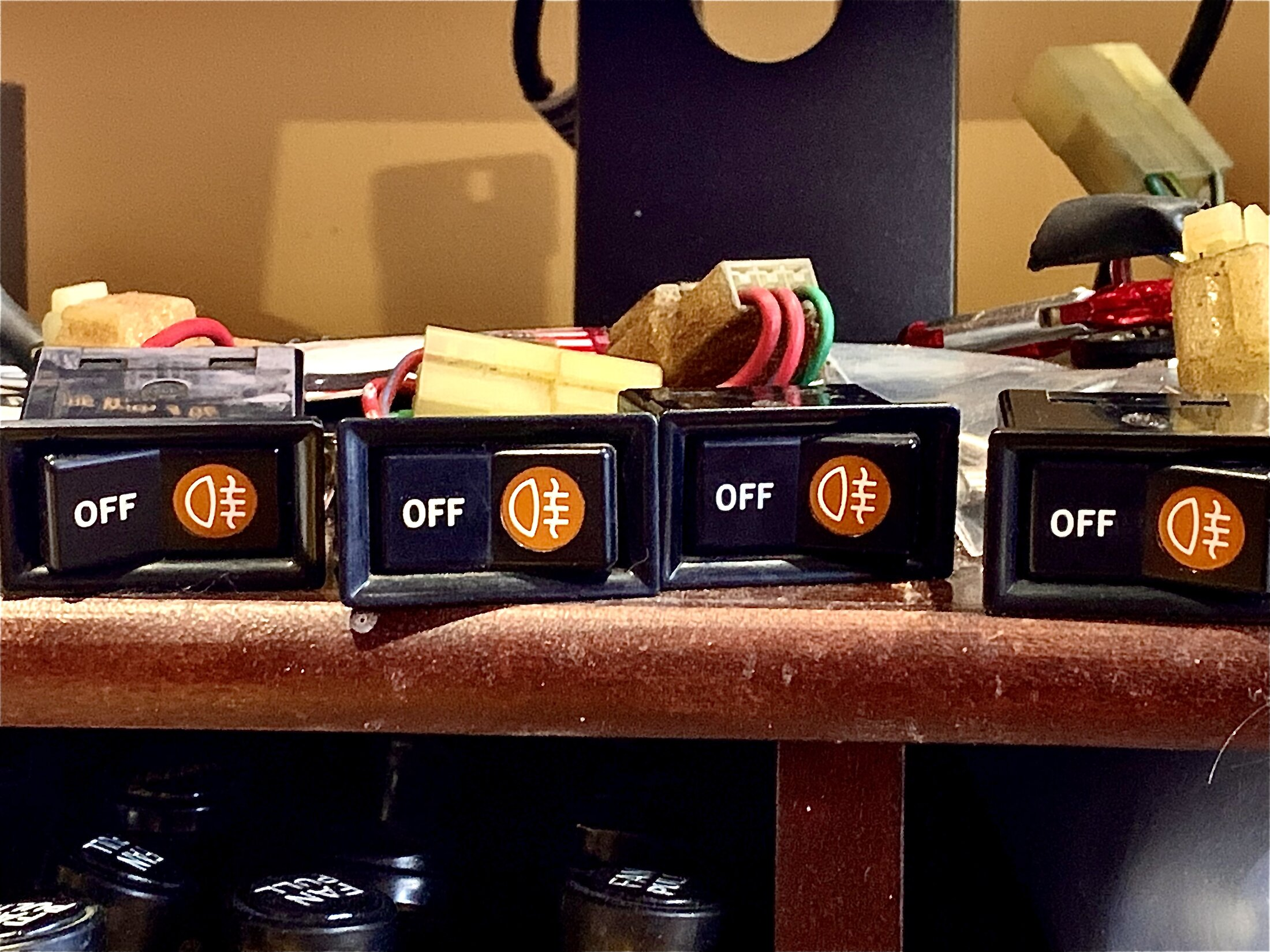

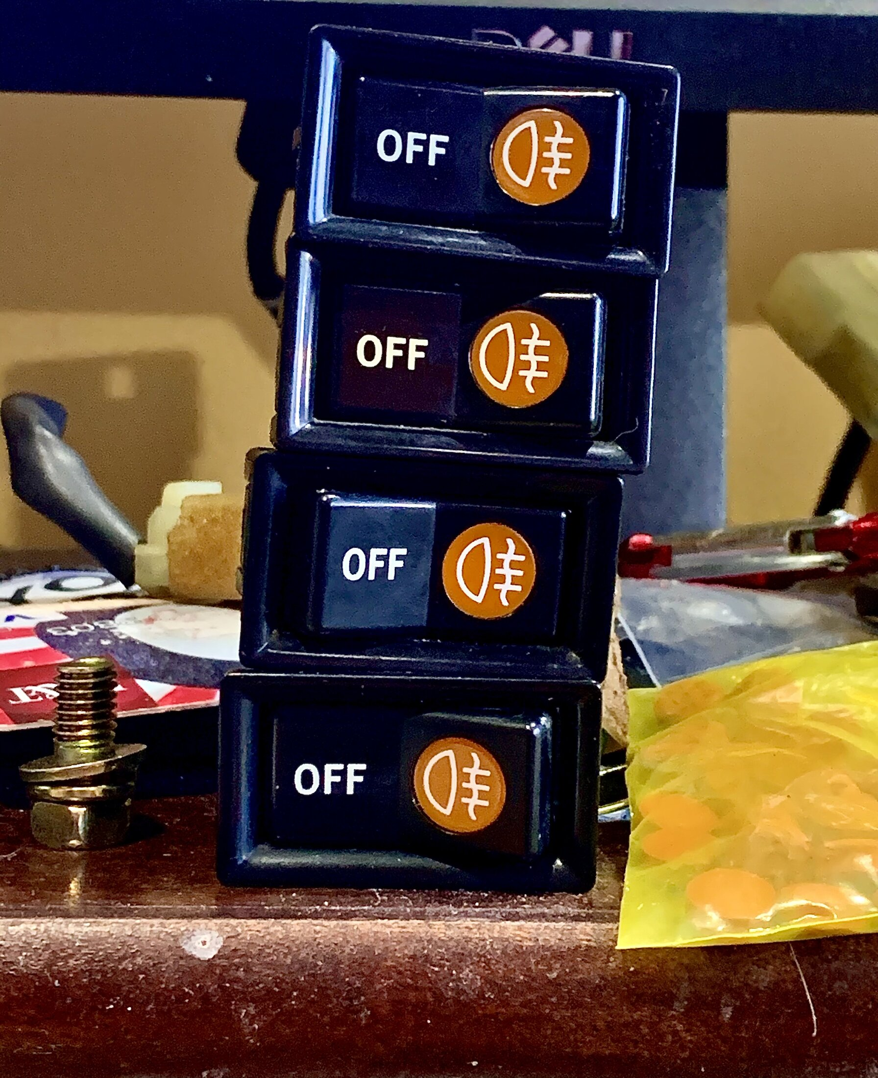

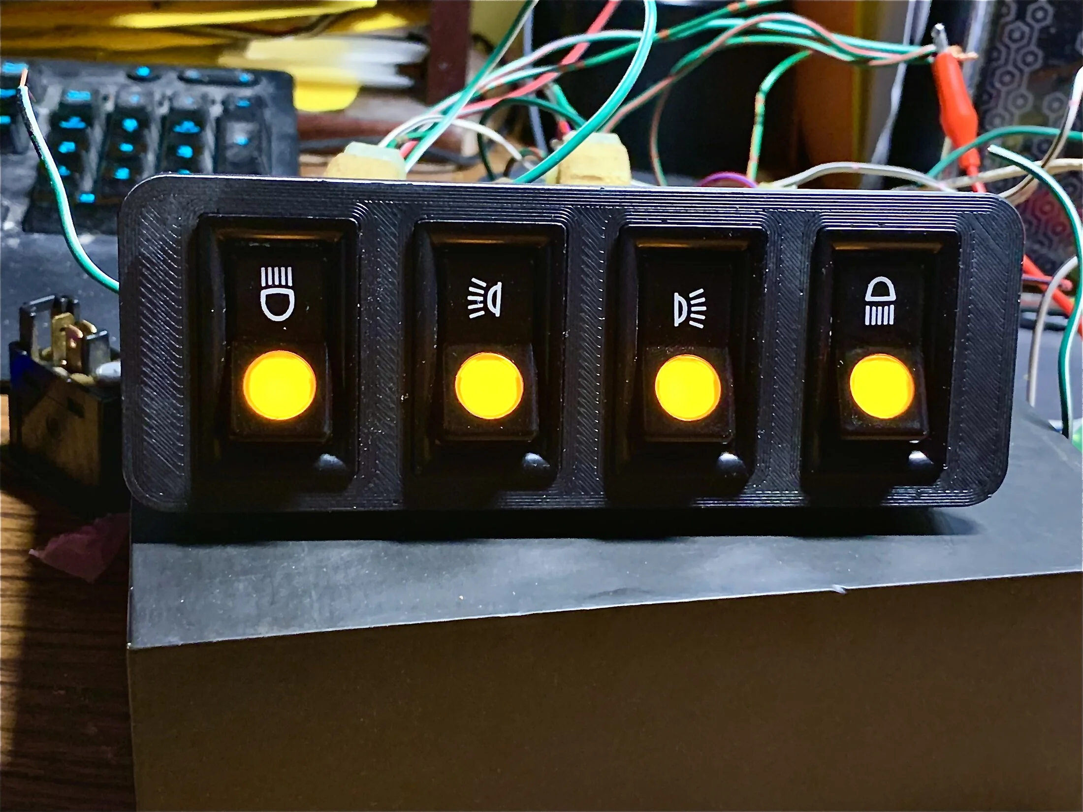

the VX 80 series above has a Horizonal rear fog icon switch also stand alone too ....
now those stand alone red lens lamps look pretty functional for a Foggy windy road if some prissy Range Rover comes barreling down the Moore switch backs up on his tail ...........
