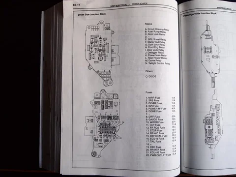

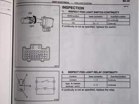

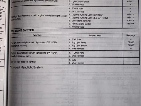

Here some pic from 2001 FSM, hope it helps.

Thanks for the FSM pictures 2001LC. The switch is what I believe it to be. I think I'll pull it and check.

Went out and pulled the switch. If the 98 switch is the same as 2001 and cross reference through CARQUEST says it is... Continuity test shows pins 10 & 11 open with fog light switch on. Which means the switch is bad. I'll try to get a switch & check it out...

Well I'm confused you tested and reported SW was bad. I assume you double check in this order: 1) bulb, 2) fuse, 3) relay, 4) SW, 5) wire harness.
I'm wondering if switch needs to be set with low beam on and high beam off for the test of fog light SW continuity.
