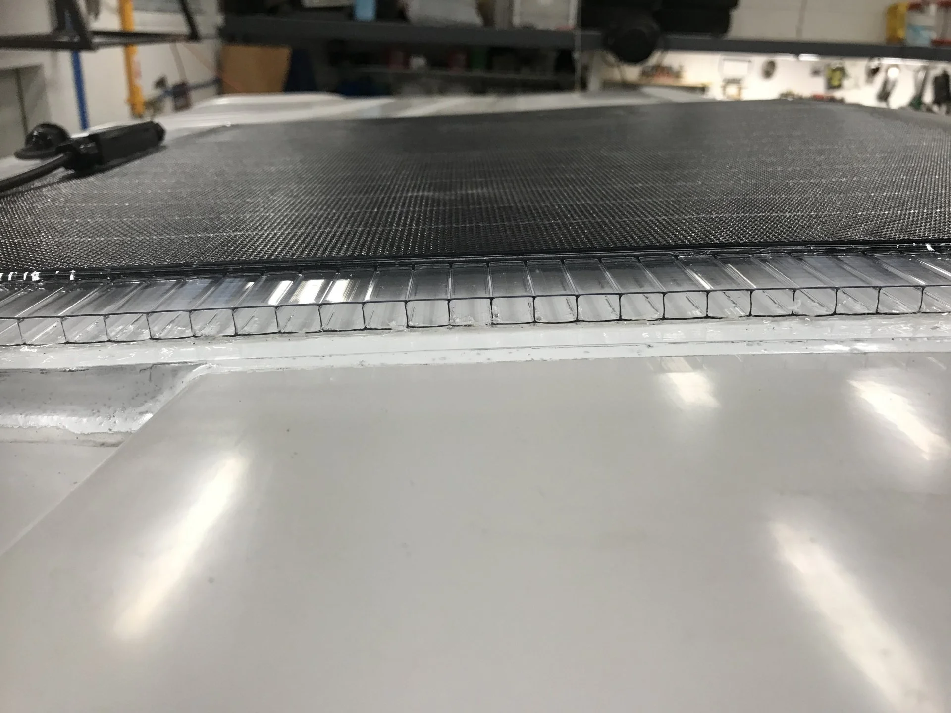

I attached a 100 w flexibale panel directly to my RTT and it failed after two years.
The performanace of flat panels are very negativley affected by heat.
Last winter I removed the old panel and reinstalled a new panel, with better heat resistance, onto twinwall corrugated acyclic panel, with 3/8th by 3/8th ribbing for cooling. The new panel says it is more heat stable than the early generation ones.
The new panel works well.
Lessons to learn:.
  • Do not used 3M mounting tape, its permanent and it took me 5 hours to remove.
  • Use only Gorilla mounting tape, it’s still very strong, but is easier to remove.
  • Mount the thin solat panel on a cooling substrate (acyclic panel) for airflow as in a solid panel in a roofrack.
Copy that, 2 issues arose. 1st. when traveling 80mph on freeway the panel tends to flap if not glued, tore corner eylets out, if mounting at corners with hardware some sort of adhesive needs to be in center to keep from flapping at speed. Heat - at Rubicon in full sun the panel would shut down by 10:00 am, had to park in shade to get system back online, there is definitely a heat threshold that shuts it down. Mine is mounted on aluminum roof skin with an air gap, clearly not enough, need to remount with better air gap substrate. How will that acrylic deal with the UV ? I am looking at various air gap material, find it hard to believe that the panel manufacturers don't have air gap set ups available, they are losing a good income source and detracting from their panels performance by not providing an optimum air gap mounting platform.
