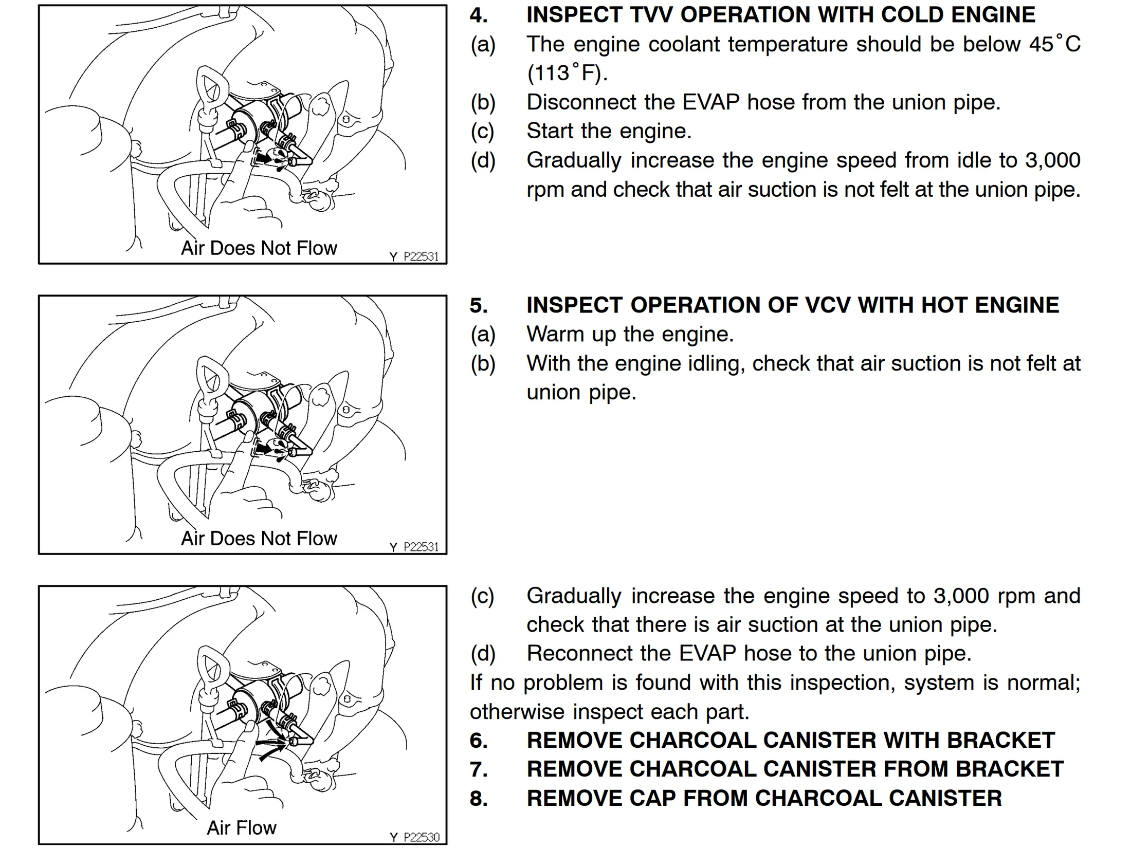

I read the FSM and understood that in normal operation the gas vapor should be let into the engine by the EVAP system. In the FSM there is a simple test (see picture below): at normal engine temperature and RPM of 3000 there should be vacuum (suction) in the line between the VCV and the Charcoal canister. There was no suction at all.
The way I see it it can be defected VCV or TVV or maybe EVAP VSV. Is that right or I am missing anything?

Did you run the test described in the picture?
I run some more test and found that the problem is with the VCV. It could not hold vacuum. The TVV is fine.

As described earlier, I had perform the test described above (in the FSM) that indicate a problem in VCV or TVV ( BTW 1997 FJZ80 does not have EVAP VSV like 1996 or 1995).
The FSM suggest to remove VCV and TVV and test them off line. I did not want to remove them so I checked them installed.

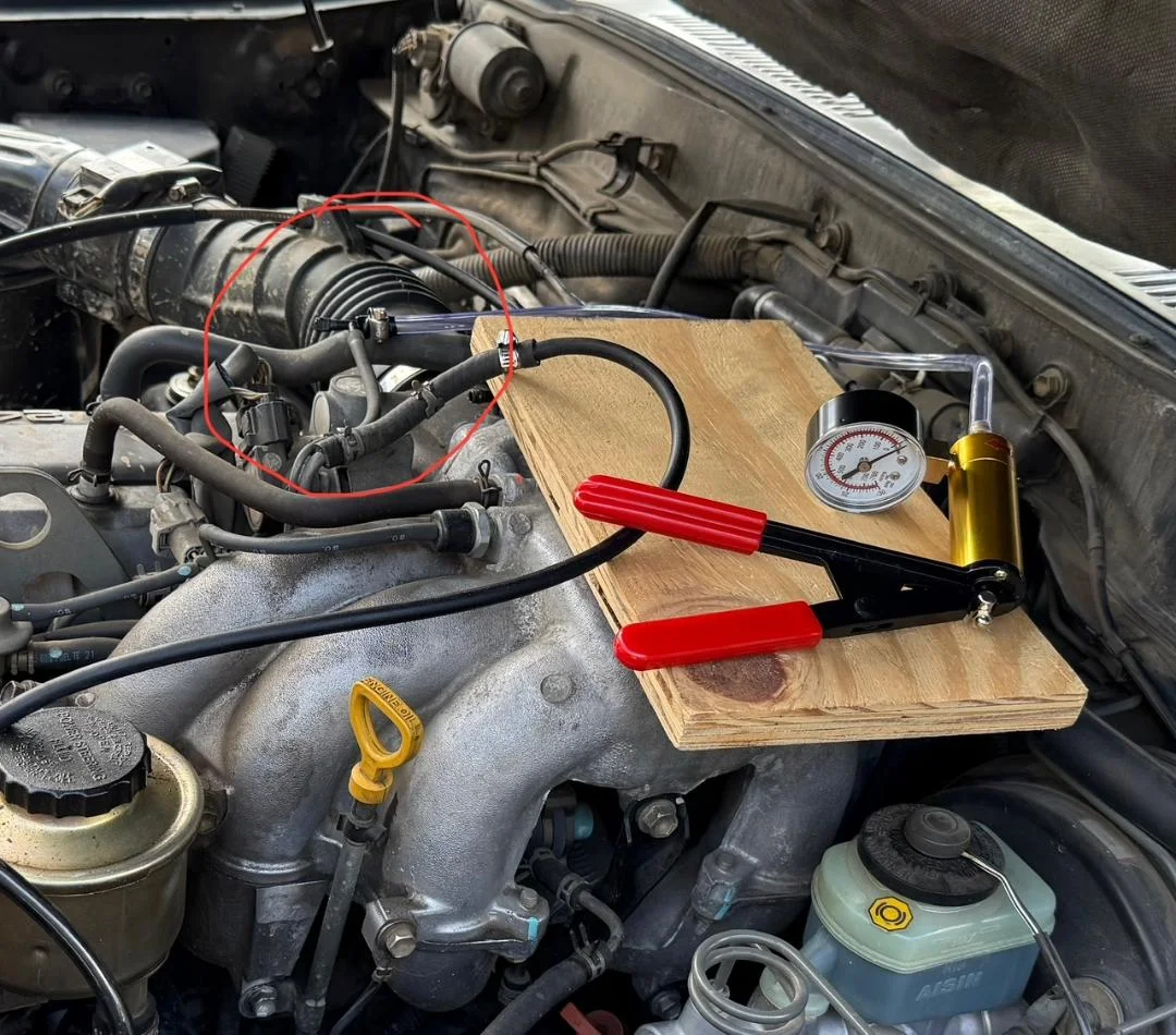

I used manual vacuum pump to generate small vacuum (to generate >70 mmHg) - manual pump that used the bleed brakes fluid. I started with cold engine and engine turn off. Open the gas tank first to eliminate any pressure if exist, and close it again.
I connected the vacuum pump to the line connected to the TVV - see picture below
I pump using the vacuum pump to about 100 mmHg and was able to generate vacuum.

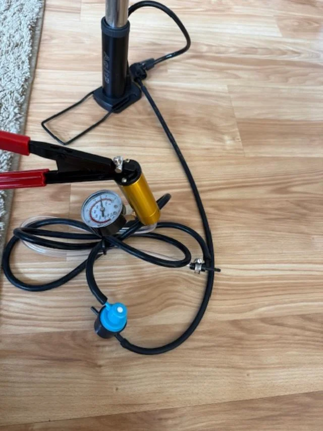

I used bike pump and connected it the the line going to the VCV - see below
If the system works well I should be able to flow air in the system from the bike pump to the line back to the canister when the engine hot but not when the engine is cold (in both cases the engine is turned off).
When the engine was cold I was not able to flow air (which is expected) but was able to generate vacuum in the TVV (which is good).
I concerted the disconnected lines back and heat up the engine to working temperature. Turn off the engine and open and close the gas tank cap again (to eliminate any pressure in the system)
Then, I connected the above setup. This time I was not able to generate vacuum with the vacuum pump. This means that the TVV function well but the lines to the VCV or VCV itself can not hold vacuum.

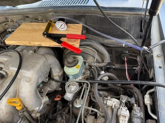

Now I waited till the engine is cold again and connected the vacuum pump directly to the VCV
To get access you will need to remove the INTAKE MANIFOLD STAY (I suggest to remove the top bolt but just release the bottom bolt ( it is a little pain to put it back again). Once released you can move the stay away from the VCV

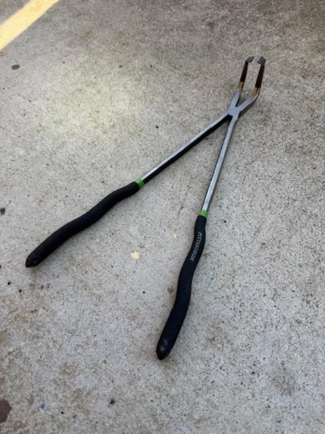

The access to the pipe from the VCV to the TVV is not great so in order to disconnect the vacuum line attached to the VCV, I used a long right angle plier and put some plastic on it to protect the hose (see below) to pull it off.
The VCV could not hold the vacuum. Which means that it is defected.
