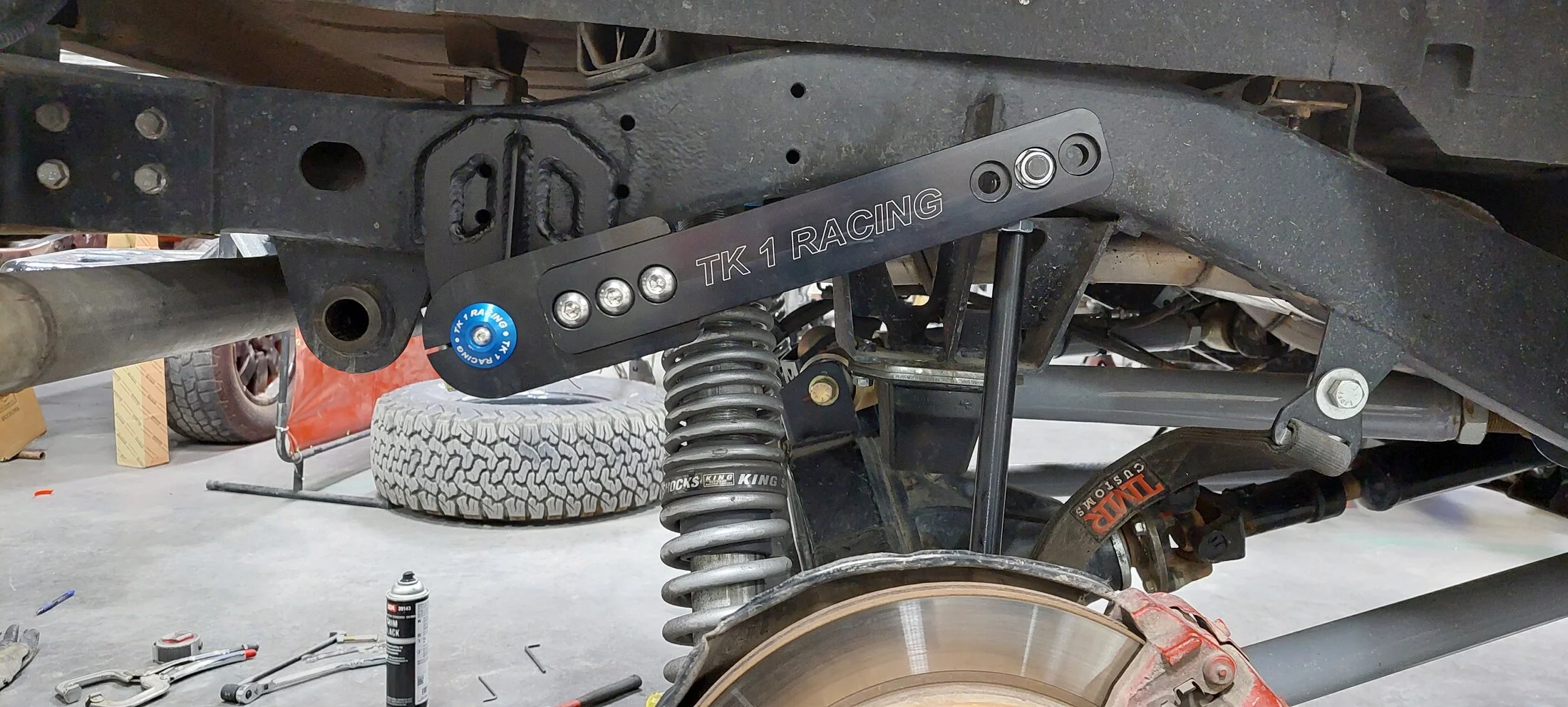

You want a bar that is compliant enough at low speeds to flex well, but holds the suspension enough at speed to limit body roll. I am running a soft TK1 Ultra4 bar in my rear, and a 1" rockjock up front. I much prefer the TK1 for the adjustability with heat treats, along with different lengths, and it's a much nicer arm as well for the same cost. I wish I had a bit more space to play with up front as I would be running a TK1 bar, but I don't have the space.
Sway bars are a relatively simple concept; they resist torsional motion. Body roll essentially is a somewhat torsional movement around the roll axis (as far as I remember) of your suspension. By adding a sway bar, you limit the rotation of the body and suspension by adding a known limiter, IE., the sway bar. How much it limits or resists the torsional motion depends on the material, diameter, and heat treat, along with the amount of torque applied to the bar. You can adjust the amount of torque applied to the bay by adjusting the length of the arm of the bar. The longer the bar, the more torque can be applied by the axle. Based on weight, you need to find the correct diameter and length of arm. For me, it was the 1 1/8 TK1 bar and (I believe) a 14" arm with a soft heat treat to allow for the amount of travel I have. Too much bar and it won't flex enough, and too little will not help, but both can be supplemented by changing the length of the arm to make it more or less compliant.
If you were closer, I'd be happy to let you drive the cruiser to see how it behaves with and without bars, and you are more than welcome to do it at SAS.
If you go with a TK1 bar, I would also do aluminum end links. Usually, you want to have the arms sitting somewhat parallel. I don't remember what your travel is, but you don't want to angle down too much with doop, or it binds.
Here is how my rear is sitting with 12" of travel, about 4 up and 8 down.

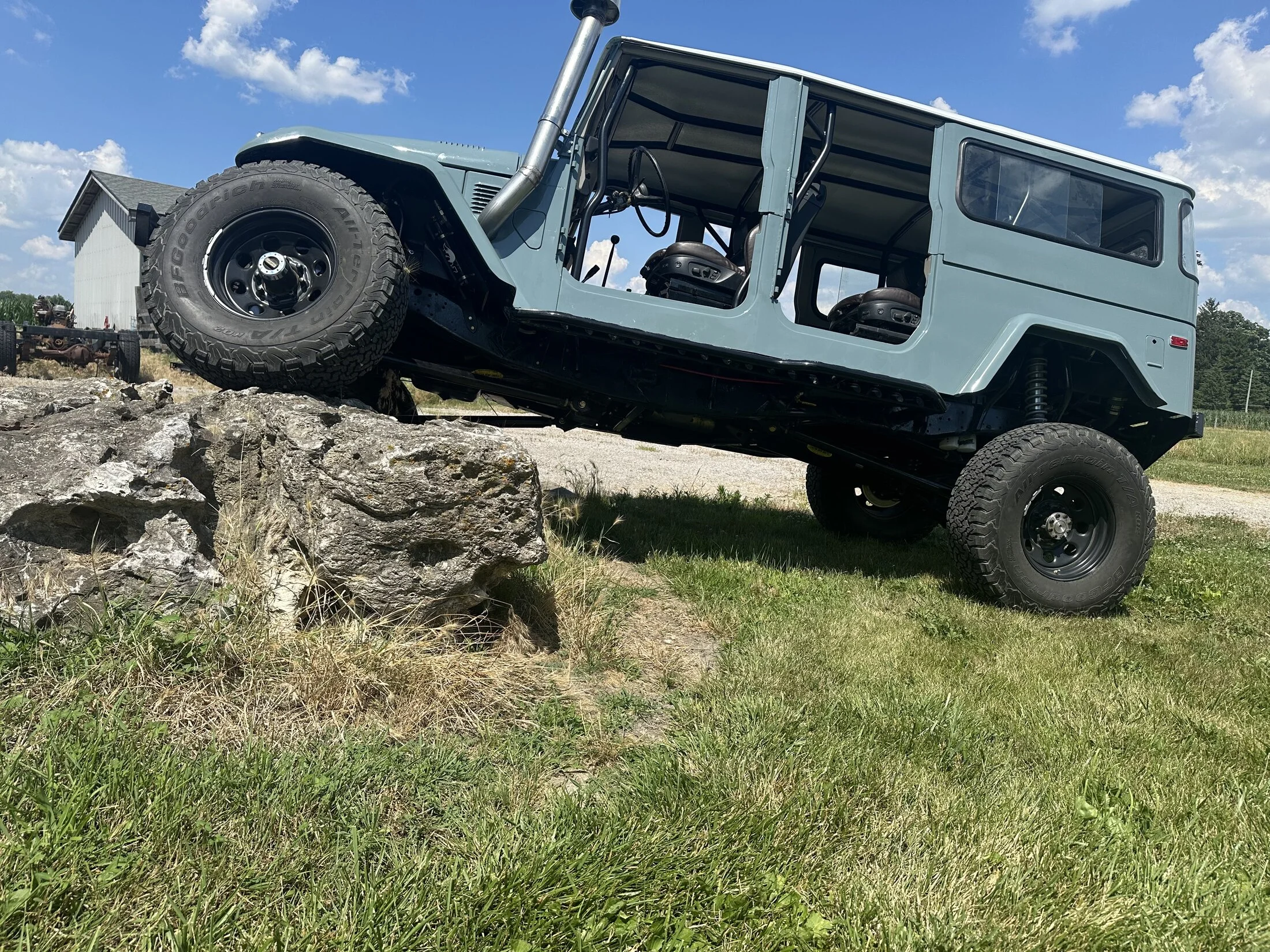

Had this rock next to my barn, wasn't sure if it would go up it but it didn't even notice it.

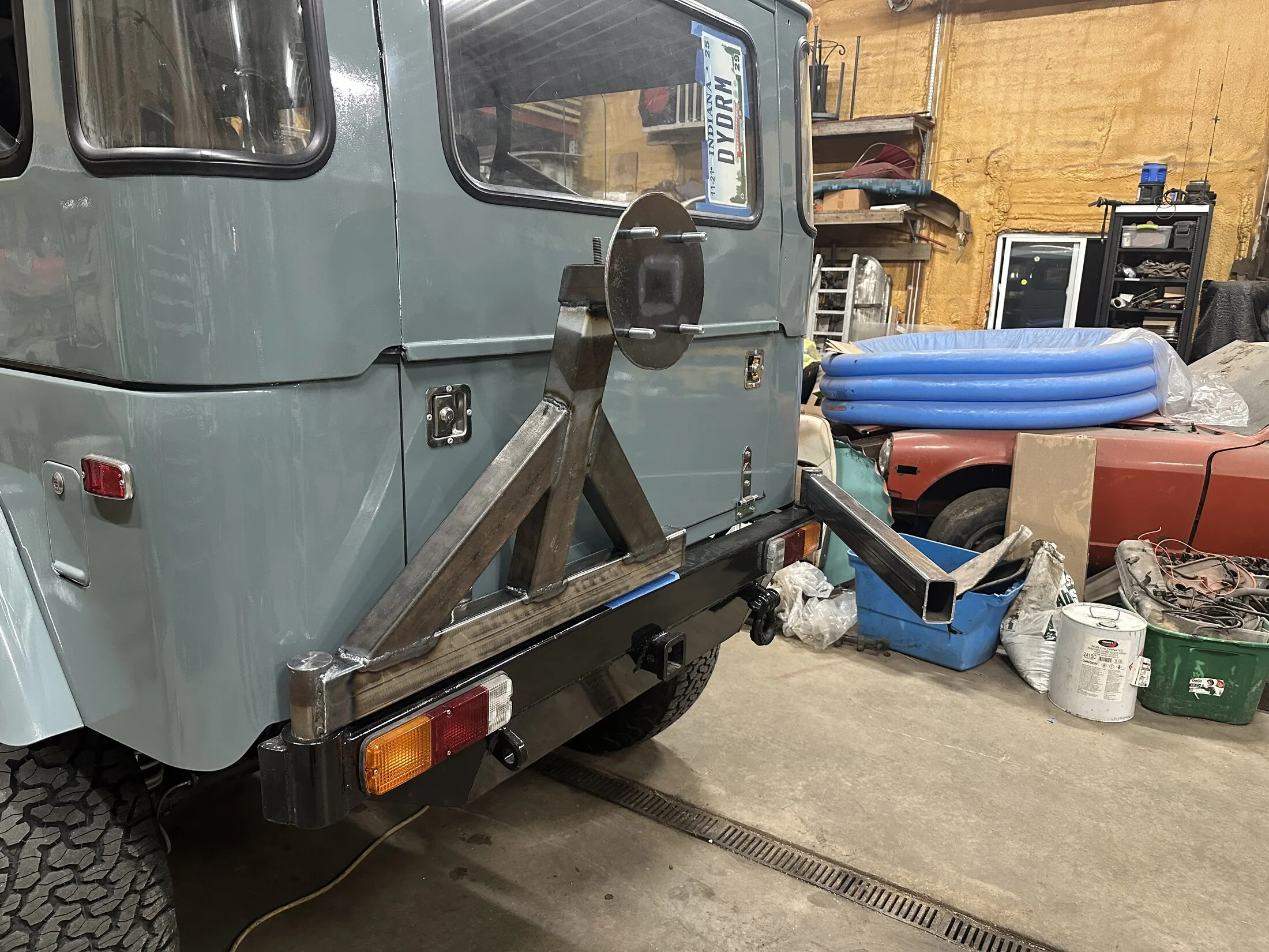

Lifted the rear, checked preload and found out somehow I had left negative preload. Reached ride height with only 1 1/4” of preload. 5 1/4 chrome showing on a 14” coilover with me on the back, which is way more than the spare tire carrier which took forever to tig but it turned out.
