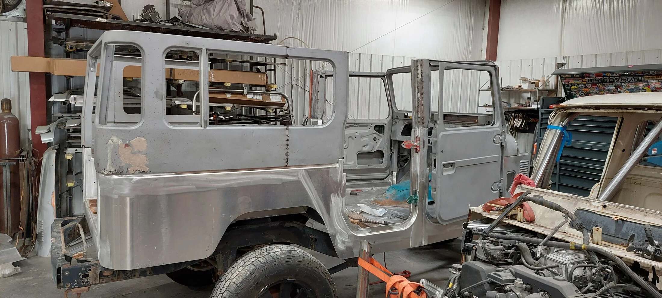

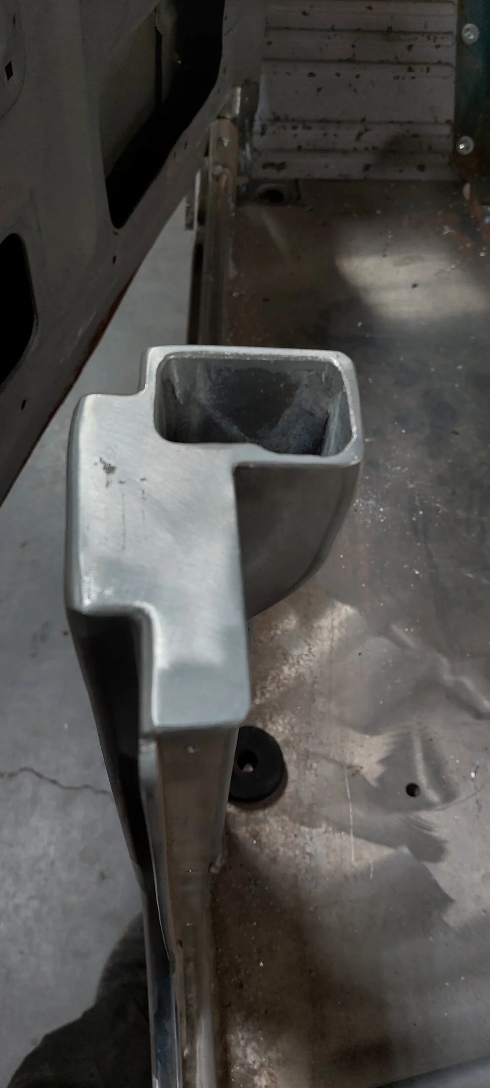

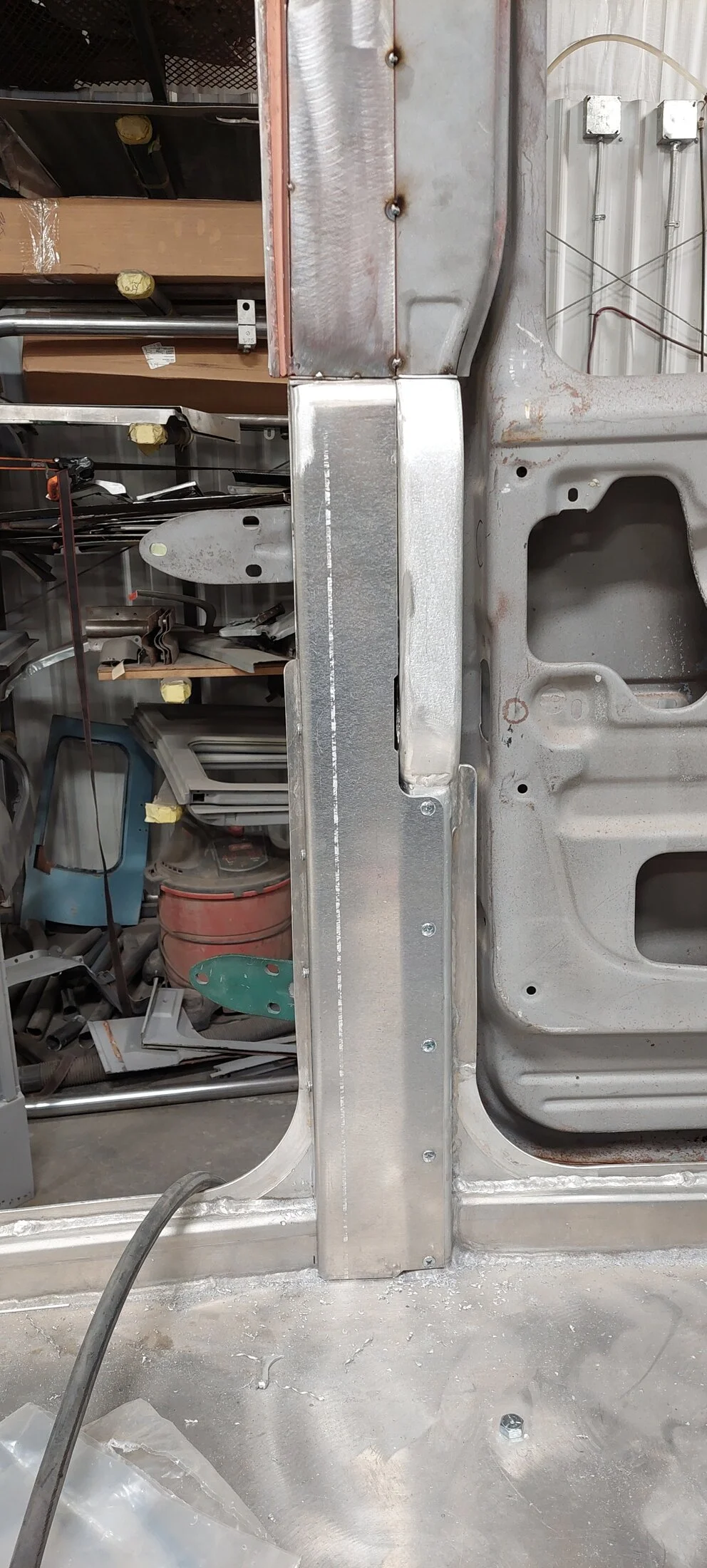

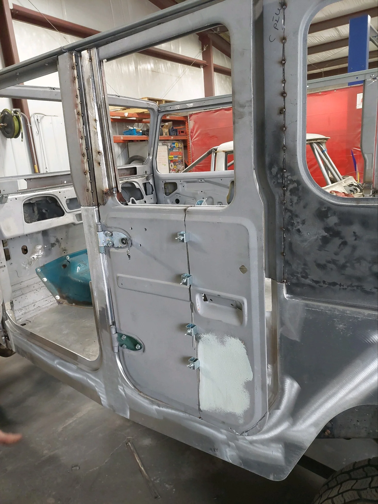

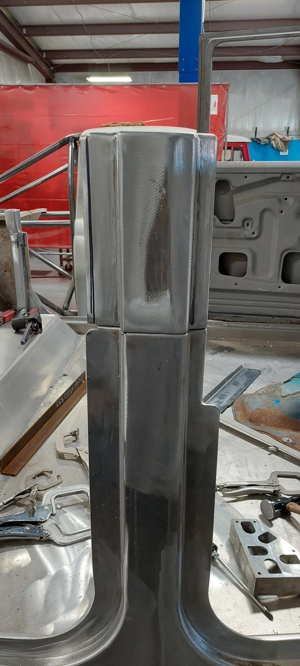

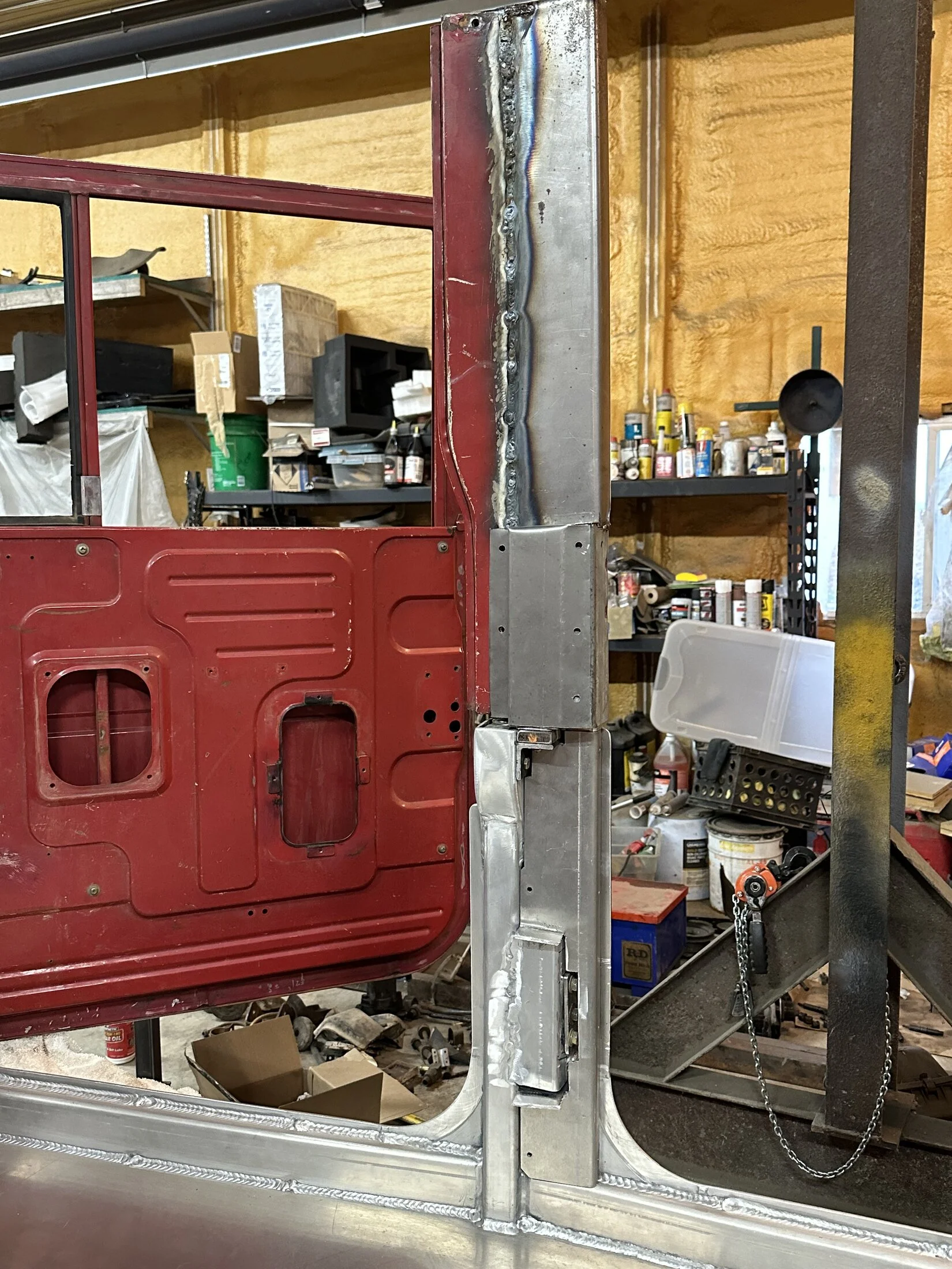

Funny to find this thread, I am currently doing the same thing to client's vehicle at work.
I took a slightly different B pillar approach. Yours looks good!
Mine looks……complicated. At best. I went for keeping the vertical rain gutter look, but your smooth look really looks nice, especially with the newer doors.

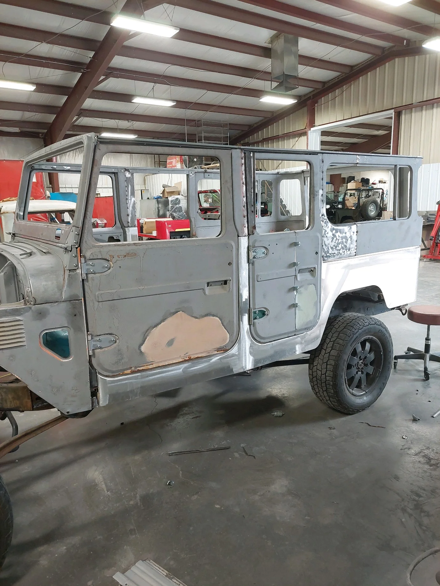

For some reason that door looks shorter? I took 5 3/4 out of mine.
Shortening the first door was the first sheetmetal cutting and welding I had ever done in my life. So I’m learning bondo too…
It sure makes sense to finish that pillar in aluminum up to the hinge!
We’ll see how mine do.
I scored some convertible seats so I’m not worried about seat belt points off the pillar.
