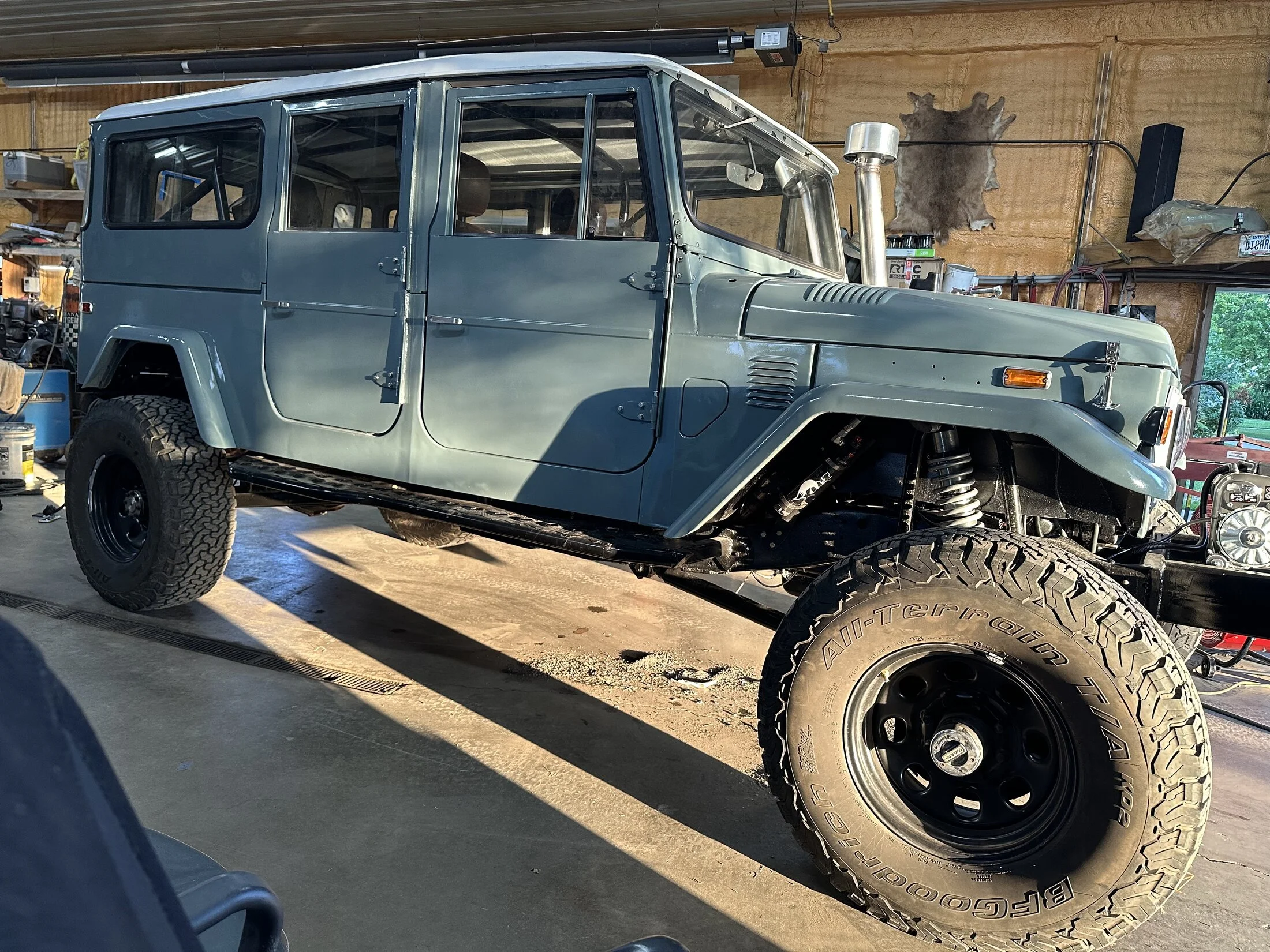

Doors are on finally.
Lots of fun to drive without the doors but much quieter with them, which was good news. Wasn’t sure if that’d be the case but the sound proofing paid off.

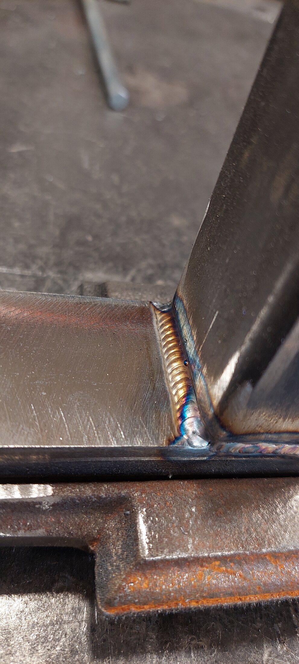

Been meaning to give a shout out to the Tig button guy. This is a great piece of kit. One of the best investments. I haven’t used the pedal since I hooked the Tig Button up.
EDIT 2 hours later…

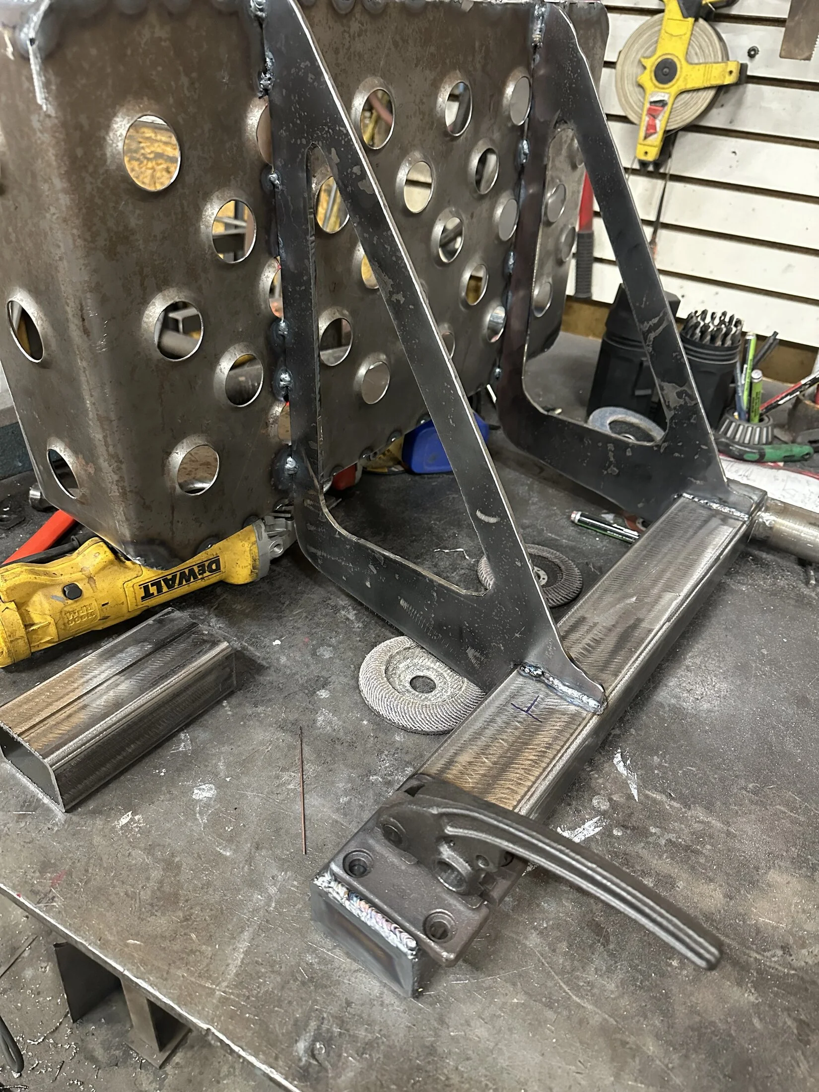

Well the Tig button guy can’t make me not stupid. I laid down some of the best dimes I’ve ever done on that latch.
And then looking at some pictures again I realized I welded it on upside down. At least it isn’t painted yet. Duh. Get to try it again.

I love my tig button. One of the best investments on my tig machine. I run pedal for D/C most of the time, but all my A/C is with the button.
I like the super fine control of the pedal for DC. Much easier to dime it.

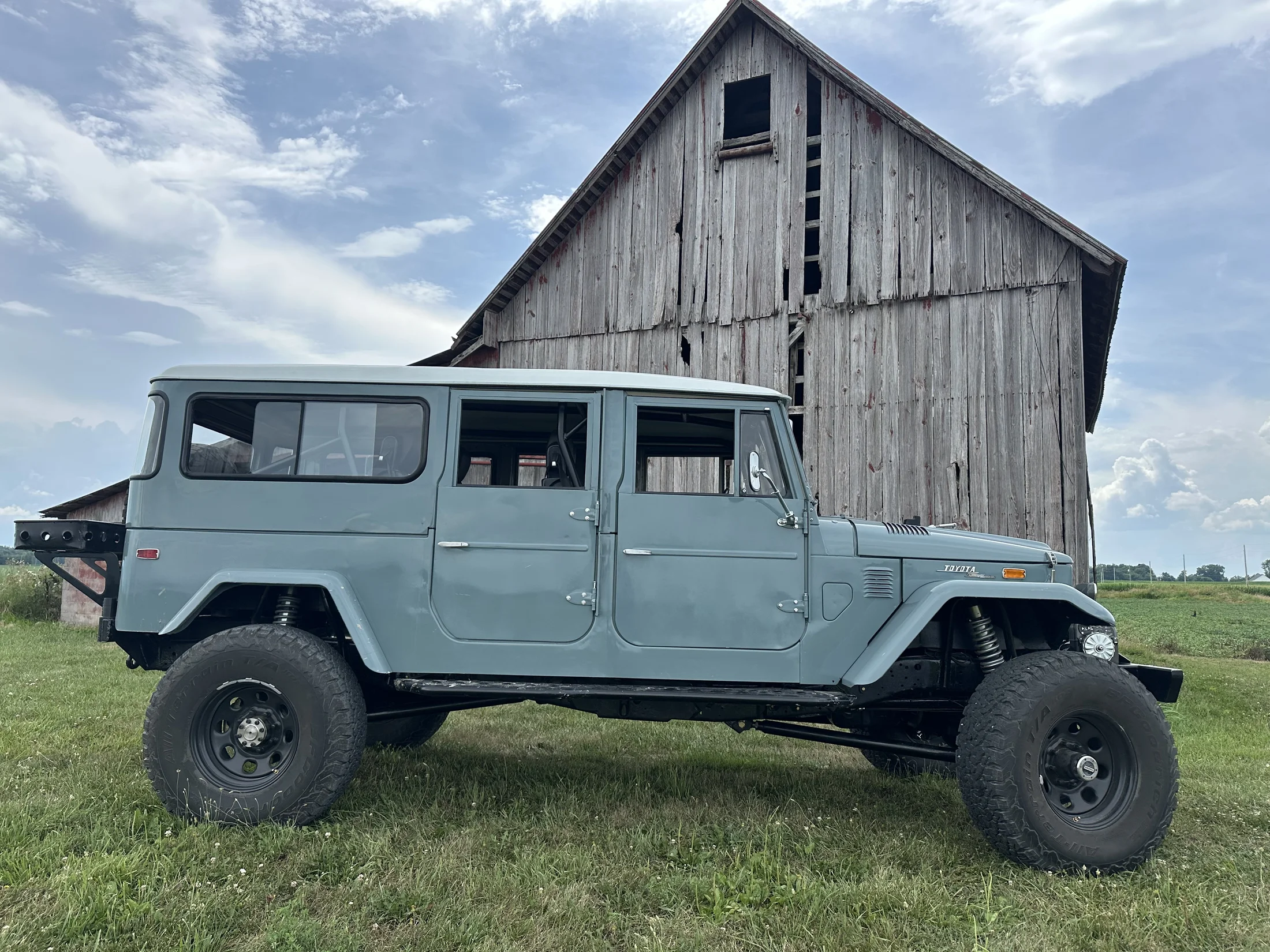

Driving the beast Daydream* everywhere I can, I’ve gotten about 600 miles on it. Drive, see what needs fixed or tweaked, drive…
Have an issue that sounds like air in the injectors when I’m getting down to half a tank of fuel, mild to moderate power loss and a lot of black smoke, comes and goes randomly. I can’t make it happen. Dropping the tank tomorrow and welding an outlet near the bottom to do away with the Fass tank suction mess, will draw from the bottom on the outside.
There’s a lot of great things on this truck that I’m happy with, but a few that I’m not and they seem to be the big ticket items that I’ve paid good money for, not what I’ve built myself.

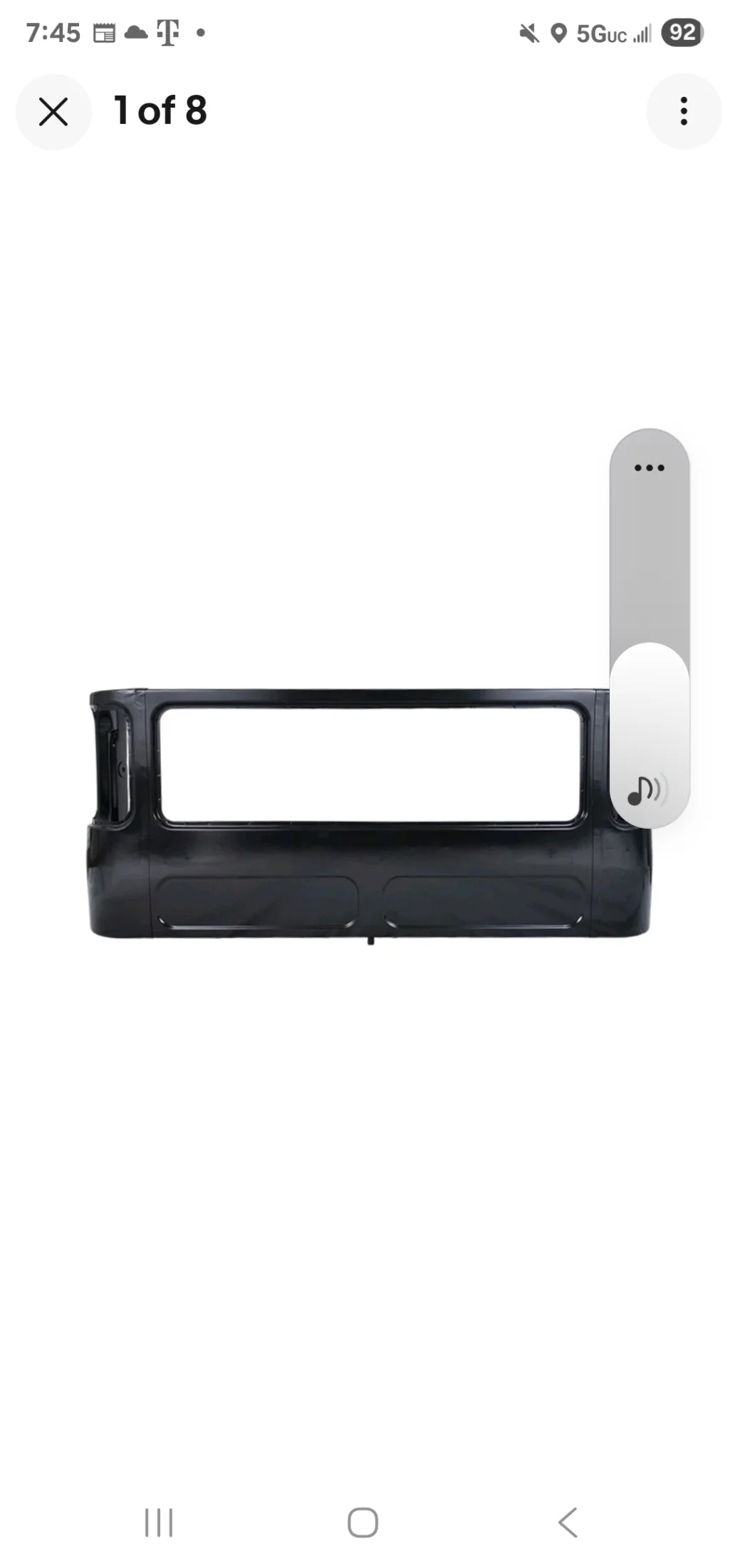

Does anyone following my thread have one of these? Or a truck to part from?
I know it’s a long shot but Blacknight1 needs one for a build.
Build thread here 4 door Fj45 on 80 series chassis - https://forum.ih8mud.com/threads/4-door-fj45-on-80-series-chassis.1257670/page-34#post-16035755
@Tank5 can we use the one Mike found in that barn?
It was rusty and beat. Not worth the shipping.🤣
I would tell him to look into getting one of the Chinese reproductions.
