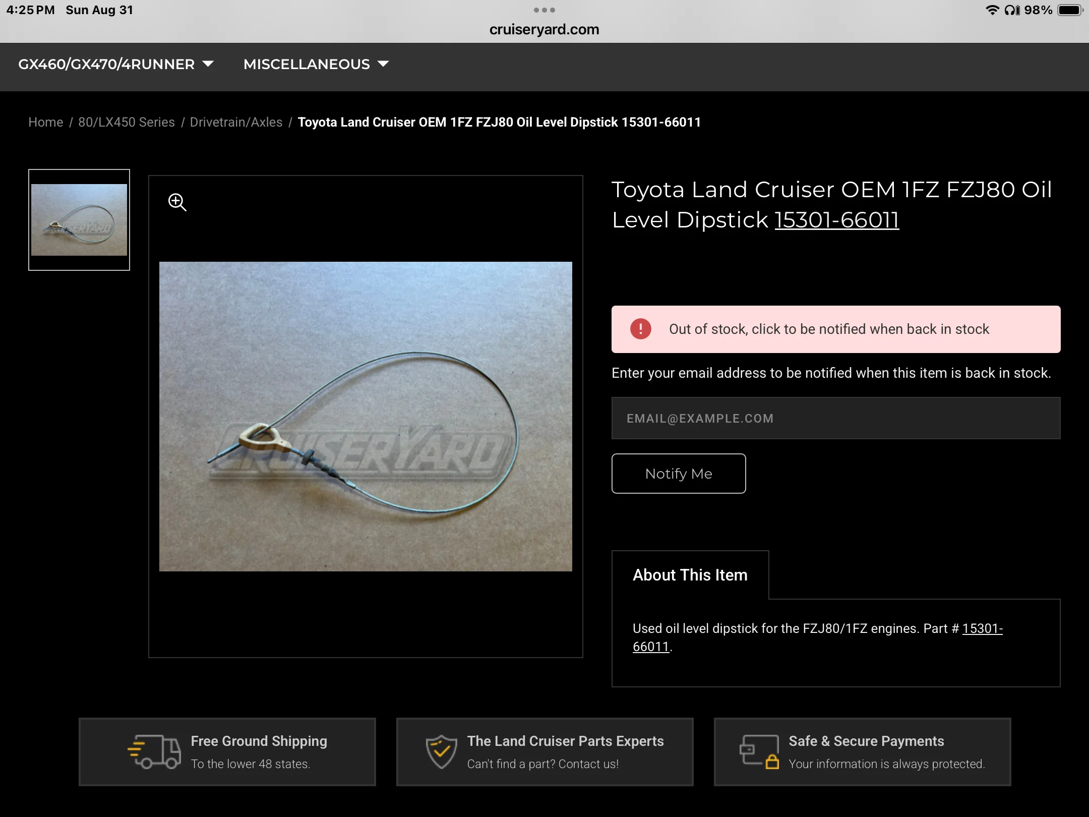

Edit: the early style dipstick was the cable type, the superceded (later style) dipstick "Gage sub-Assembly Oil level" is/was 15301-66010 (superceded to -66011) and should look like in the bottom photo below, a somewhat flexible thin/flat metal bar:
Early cable type:
Later flat bar type:
So if the oil level is at the lower edge of the FULL crosshatched (or indented) area, then you're ~1 to 1-1/2 US quarts low.

I think the early 1fzfe had a cable style dipstick, either way the oil from l to f should be a quart or less, not quarts.
Fixed it: the process for checking the level and how much to add when low should remain the same.
The amount of oil needed can vary depending on exactly where the measured level is, how it's measured, size of the filter, temperature of the engine, day/night, wearing your glasses or not, parked in a driveway on a slight incline, etc, etc but IME it's somewhere around 1 to 1-1/2 US quarts using a large filter when the oil level on the stick is at/near the lower edge of the cross-hatched (or indented) area.
