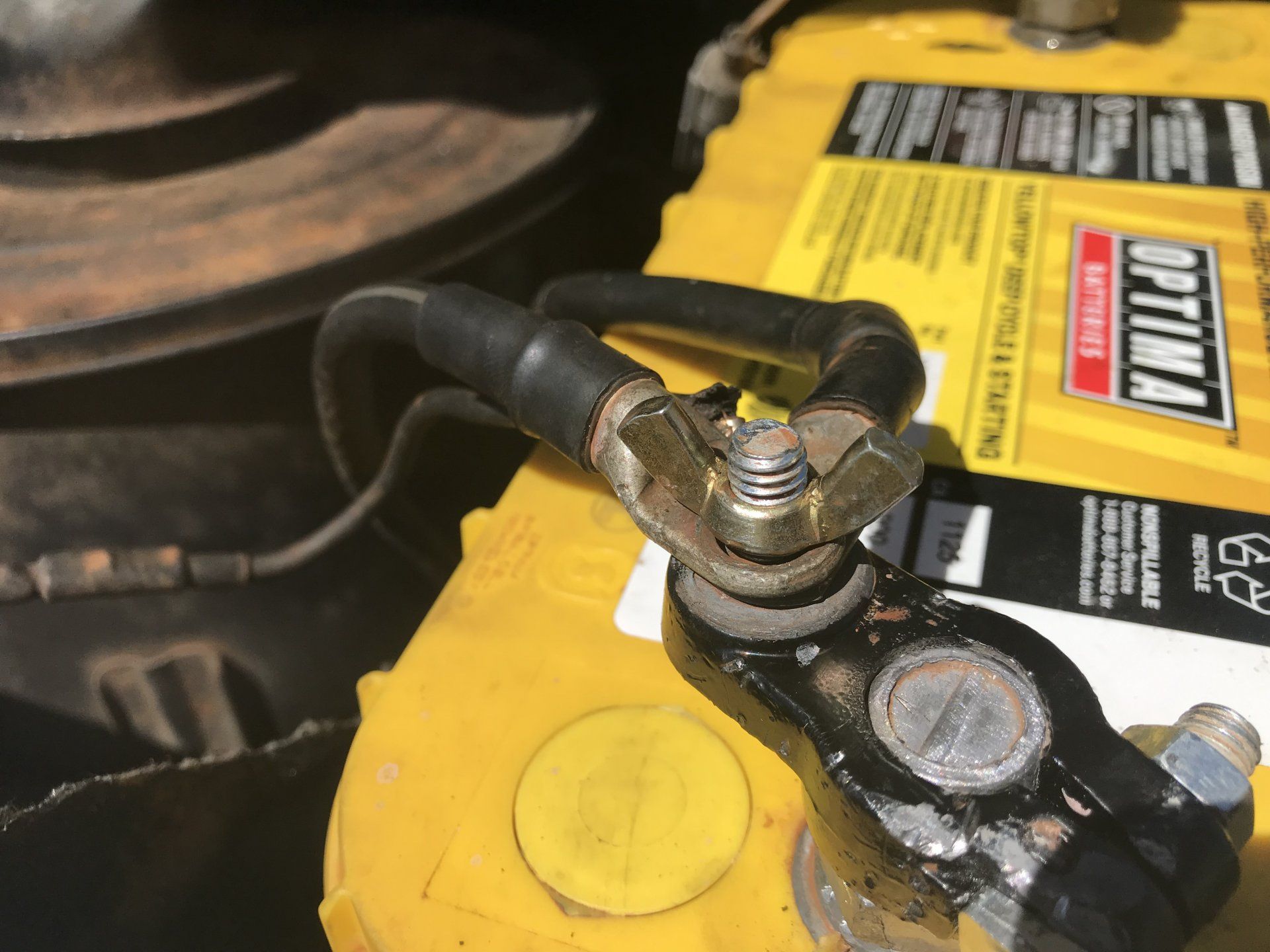

So I had a problem with battery so I went to pep boys and recommended a optima 31d , and please let me know what I should change or do different.
Added the battery, drove home parked came back 5 min and got the dreaded a/t temp light, ebrake light and alternator red light.. so I went off to autozone to pick up a duralast alternator🤨 .. (I also bought the higher amp alternator at Toyota dealership but need the rare bracket to hold it down... so if you know where I can find please pint me in the right direction)

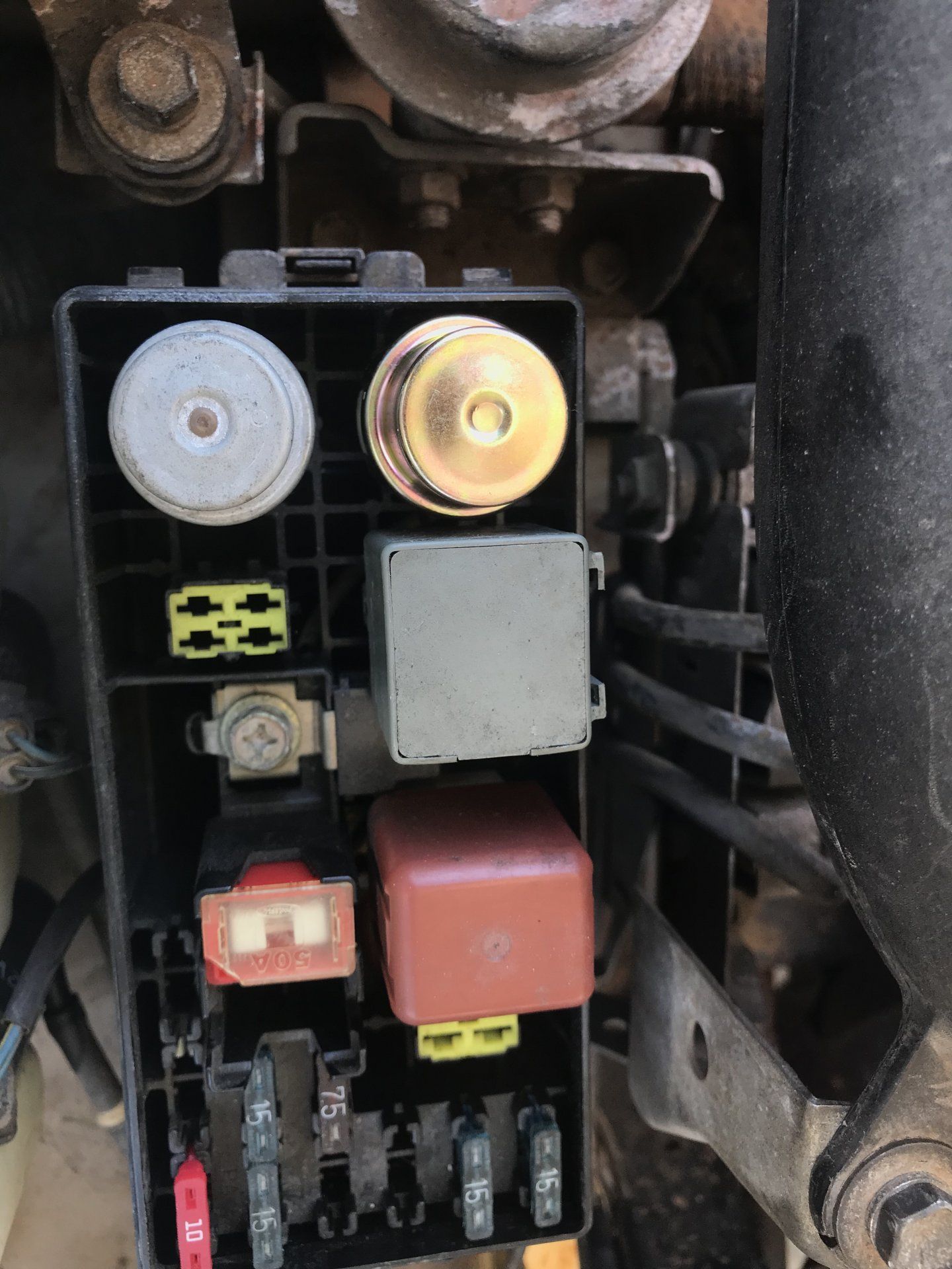

Hi, On the 1991 and 1992 if it cranks and doesn’t start check your Eli in the black fuse box under the hood. If the contacts look discolored get a new Eli. Also check or just buy new fuseable links at the battery. Mike
First thing to check is your fusible links off the positive battery terminal.
Since the battery was just replaced, they would have been moved around. They are inexpensive and should be replaced with each battery change.

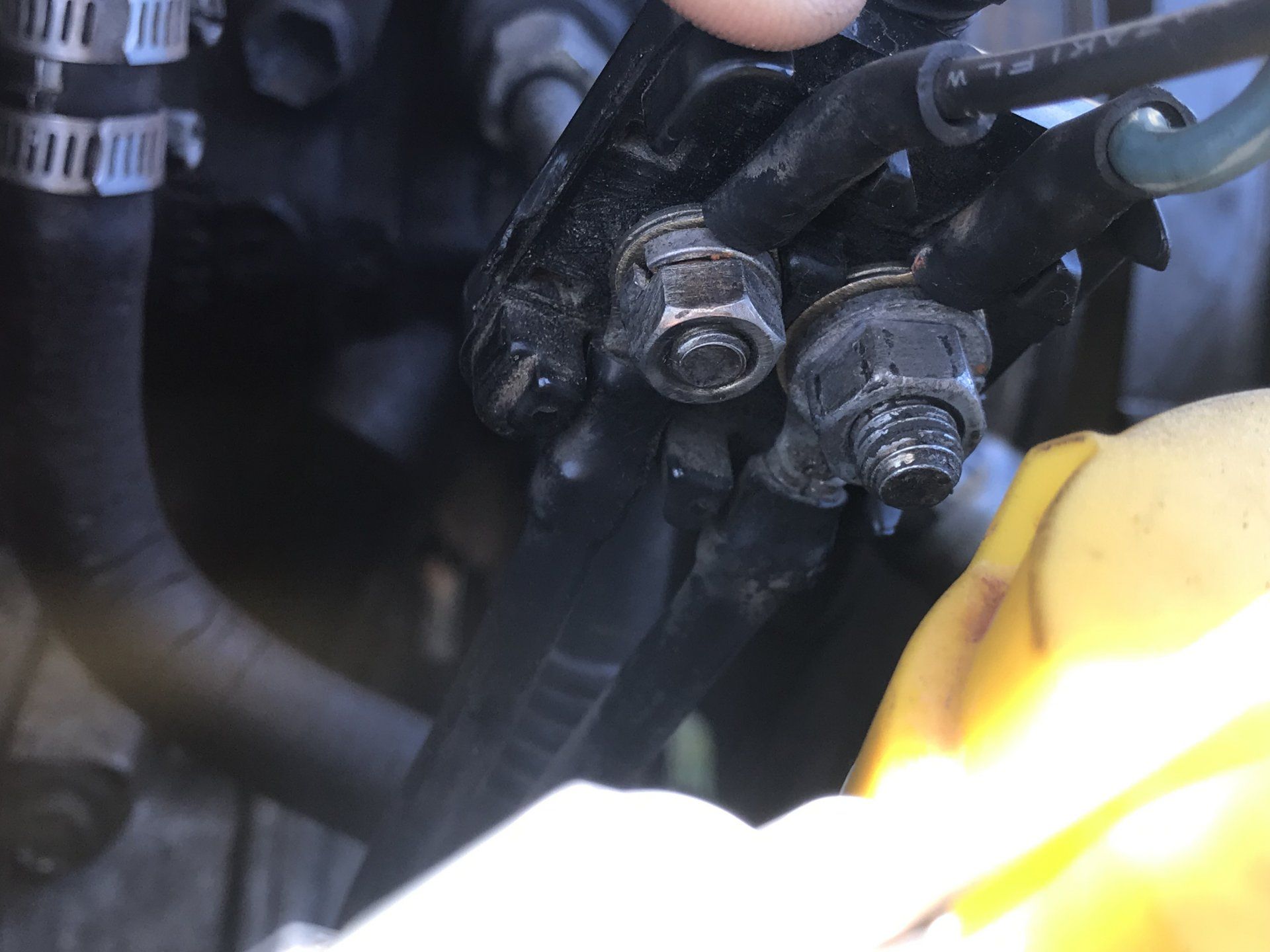

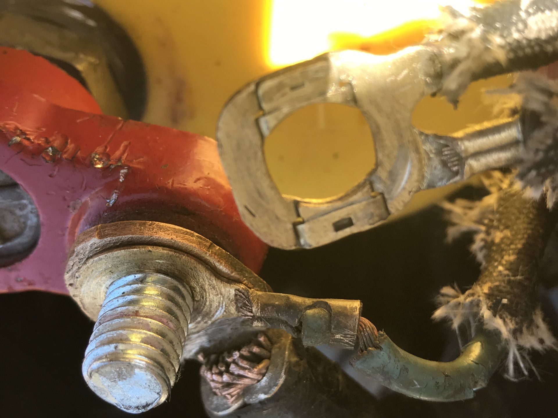

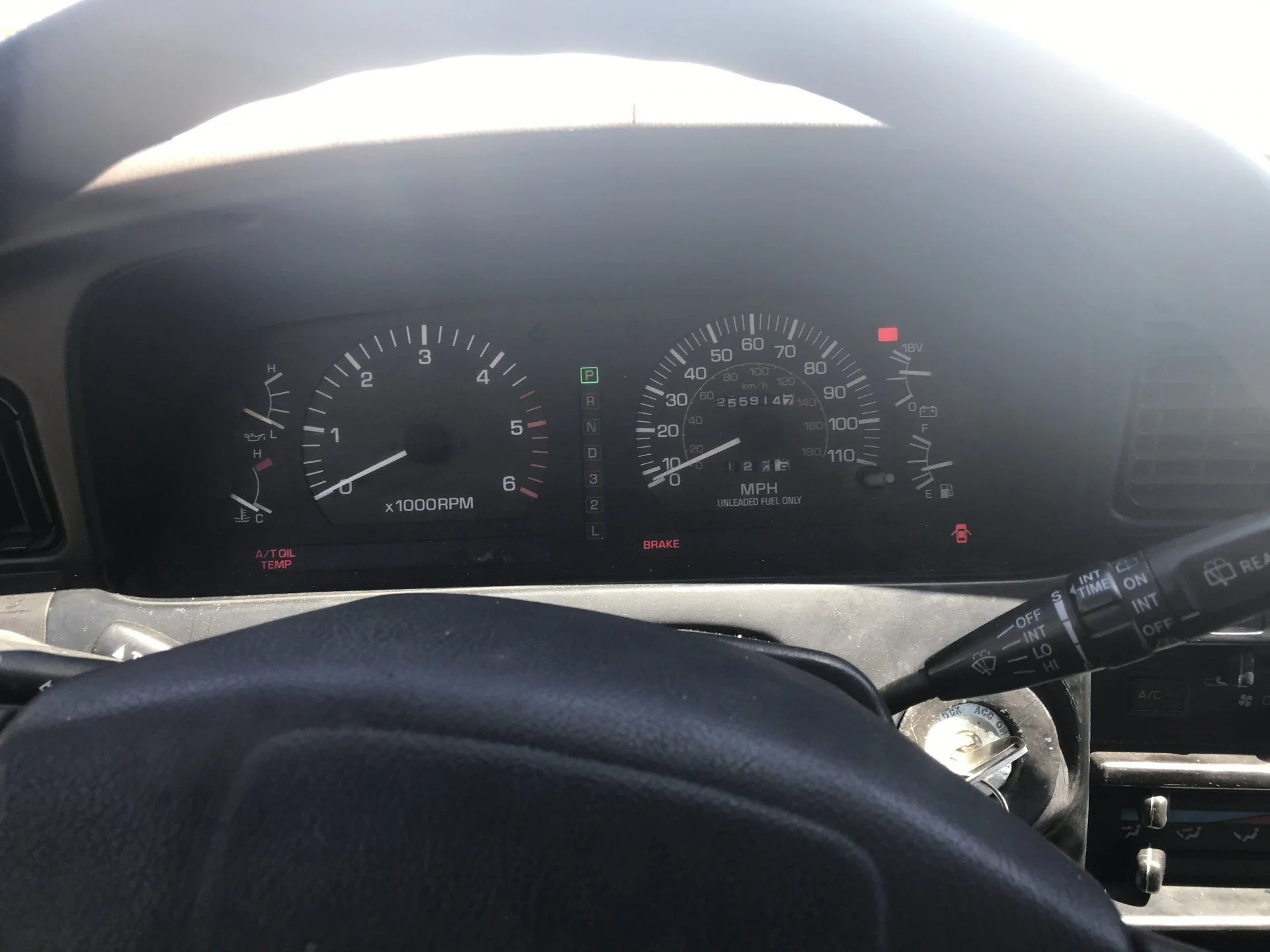

Ok just uploaded some pics to give more detail, and yes you are right CEL does not illuminate in the ON state.

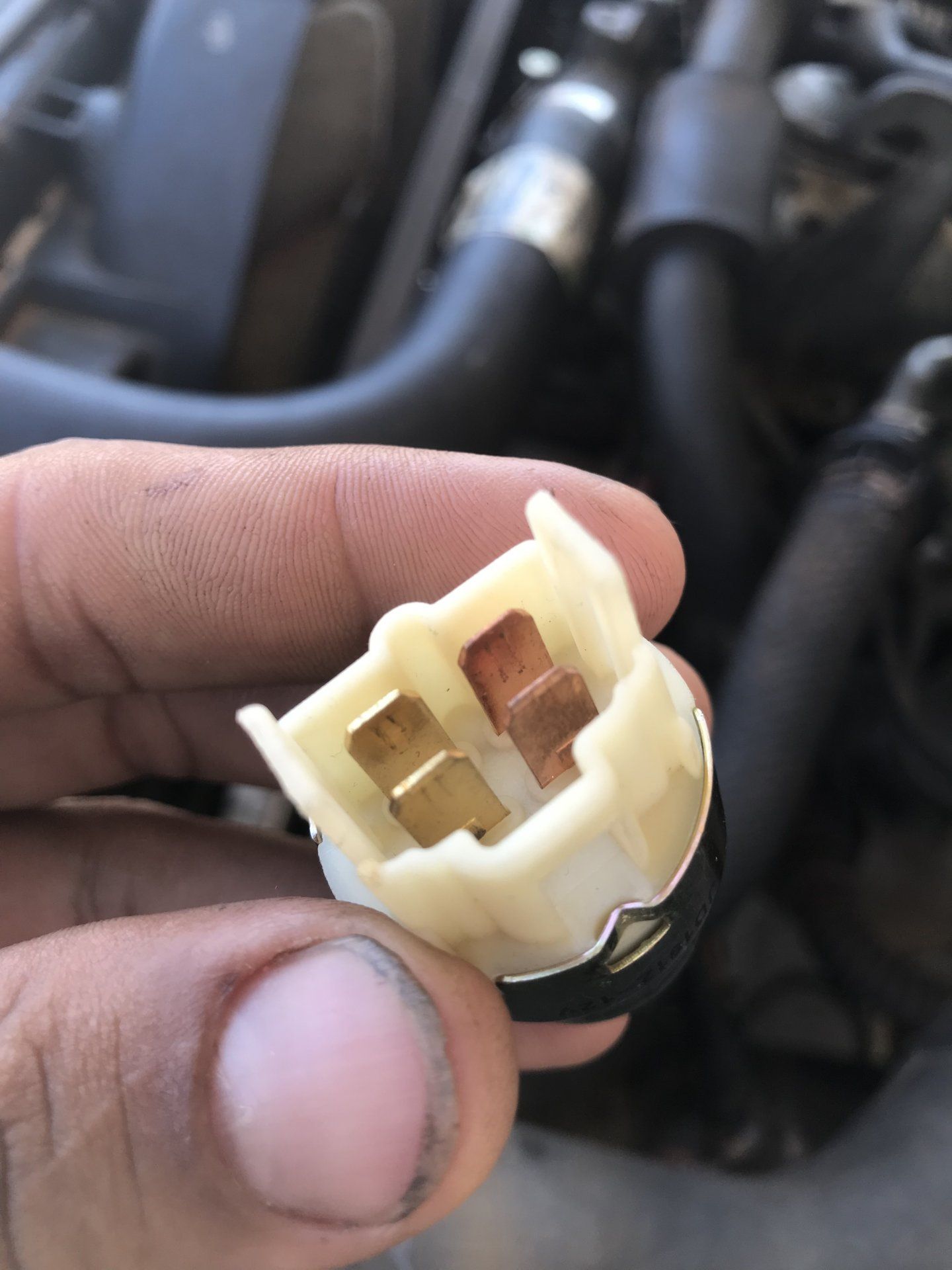

Just changed the relay and wasn’t that ...
This is like dealing with my wife.
If you're going to ignore my suggestions, then I can't help you.
Based on how beat-up that blue wire is on the FL, I would get those changed out now matter what. That's a problem waiting to happen.
Check for continuity and resistance between the ends of the FL so you can at least keep trying.

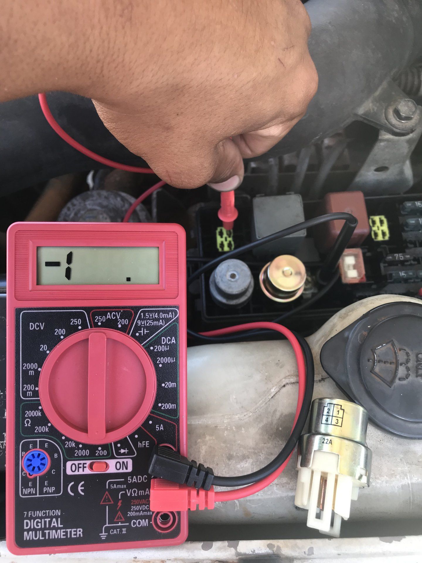

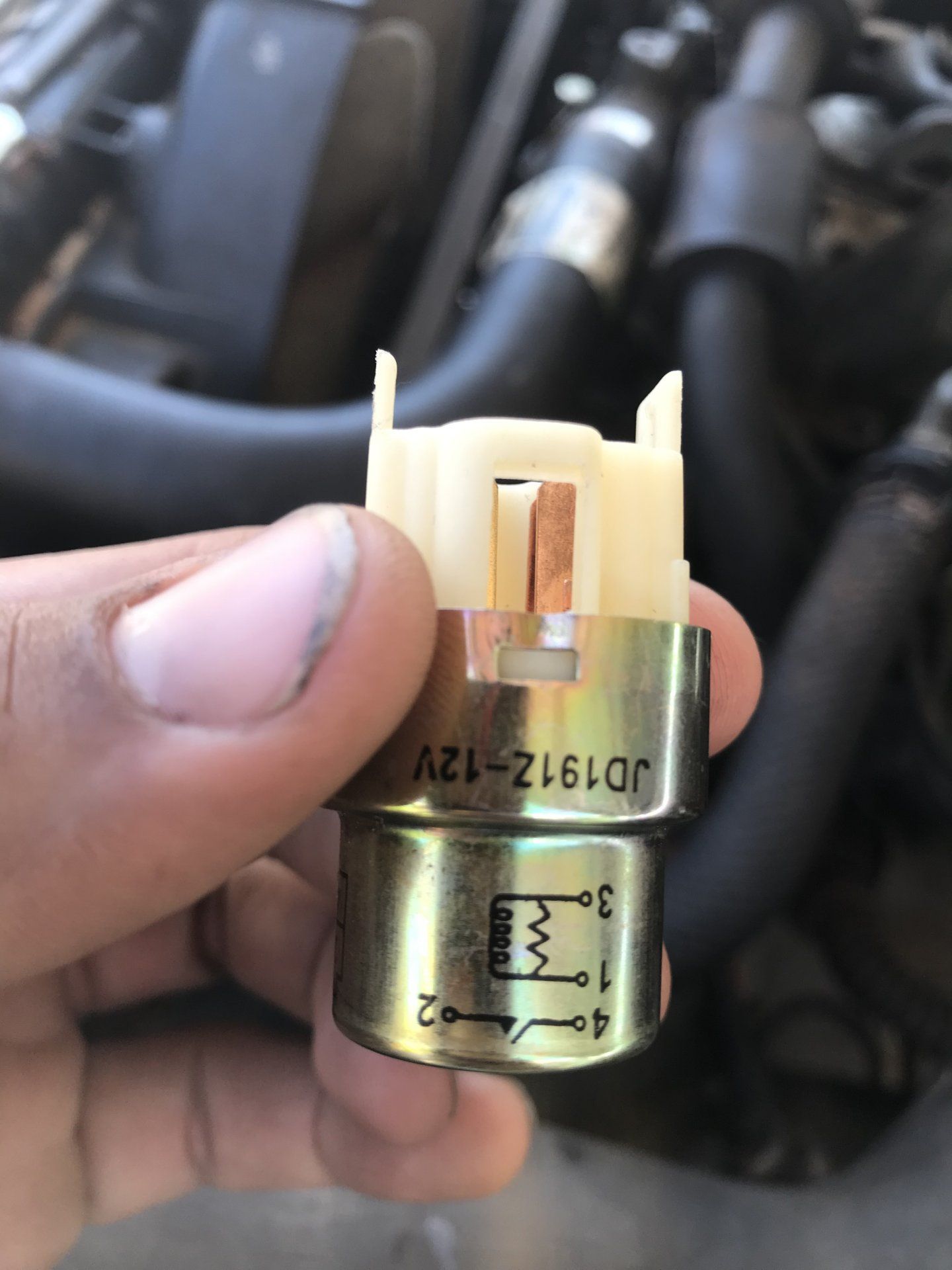

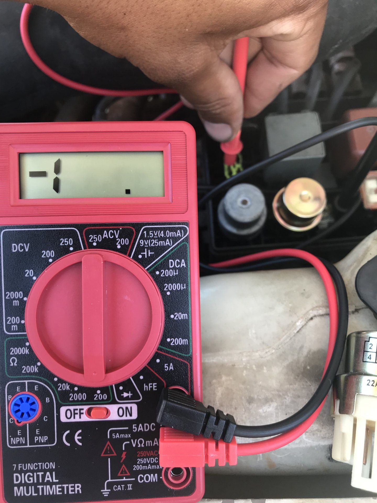

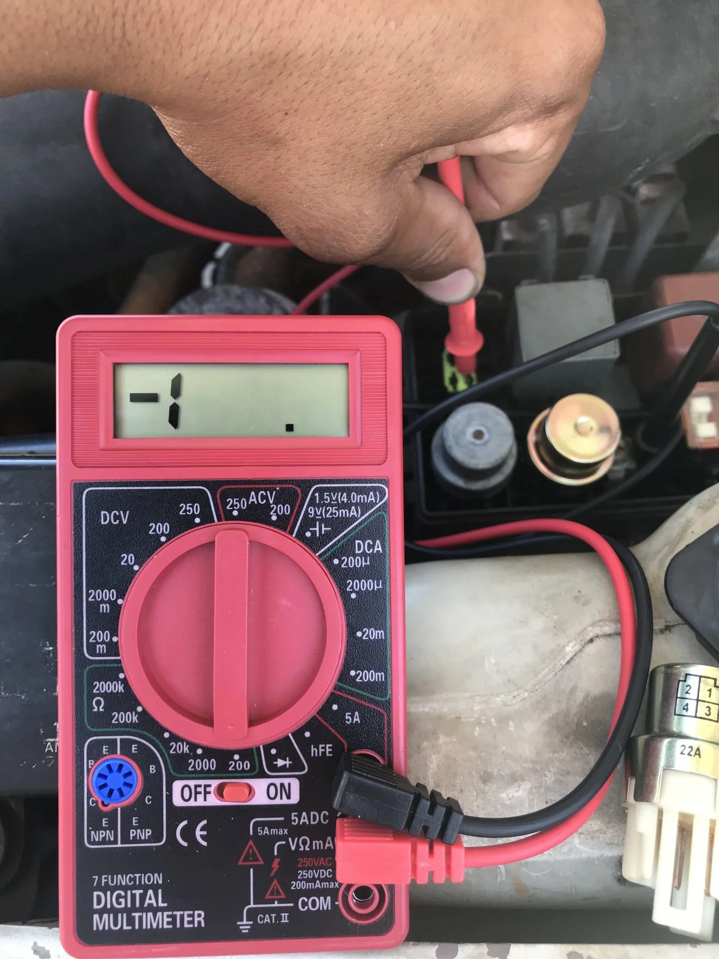

okay so I have to wait until tomorrow for fusable link but right now I’m checking the relay as john has stated in another post and these are my readings for the fuel pump relay.
Photos are in order 1-2-3-4
Hold up... My interpretation of:
is to check the fusible links for conductivity (resistance being its opposite, electrically) and see if you have a smoking gun there.
Follow the advice to replace them, yes, but you can possibly rule them out as THE issue if they don't test bad. Which means the diagnosis could continue today.
