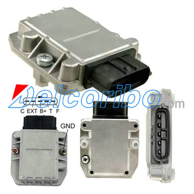

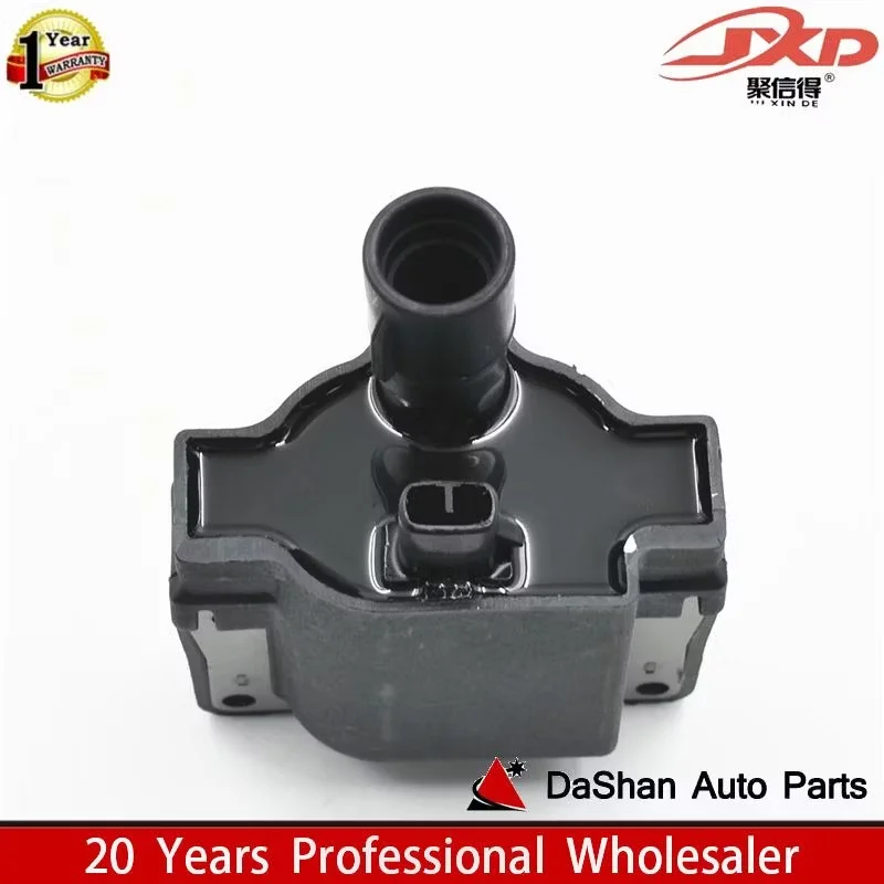

The igniter and coil on the 3FE are mounted together on the right fender in 1 bracket, but are 2 separate items. The igniter is grounded through the mounting bracket. Make sure there is no corrosion on the ground points.
The igniter (89621-30010):
The ignition coil (90919-02185):

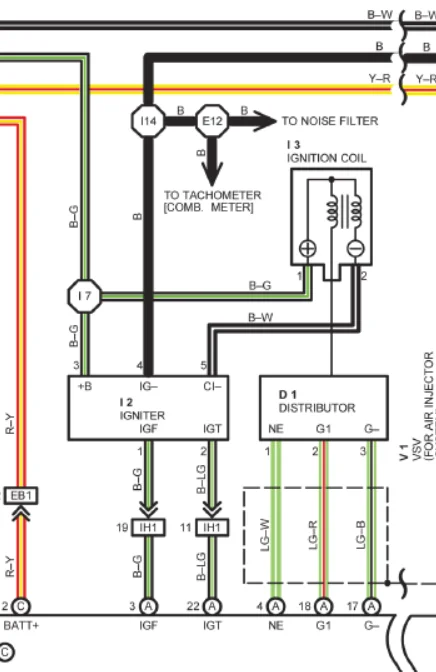

Ignition spark is developed by the pick up coils inside the distributor. Those pulses are fed to the ECU and adjusted for timing and duration based on sensor inputs.
The ECU feeds pulses to the igniter, which in turn feeds the primary of the ignition coil. The secondary of the ignition coil feeds the distributor rotor.
A snip from the Toyota EWD:
There are no other parts attached to either the igniter or ignition coil. Both of these items have been discontinued years ago.
