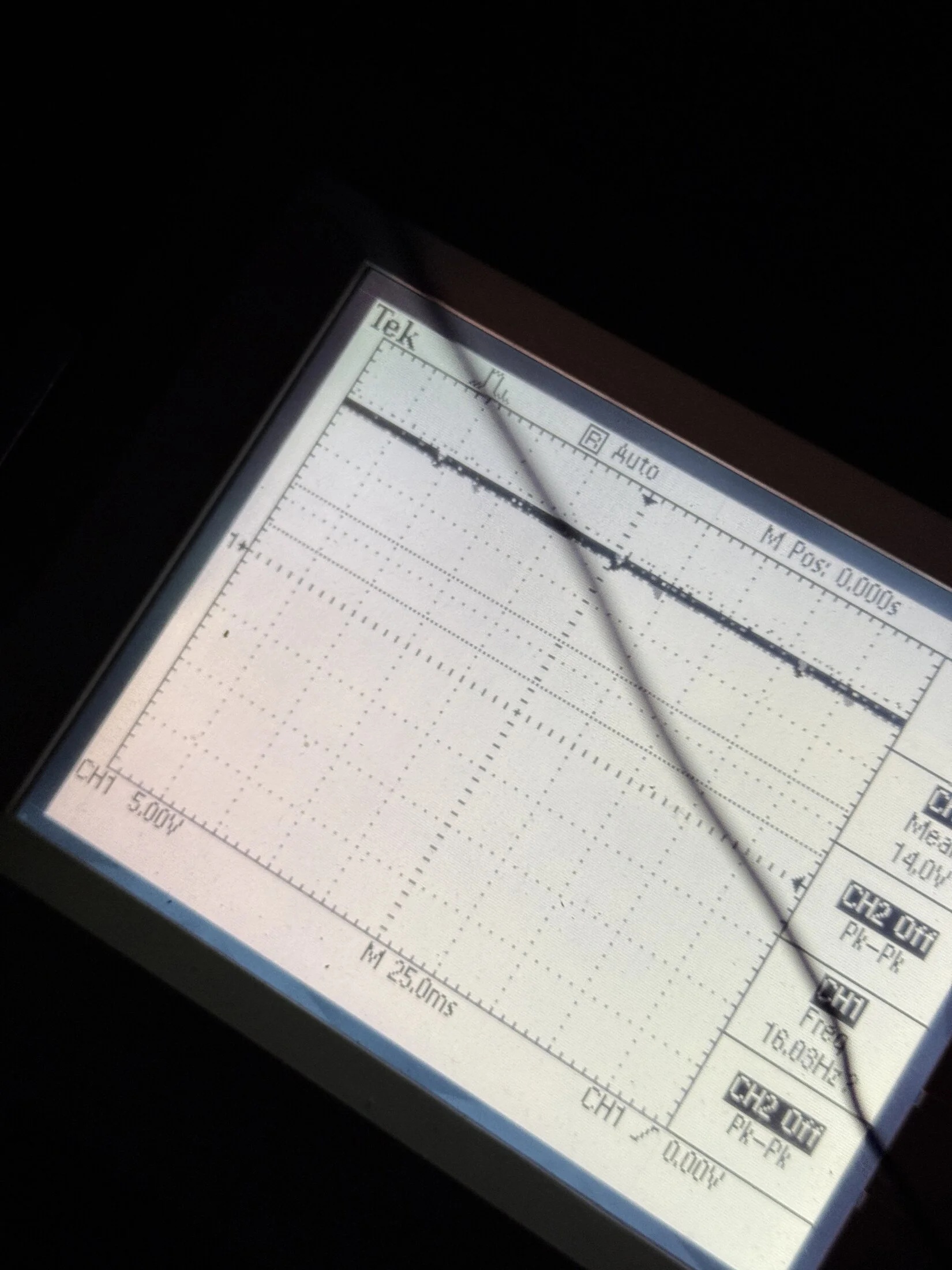

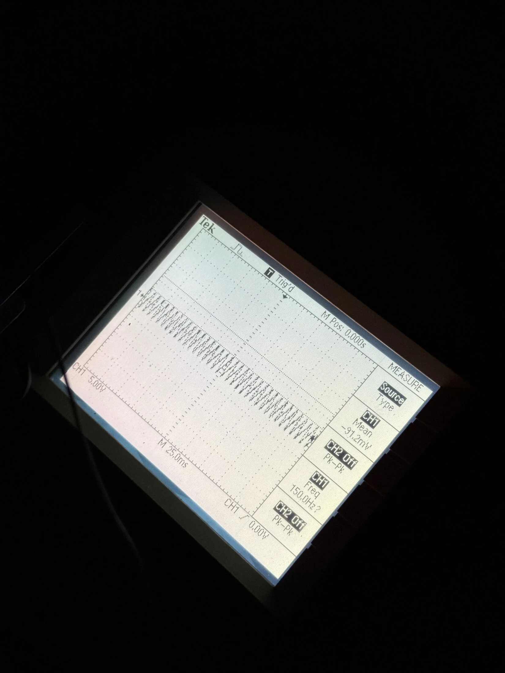

I scoped NE and G at the ECU. Below are the results. This was after checking the distributor gaps per IG-9.
Img 1 - NE
Img 2 - G
Img 3 - IGF All were taken during the problem.
I also went back to the code 41 TPS and recalibrated my TPS with the gauges. This may have made a difference as the problem seems to start sooner, but it could just be continuing to get worse. The TPS signal and the AFM signal was verified at the ECU.
Potentially unrelated, the Tach went out even though there is an IGF signal, which, to my understanding, drives the Tach.
Do these scope images look as expected? Does the tach seem like a related or a different problem's symptom?

The tach is driven from igniter pin 4 (IG-) solid black wire.
I have never put a scope on those, so I can't tell you if they look right or wrong.
Since you were previously looking at the signals from the ECU and noticing them taking hits as the issue occurred, I thought you would do the same thing to the signals feeding the ECU. Do they take hits when the issue occurs?
