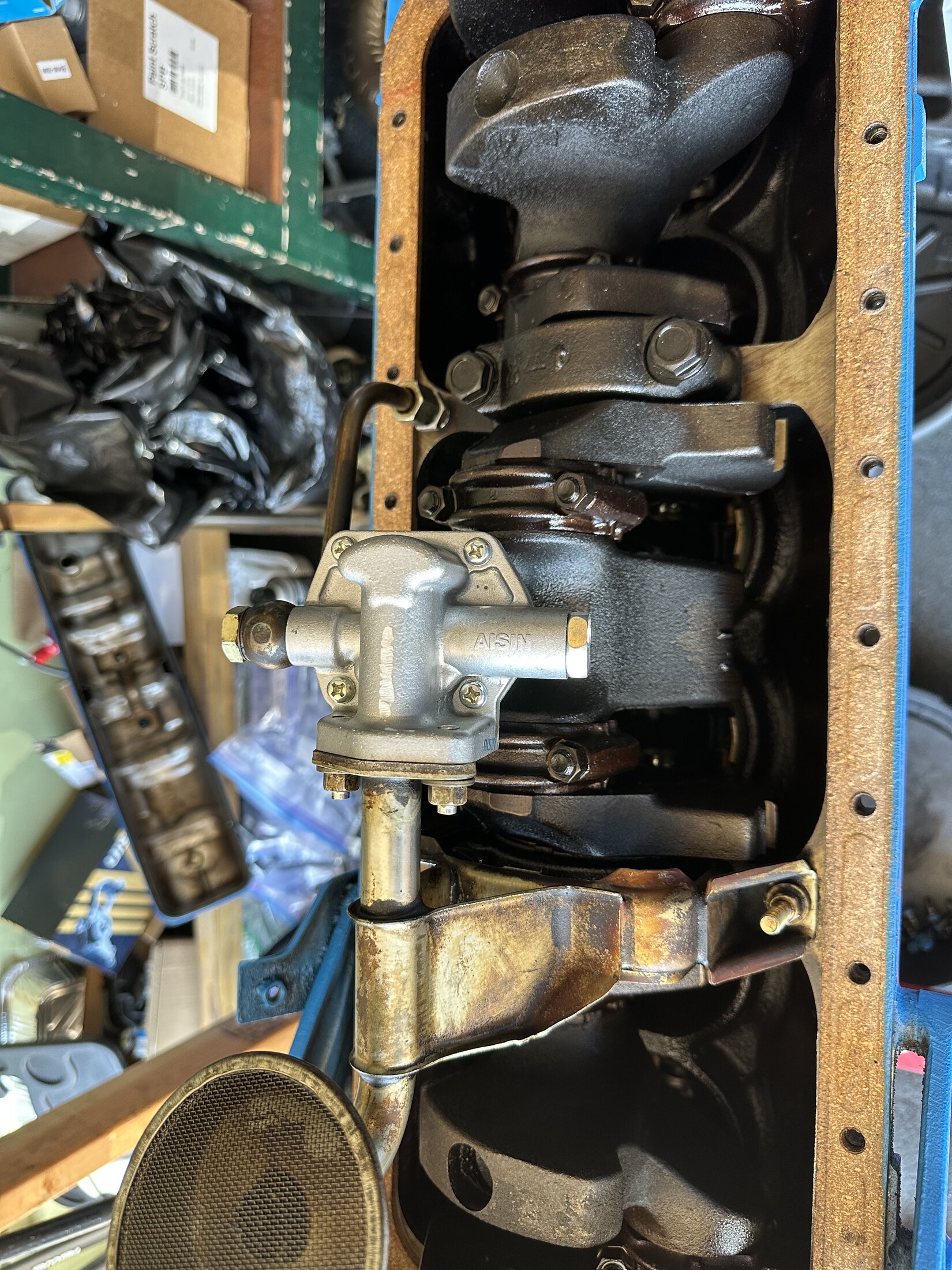

Hi everyone,
I’ve done some digging and so far have not found any suppliers that offer oil pump gaskets for the FJ80 3FE oil pump? If anyone has a source/part number for this I’d greatly appreciate it. If someone knows of a work around I’m all ears as well.
I purchased and replaced the oil pump however it did not come with a gasket… weird I know but true.

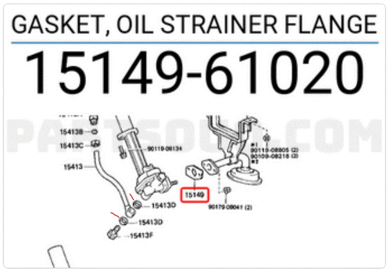

Which gasket specifically? Looks like there's one gasket for the oil pump strainer flange and another (2 required) for the oil pump outlet pipe (union).
If the flange gasket you could make your own (wait for others to chime in):
I need the gasket located between the oil pickup tube and the oil pump. I already called toyota dealership and the local parts stores in my area who all say they do not stock the part. I did a search online and did not find anything that looks trustworthy either.
You said there are two gaskets? I only saw one when I took everything apart. Am I missing a second gasket as well?
There's a flange gasket (circled in red) and then there are two thin copper washer type "gaskets" for the pipe union (see diagram below).

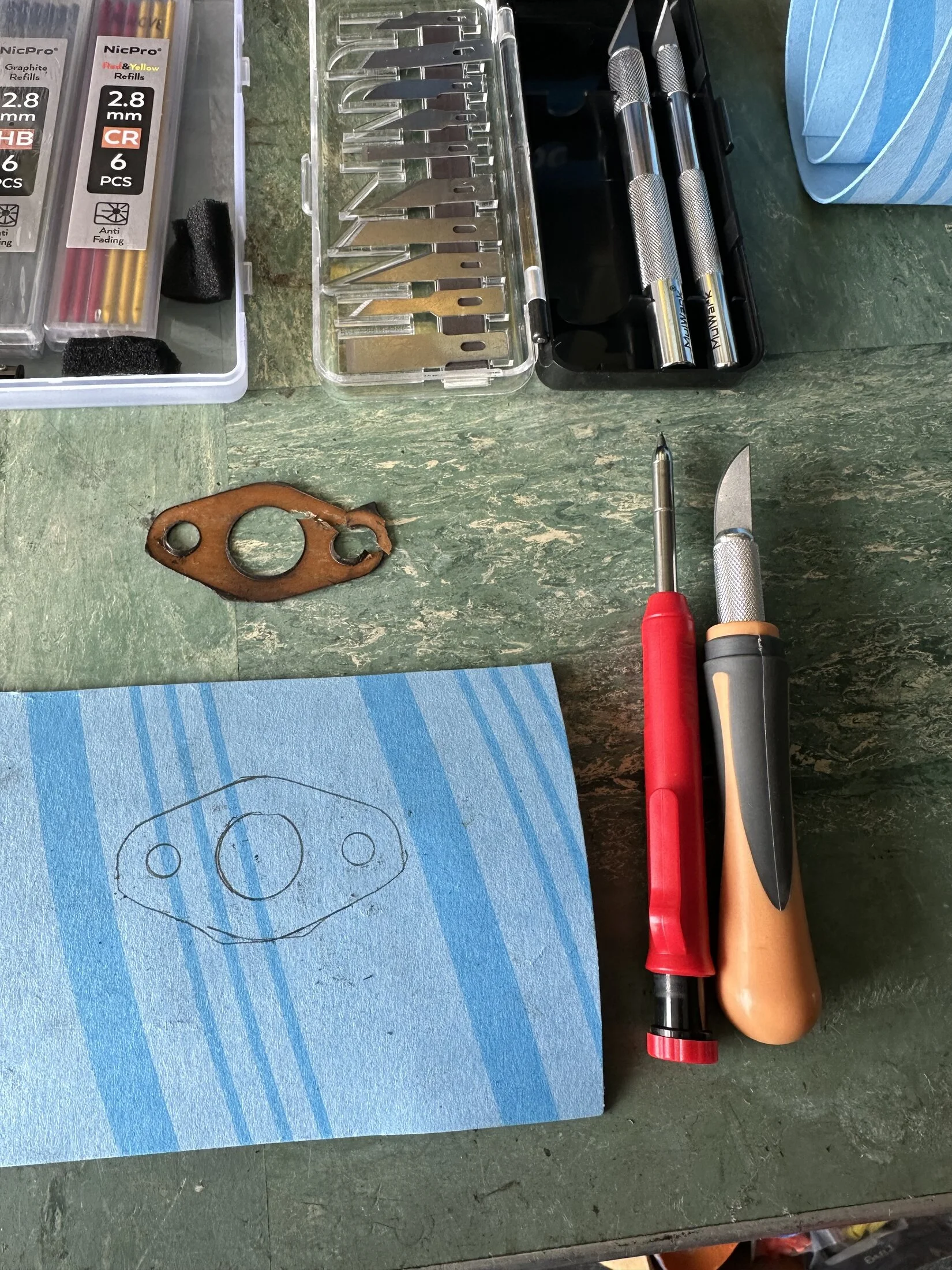

One option if the old gasket is in pieces you can trace the flange (see video below) and make your own gasket:

You can order the type of gasket material needed (compatible with Oil, Coolant, Gasoline) and cut (reproduce) a new custom gasket using the old gasket or flange as a template. Karropak fiber is often used for exposure to oil, coolant, gasoline.
Felpro sells bulk sheets of various types and thicknesses of gasket material you can choose from.
Tip: do not use a liquid sealant instead of a proper gasket
You could contact/call FELPRO to confirm which type of their gasket material would be appropriate for an oil pump pick-up tube gasket:
Then you can order from just about any auto-parts store or online:
Here's a link to a video showing how to cut your own gaskets:

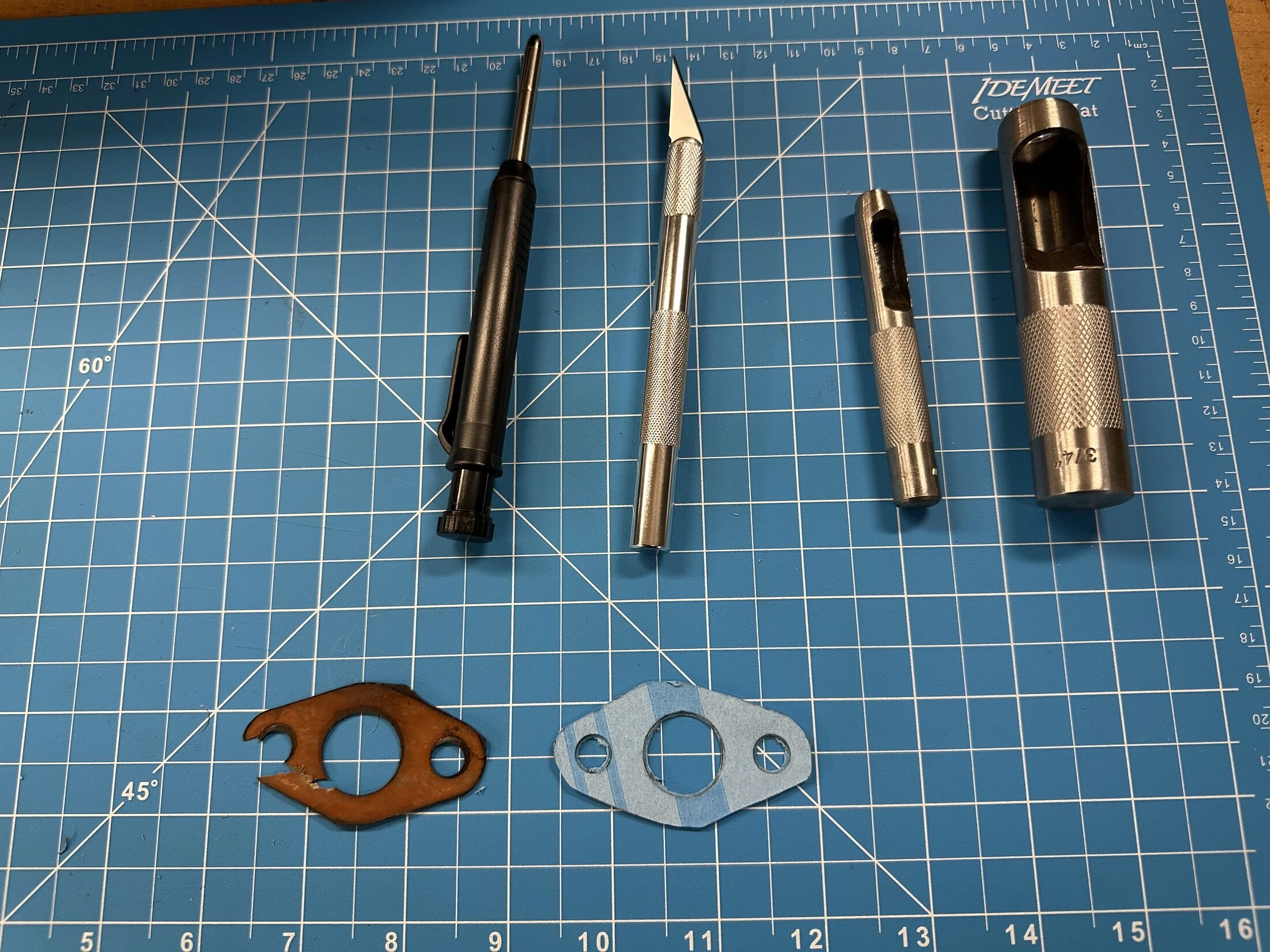

You can buy a set of hole (hollow) punches from Harbor Freight for example:
Here's a set for the large center hole:
And a Hobby Knife set:
And you'll need a good pair of scissors with a fine serrated edge to cut thicker material:
FISKARS makes many types of scissors for different materials
To help others (future searches) take a few photos of the old gasket and flanges and post them up here along with the measurements

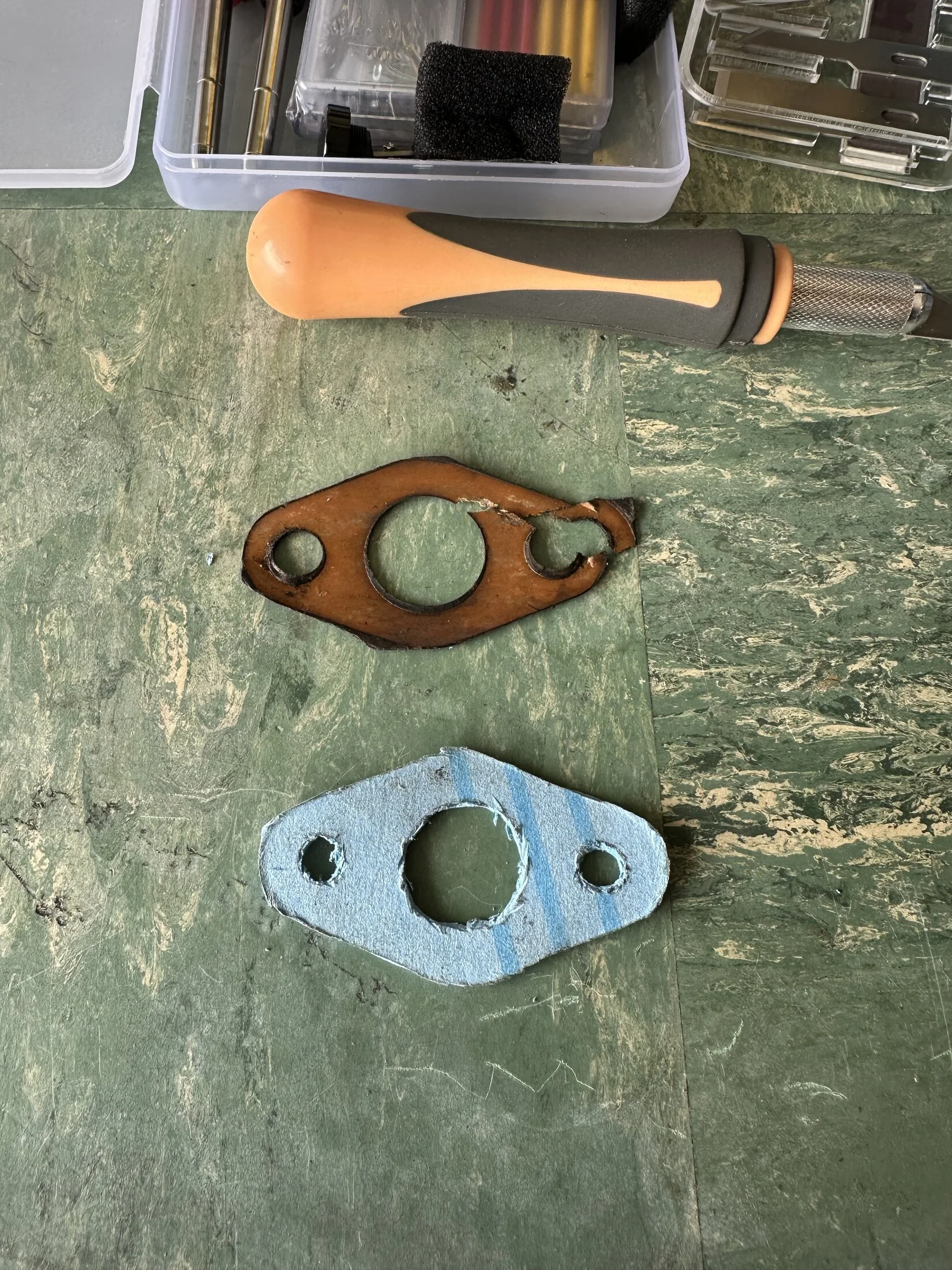

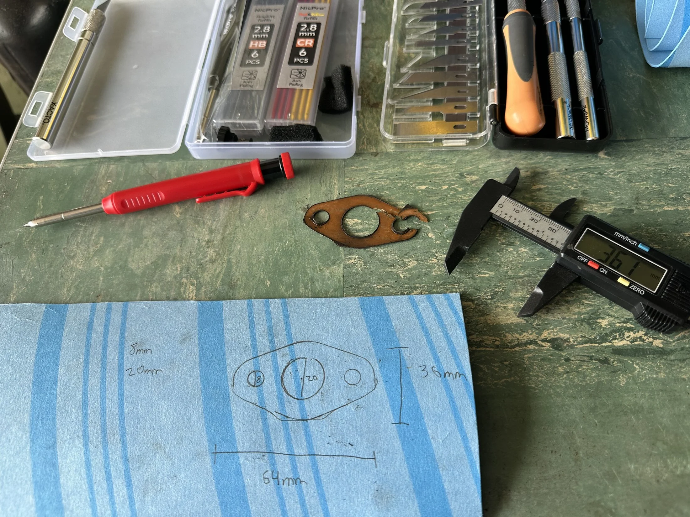

I purchased some of the thicker gasket material. May be too thick but I’ll confirm soon enough. Made another gasket with some punches to get a cleaner result.

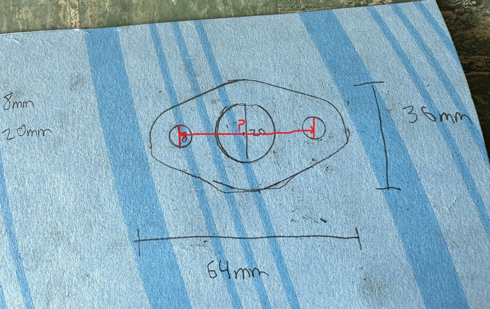

Looks like 1.75” center to center each bolt hole.
Did you get the bolt hole to bolt hole measurement using the old gasket or from the flange itself (the flange hole to hole measurement might
be more accurate)?
So far what we have for a 3FE oil pickup tube flange gasket (IIRC the 91-92 FJ80 is the same as 88-90 FJ62 models):
36mm tall at the center
64mm long end to end
44 (? 45mm) bolt hole center-to-center
20mm center hole
8mm bolt holes
So with that information anyone reading this with a new oil pick-up tube flange gasket from other Toyota's (or any brand) could compare to that gasket and post up the part number if it matches. Or, find a generic gasket that matches those dimensions (or just make your own as above).

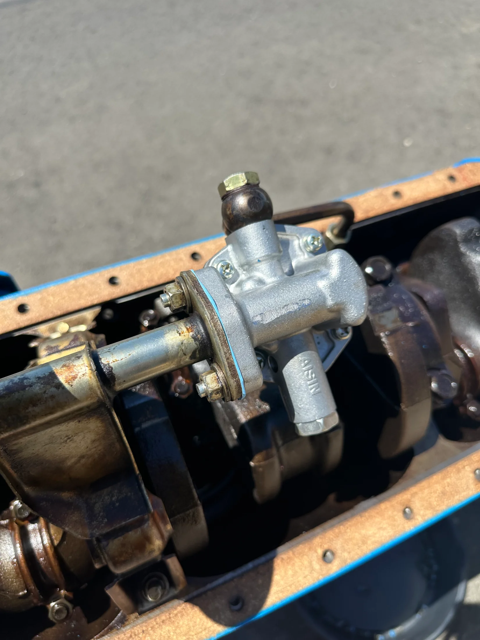

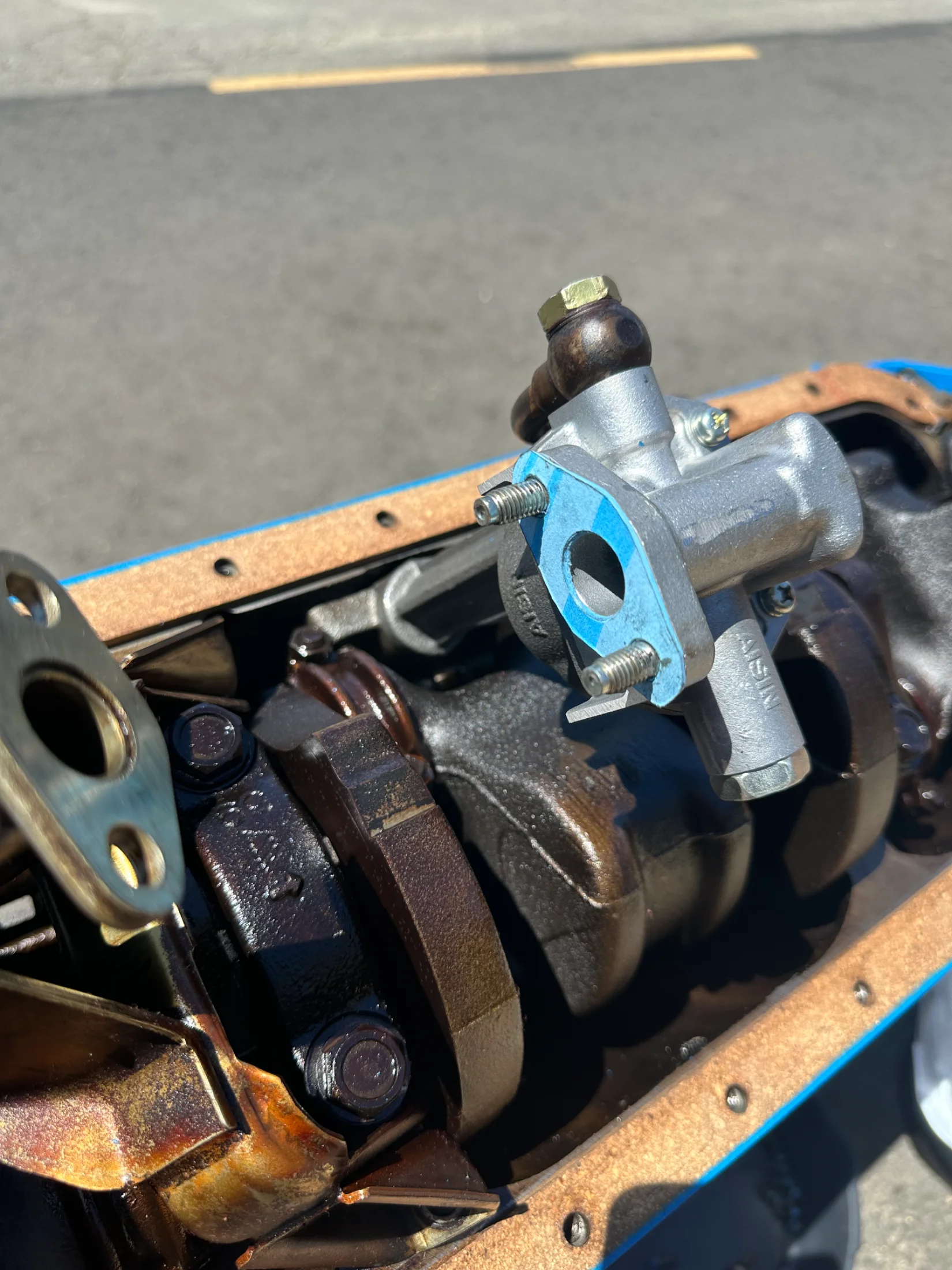

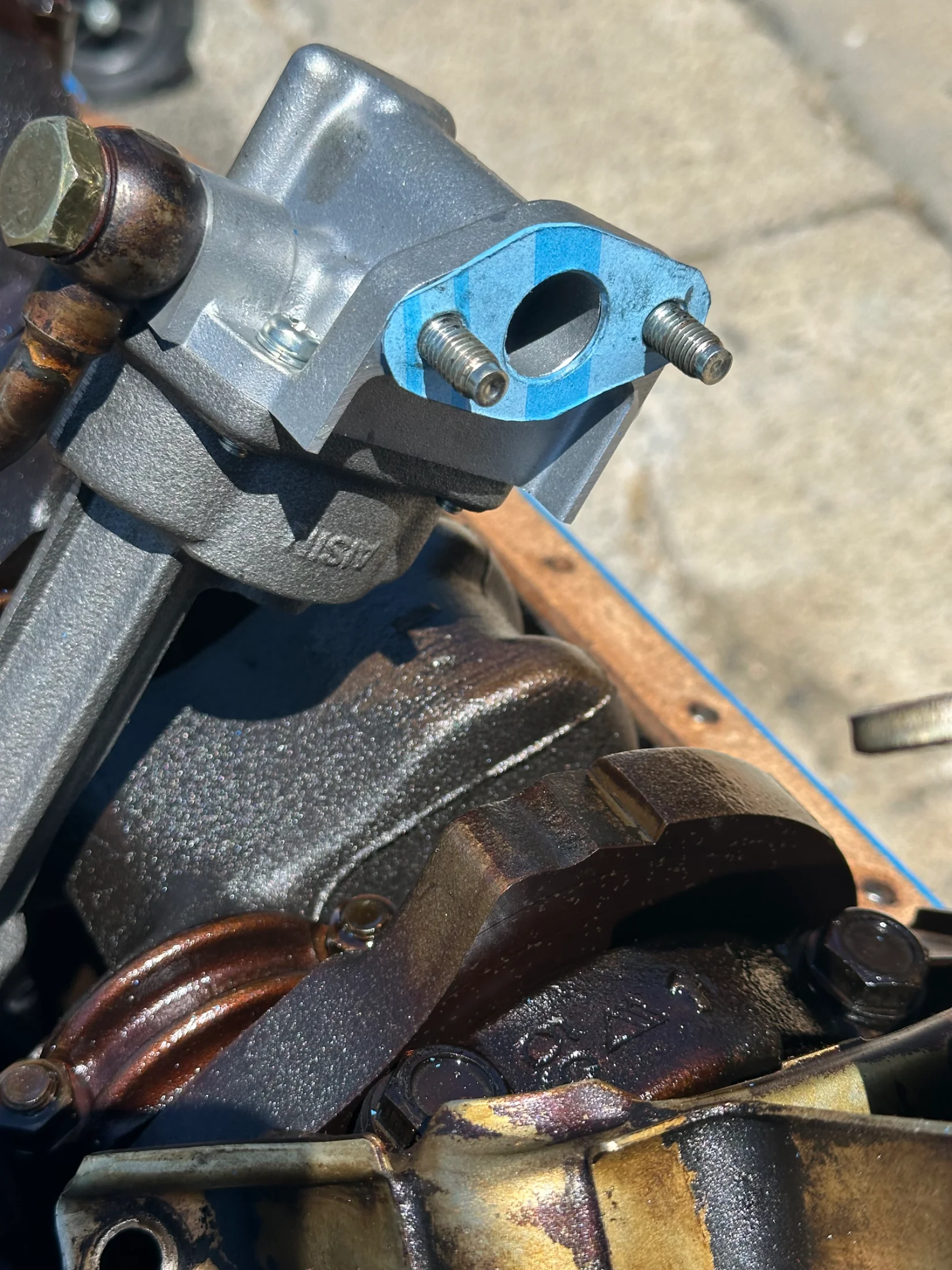

Finally got around to installing the oil pump gasket and measuring center to center on the pump studs for more accurate numbers for future references. Looks like 43mm to me.
