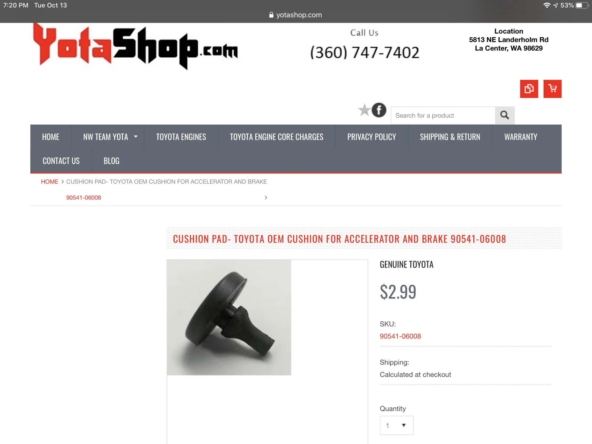

Well look what I found on the floor mat underneath the brake pedal. Y’all are on top of it. Best place to order online? My nearest dealer is 20 miles away and I’d rather not go into a covid19 infested city. Currently a quarter has the lights turned off.
That is the correct number. I’ll get my Toyota dealer to order it. They usually get stuff in 48 hours.
They're cheap enough, get a couple.
Installation will be potentially more frustrating than you would think since it's only a small rubber item. You'll need to depress the brake pedal to feed the tip of the cushion through the hole and with pliers grab the tip and pull the cushion fully into the hole. Cramped space makes this tricky.
