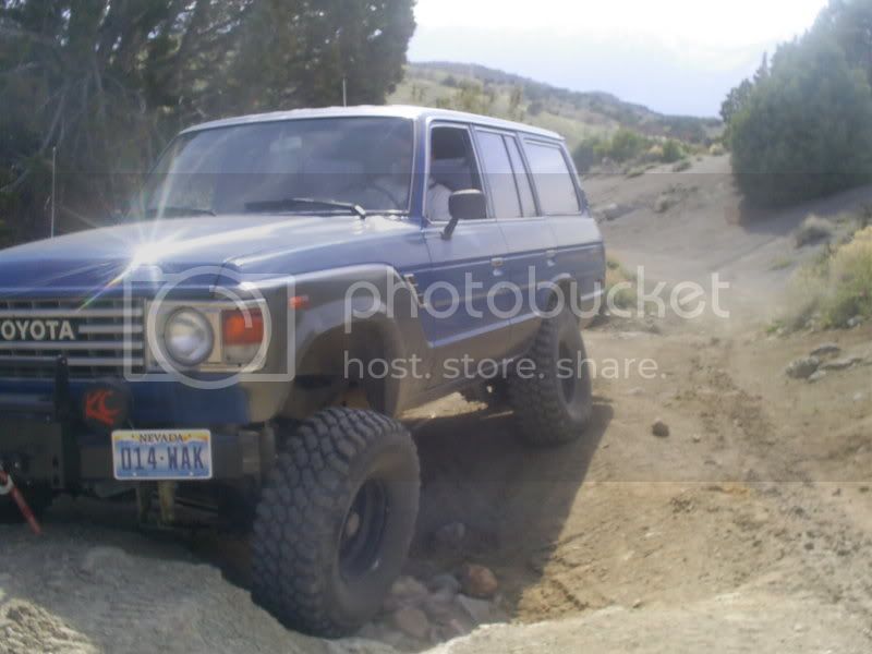

I have Old Man Emu Dakar springs (2.5" advertised) on my truck. I got an econo kit from MAF a few years back before I was on Mud, I would buy them from Cruiser Outfitters now. Absolutely loved them when I first got them, but I need to put a bit of work into them again. The inserts in the eyes of the springs worked loose and my temporary fix is starting to fail. A little attention with a welder should fix that up permanent when I pull them off to add an extra leaf to the front end (bullbar and winch on front but no bumper on the back leads to serious stinkbug stance).
If I were to do it again, I think I would do some research on the add-a-leaf option first. If that didn't look good, I'd go OME again but tack the inserts before installing them.
