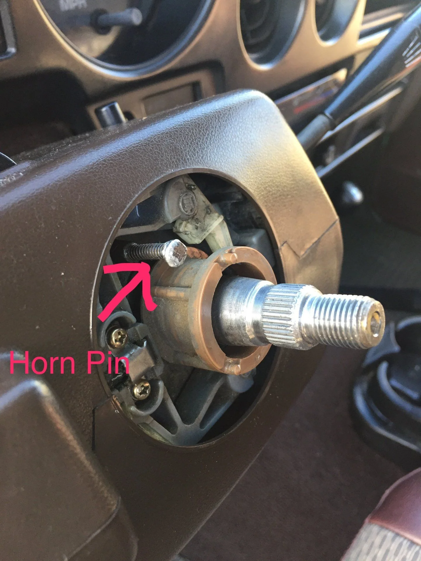

3) Pull off all the plastic around the steering column and get to the Horn contact pin.
In this shot all the plastic is still on the column. After it's off you can axcess the pin. You will need to take apart the turn signal, lights part off the column. Not very tough.

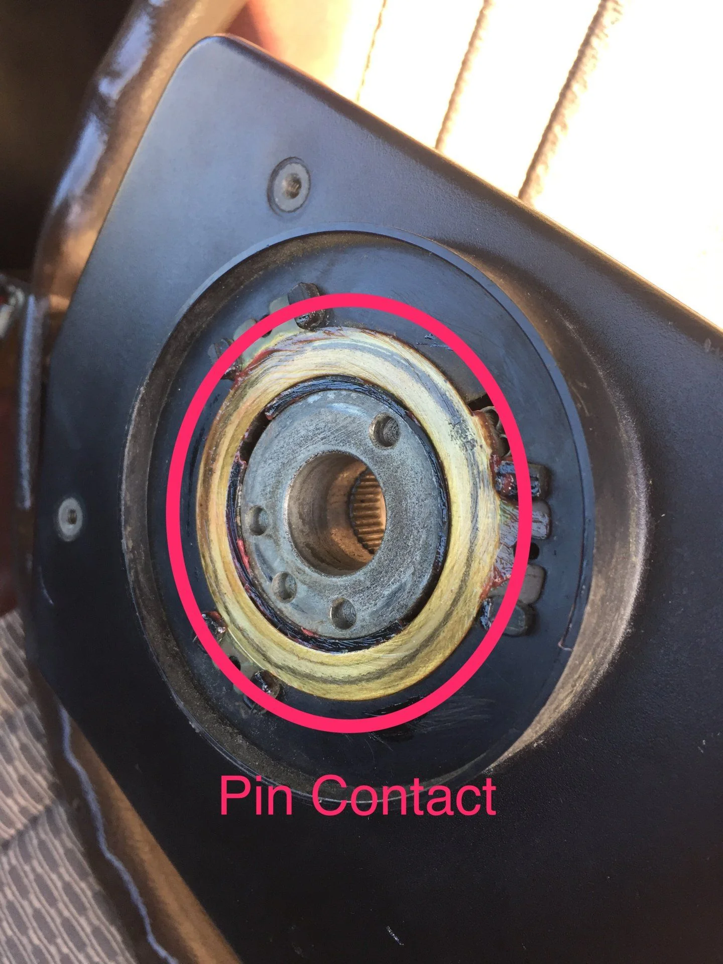

Here is the back of the steering wheel were the pin needs to contact.
4) You can either find a new pin, have one made by a machine shop or add a big glob of solder it to the pin. I added solder and put a little grease on electrical grease on it.
5) Put everything back together. It's easiest if you mark where the steering wheel should be before you take it apart. I didn't and it took a few times to line it up correctly. The contact of the pin to the plate on the steering wheel will squeak for about a week.

To add to this: lubricate the contact ring on the backside of the steering wheel with a conductive lubricant. After 32 years I decided to change my pin out, assuming it was worn down to nearly nothing, and here's the comparison to the new pin. Yes that was the factory original pin too.

9. Pushed horn contact pin as far as it would go with my left hand to gain access to the circlip.
10. Removed the circlip with needle nose pliers while keeping the pin pressed in.
11. Removed the old worn horn contact pin and spring.
12. Inserted the new contact pin and spring, ensured a snug connection with the electrical wire, then added the new circlip with needle nose pliers.
