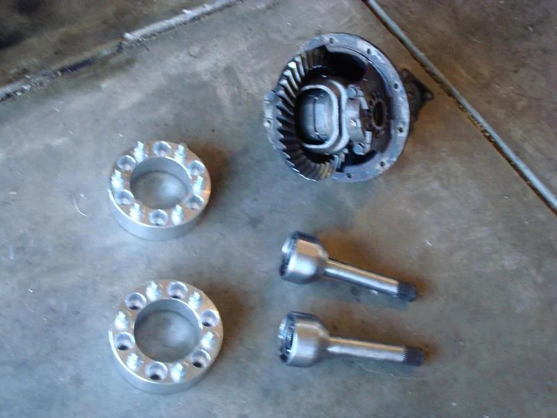

Here are the goodies I got in the mail..
Font diff with Lockrite already installed, Chromo birfs, and 2" spacers for the rear to match the front.

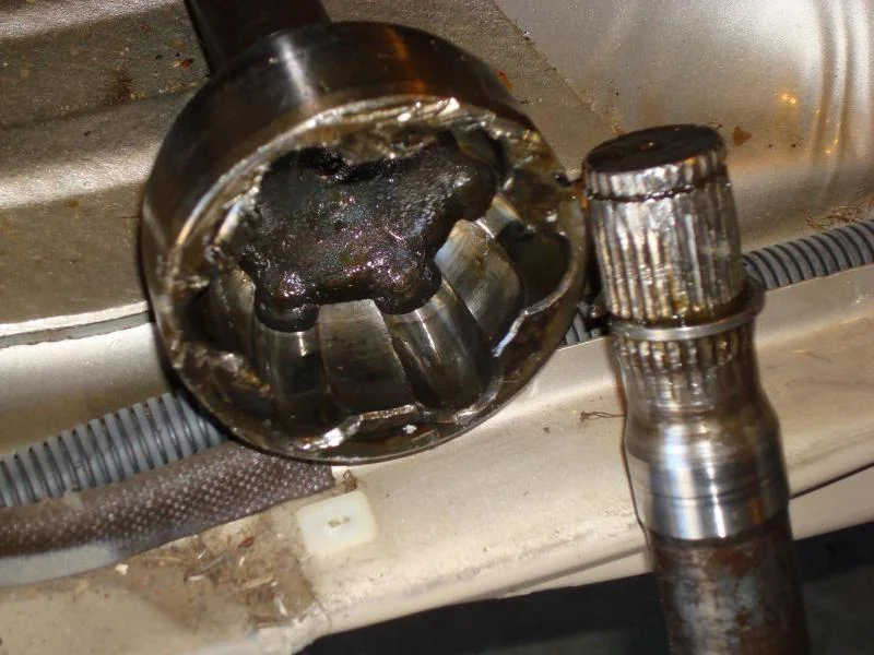

Chromo birfs are to replace this..
As you can see, I managed to break a birf with 31's and an open
diff! Even fragged the splines on the inner. Lucky for me, it was
long side, and I have a few from Mini's that were given to me by
friends who I installed 30 splines for in my garage.:beer:

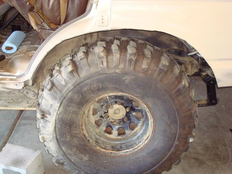

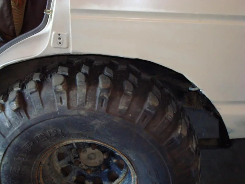

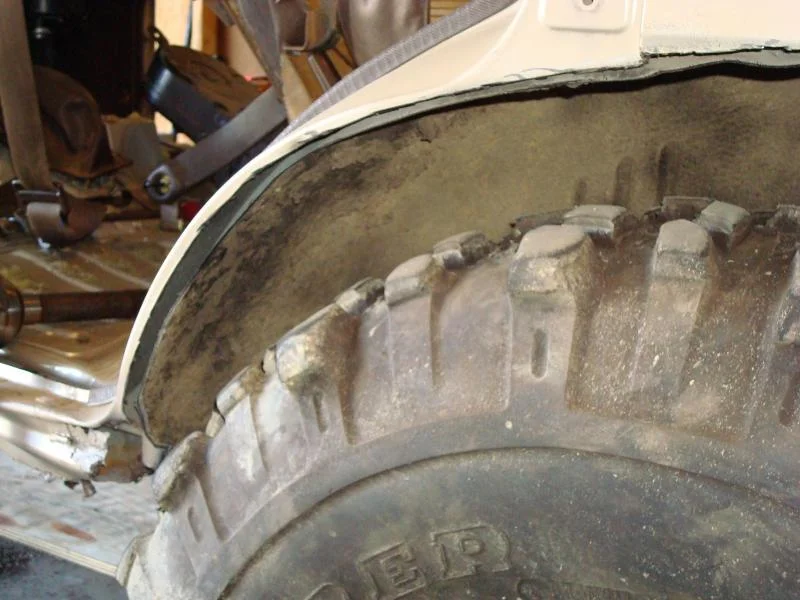

Here are some rear wheelwell trimming pics for those who asked...
Obviously not done yet. Will go higher if i need to after some flex testing. There is ~ 400 lbs of scap metal in the bed in these pics, so it is not quite @ ride height.
And I def. gotta move that fuel pump wiring.
before you bolt that all up ck the flange on that drop out looks like a small flange I think your 62 is also a round flange like my 60 so the bolt pattern if not correct ... I found out after I bolted the whole front back together:bang:
the locker can be swaped over if it not the same flange ... also it makes it a corse spline drop out
p.s. I like the cut swapers :cheers:
Good eye, its from an FJ40. I got the drivesahft end too, so i'll use that for now, and swap locker over when I re-gear.
