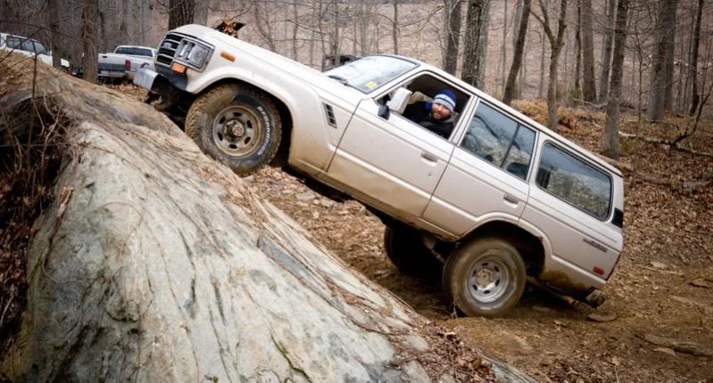

    Everyone loves pics, so I will start there:
    First trip out was fun (stock) 31" A/T's:
    [​IMG]
    [​IMG]

    Starting with an 88 Toyota Landcruiser FJ62. Completely stock, with the exception of 31 BFG A/T's. Only 160k, even has cold A/C! Got it very cheap due to the rust and dents. The frame is a little rough, but more on that later.
    So far, the only mods have been removing the saybars, welded the rear diff. I bought a complete front third with a lockrite for 200 baloneyskins, just gotta get it here from Roxboro somehow. I have a very good friend who is a welder/fabricator, and we are gonna try making our own welded ring birfields, like the original longs. We will see what happens.
