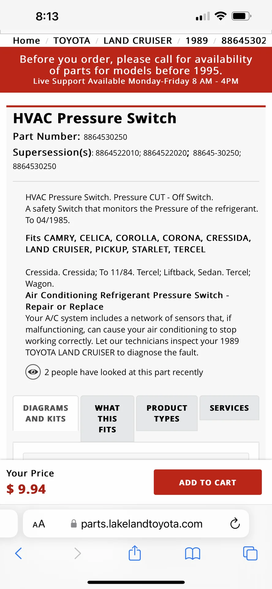

He suggested I may need a new low pressure switch but before I go replacing another part I was hoping to get some input from you guys. Does a faulty low pressure switch seem like a possible culprit? Can the low pressure switch be changed without affecting the charge in the system (I.e. is this something I can do myself pretty easily)? Also is the part listed below correct? Thanks!
