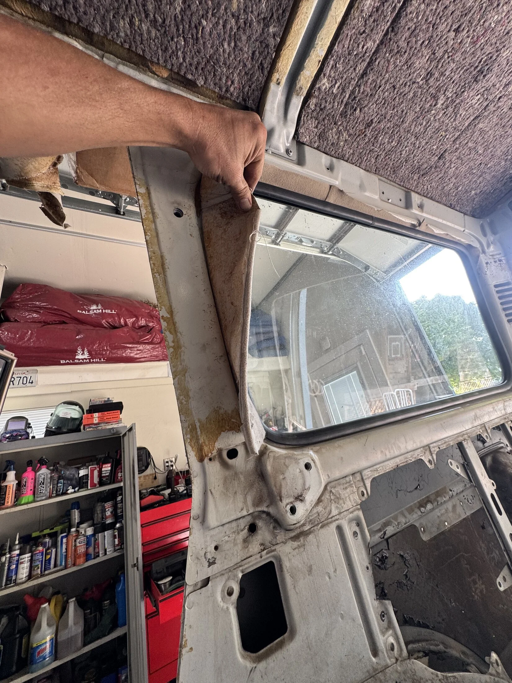

So knee deep in my resto on my 60 and want to up grade to 62 rear belts and also just get good quality new seat belts all around.
I have an 84 and it seems to have the bolt hole/nut on the C pillar for the shoulder belt, Is there anything I need to modify in order to have rear shoulder belts?

The piece of the puzzle I'm not sure about is mounting the retractors. I've seen some posts on here where there's no mounting point, or the sheet metal is different than on the later trucks that came with the second row 3-point harnesses. I'm also not sure if the stock 62 plastic covers will fit over the SBP retractors. I've seen some photos on here where people hack up the body work to recess the retractors and I may do the same. I may draw up a little adapter bracket in CAD that acts as a mounting plate and recesses into a hole I cut, just to make it a little more organized looking. That's the only thing that might be a can of worms, other than the upholstery which has been finicky but not difficult.

Thank you for all the input. I didn't realize that I would need to cut the body to fit the retractor. Going to have to do some figuring.

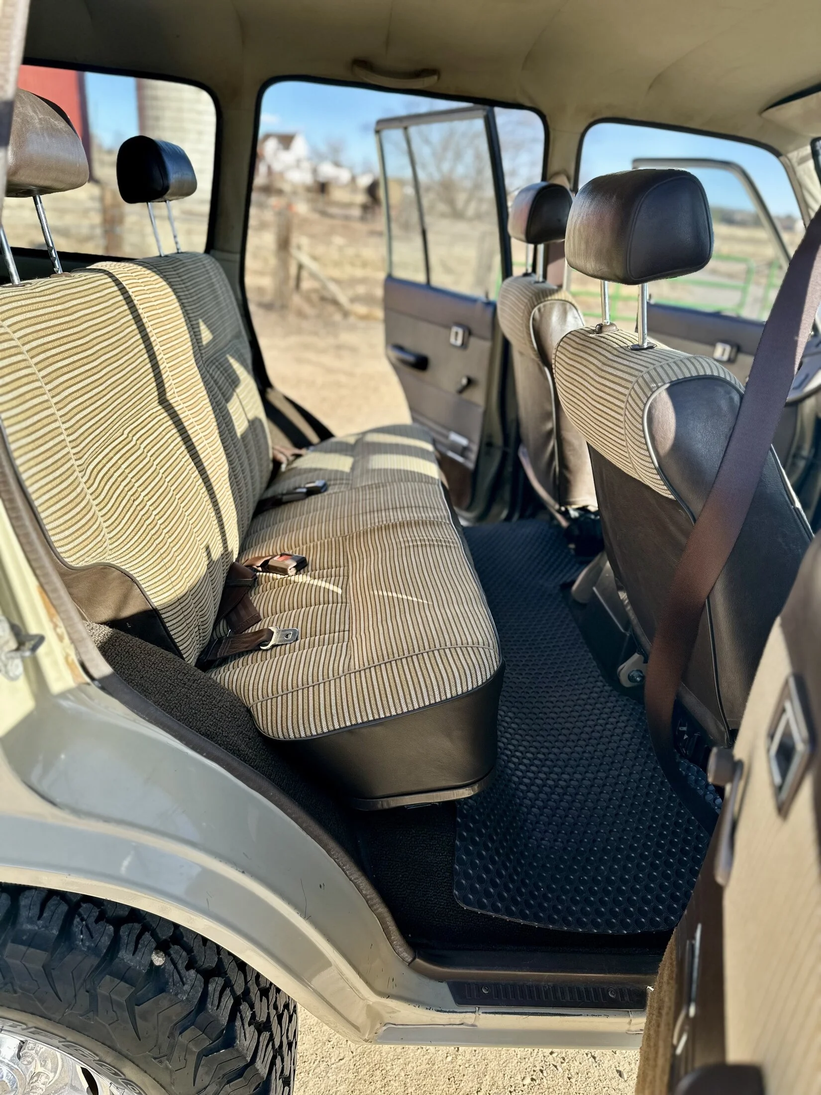

I did what @CruiserTrash did and have a 62 seat back in my 60 so could have headrests back there. Nice upgrade, especially when the kids are riding back there.
