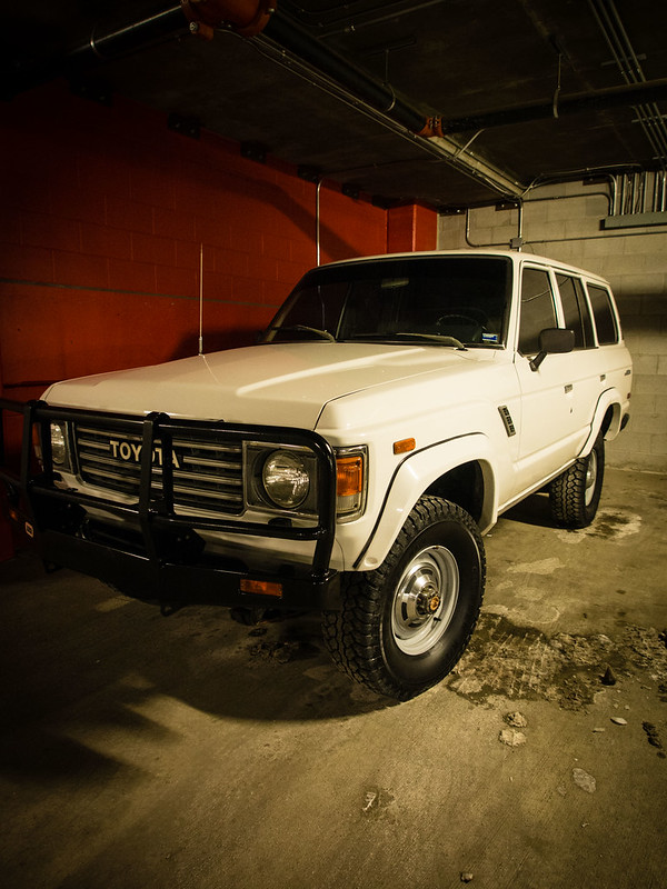

I'm currently looking to replace my ARB bull bar with a simpler, possibly stock, front bumper. The ARB is a bit much for my 60 at the moment, as Its more of a cruisin/camping rig.
What front bumpers are available for the 60 these days? I remember seeing an aftermarket, black, stock bumper design. I've searched but I cant seem to find who sells these.
I also think the ARB bumpers are too heavy for what they do. Possible problem with the stock front bumper is that you can't really use a high-lift jack on it without denting it. I use an adapter in the spring mounts for this..
I'm not aware of any "low profile" aftermarket bumpers...I like the 4+ products...but if you don't like what you have then I expect you would not like the 4+ either, but thats just my assumption. I have the 4+ bumper and I like it. I would keep what you have...given lack of alternatives.
The OEM bumper really doesn't hold up to any sort of "bump," so unless the ARB really rubs you the wrong way, I would just leave it on there.
I also have a 4+ and i really like it. It's a little more "low profile" than the ARB, but if you're looking for a stock look, it still probably wont be what you're looking for.
If you really hate the look, you could cut off the radiator/headlight guards and just leave the bumper bare. It would still be about 20x stronger than stock replacement.

Thanks for the replies, I'll probably fabricate something as suggested. I'm in no rush... It's also not about hating the look of the ARB. I think its the best looking bull bar out there. However, a bull bar just doesn't serve any purpose to me in a non-rural setting, which is where most of my driving is done.
