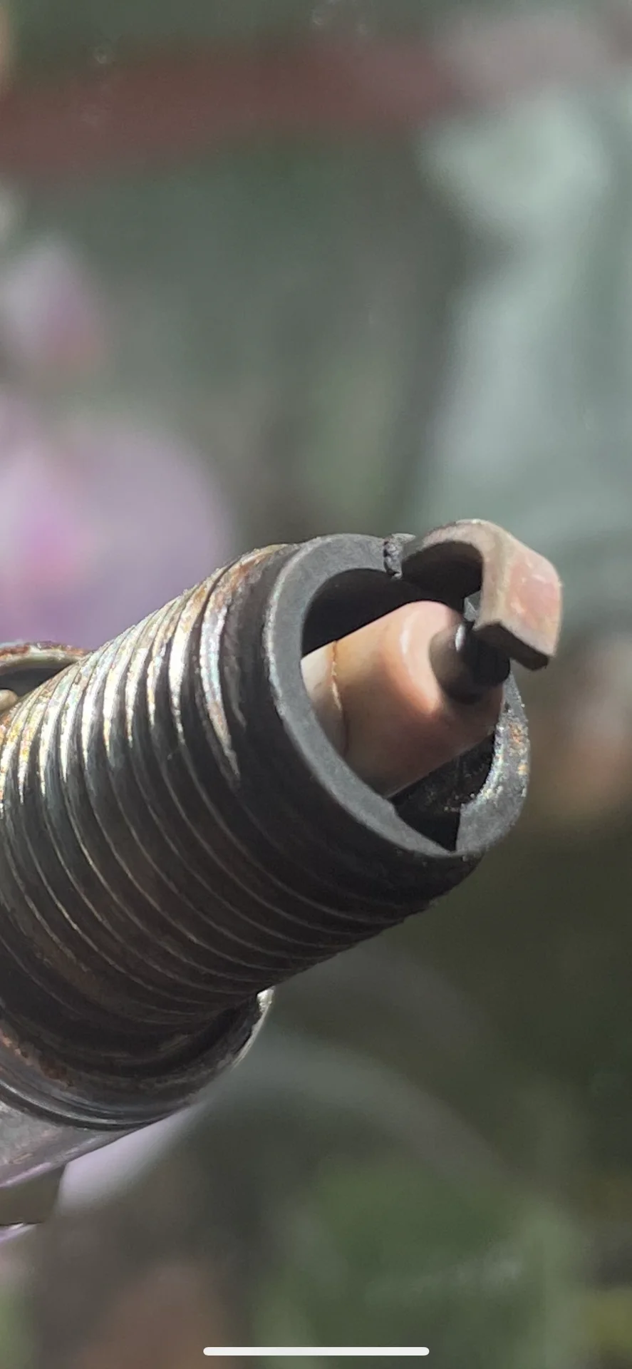

Cylinder 3 is misfiring during warmup consistently. I’ll start it up in the garage (climate controlled 70 degrees) and the idle is really rough. I isolated it to cylinder 3 by pulling plug wires until it didn’t change the engine speed/noise. Next I pulled the #3 plug, which looks ok and similar to others. Compression was 110. While I was at it, I went ahead and checked compression across all cylinders: 110-120. Vac during warmup oscillates between 117-119, ticking down during the misfire for #3. After 5-10 minutes it purrs and vac stays at 19 solid. Cylinder 3 no longer misfires.

If pulling a spark plug wire makes no difference- the misfire is ignition based — and the problem is downstream of the coil.
Try replacing the distributor cap and rotor and replace spark plug wire #3 to rule it out - and of course spark plug #3.
See if that does something.

Thanks @OSS. Problem fixed. Cracked ceramic around the spark plug.
