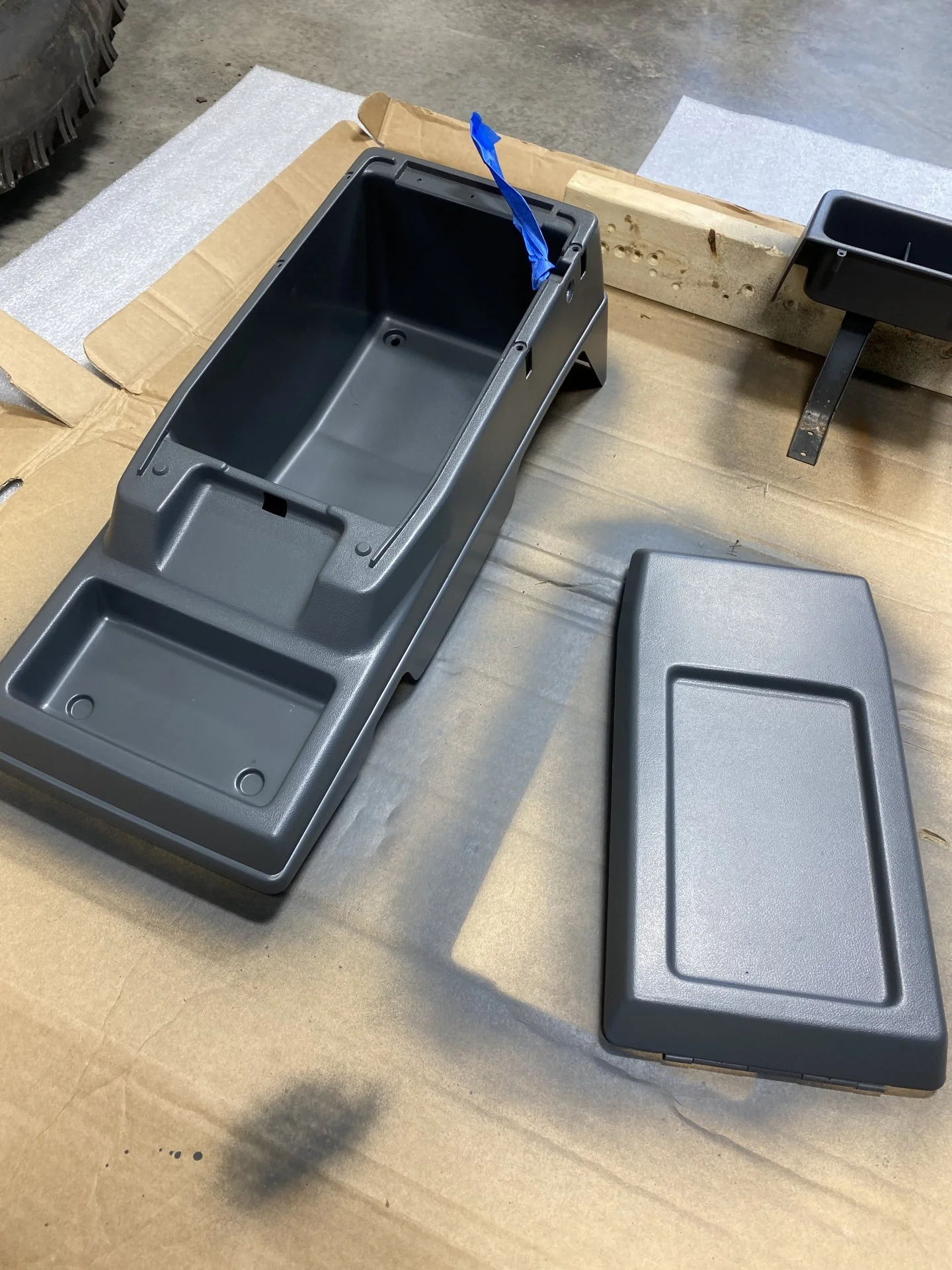

So who had painted their hard panels? I am looking for a close color match to the original.
I believe SEM 15303 Graphite is as close as I will get, but does any one know?
Painting the panels is the easy part if i have the right paint (yes there is prep and a special vinyl softening pre coat)
I painted my panels in my old Chevelle when i had it and it worked very well.

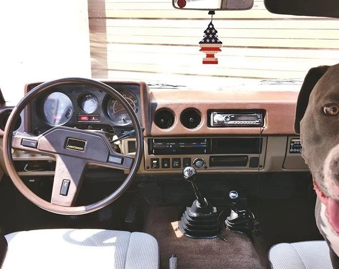

I re painted my instrument cluster, ash tray and the black around the climate controls with that paint, it refreshens the interior and is really easy. Also repainted all the brown parts with some paint that cruiser corps had. Haven't seen any beige paints that could match well. Can't tell well from the pic but two hours work made the interior look new
I've tried it. It's a bit lighter than factory color but is the closest I've seen. However, if something is right up next to the stock trim you will be able to see a difference.
Second the motion for SEM Graphite. Pretty much identical.
