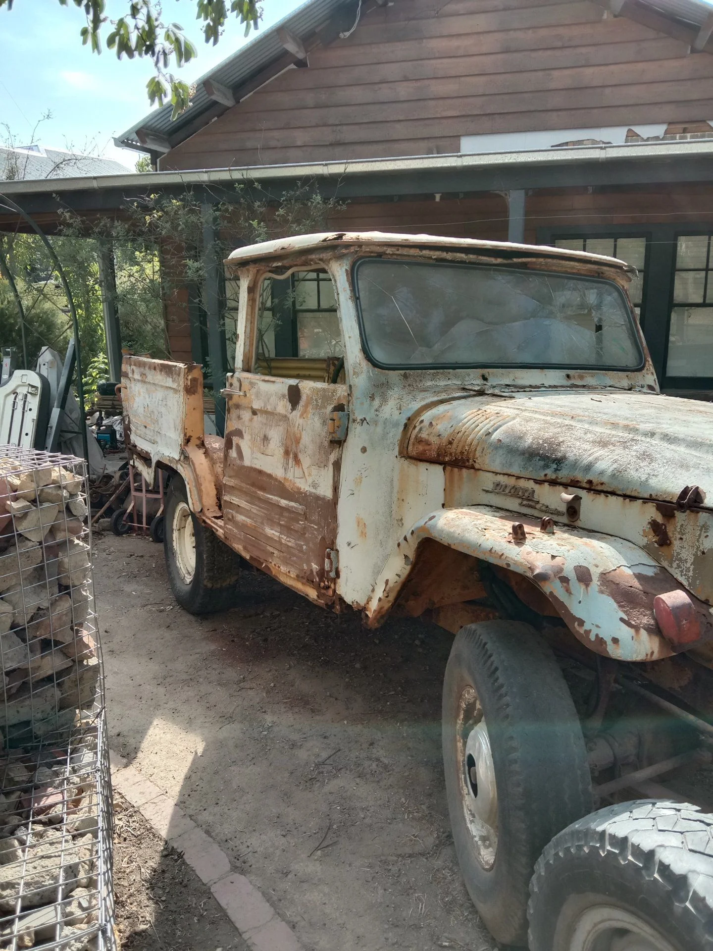

Thanks sneaky ill check it out. I've seen Paul Reads conversion. Still it may not work on a 45V as the dash is a bit different. definitely 80 booster is the way to go. i have a spare later firewall so who knows it might get a run on the other 45V, basket case ute project...
