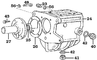

hi just bought an old fj45 for the farm in the process of changing all the fluids. but stuck on finding the filler bolt for the gearbox oil. i found the bolts to release the oil but not the refill. if any one can help send a picture would be the best thanks hope some one can help.

What year? This is an exploded view of a 1963-1973 3 speed, see where bolt #40 attaches, that is the fill hole.
Ive always pulled the shifter and filled the tranny thru there, and transfercase is in the back of case
