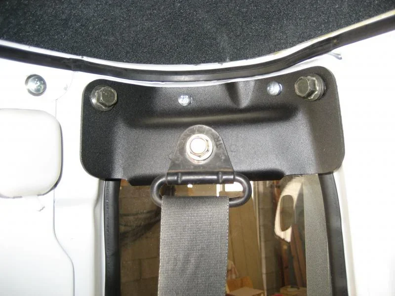

A member who hasn't been on mud for years lives in Germany. He had a 73 FJ45 that had three points seat belts. It had the fixed nut at the top like installed in FJ40 hard tops starting in 1973. US market three point seat belts didn't start until 1/76. At least Germany in Europe started in 1973. I was lucky to find a set of the Canadian market only FJ45 seat belt brackets years ago. What is different in Canada was the mount for the retractable section. It was smaller than used with the fixed nut allow the top. It wasn't directly below the bracket at the corner but towards the front. Still mounted to the base of the hard top but angled towards the bracket so it operated smoothly.
Here is what the FJ40 had for the base.
Here is the back side of these brackets to show the reinforcement.
Going have to modify it somehow to fit on the side. Seat back rest against the back of the top interfering with retractable part of the seat belt.

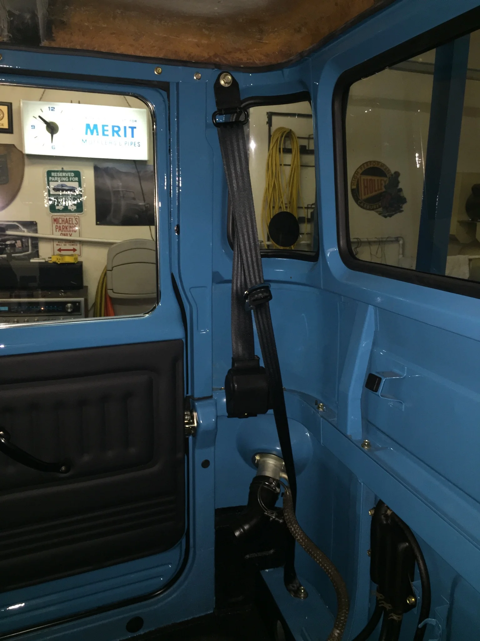

This is my 1978 AUS spec setup. Maybe this will help.
Only thing I see is the belt anchored to the floor should be on the other side of that hose. Other than that that how other than Canada mounted three point belts in the pickup cab. I like the Canadian style better because the anchor is further back at the top. FJ40s the fixed nut is not that close to the B pillar. Not sure if the fixed nut last thru the 83 model but starting with the 73 the FJ40 hard top have the fixed nut. Find rusted 73 hard top sides rust out and cut the raised section off. Drill a hole in the 45 top big enough nut. Clean up edges of the raised and welded on the 45 side.
