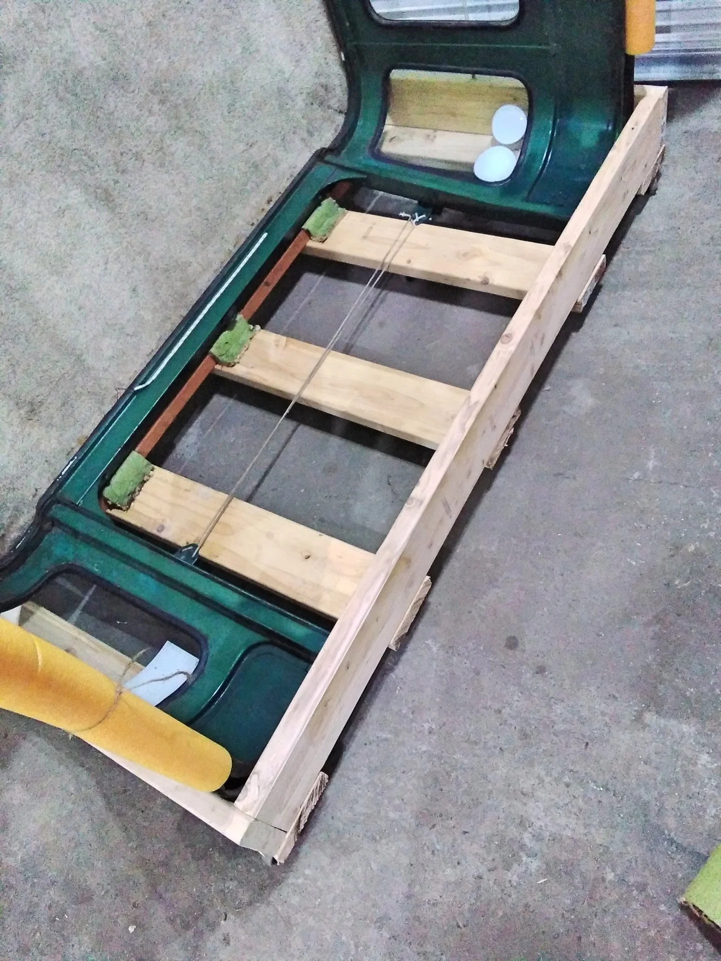

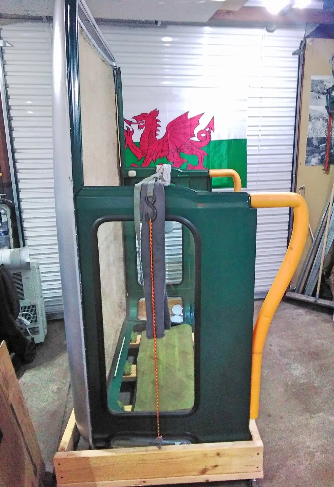

There is a thread where someone made a dolly to hold the top so it could be moved around - wasn't too complicated. I just stored mine up against a wall with old lawn pillows on the bottom to project the top. Didn't take up too much space. The top is heavy - not like a Jeep.
I take mine off and on using this Racor lift from Amazon. Its an easy, one person operation after years of begging friends for help with it. Then I built this very basic dolly to store it during the Summer. Rolls into a corner easily and all doors store inside.

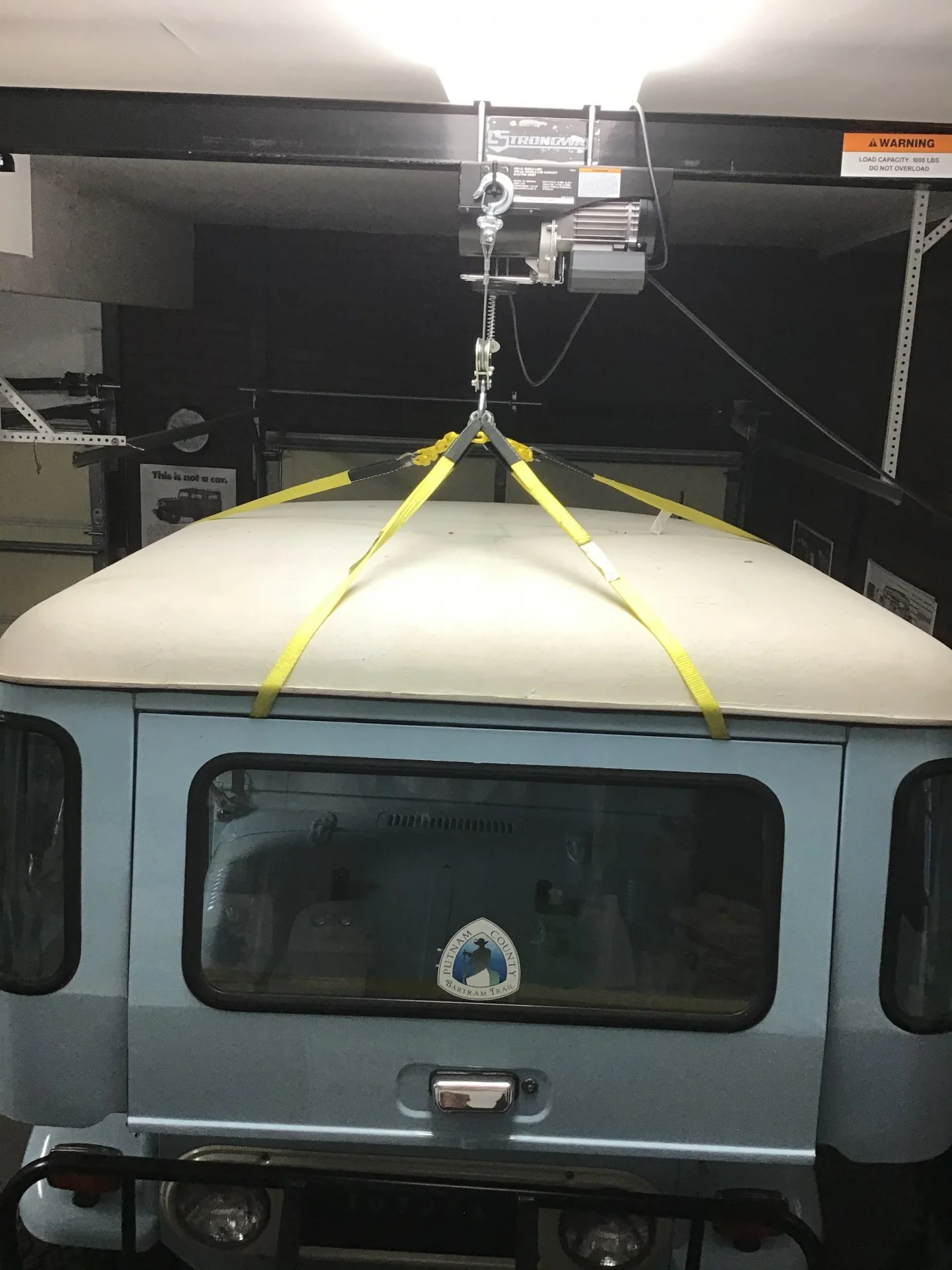

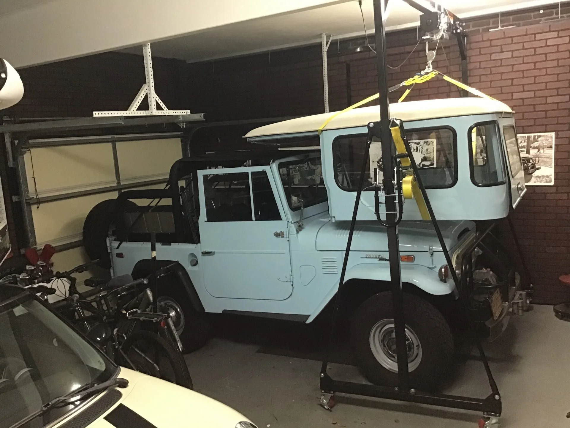

I fabricated a ceiling hoist using pullys, aircraft cable and a hand winch from a boat trailer and it worked fine but I was never comfortable not knowing the load bearing capacity of the ceiling attachment. This winter I bought a rolling gantry and hoist from Northern Tool. I backed in, lifted the roof off then pulled out and back in, front first. The LC fits perfectly under the raised roof so no need to take it down and store it elsewhere. An unexpected bonus was the ability to hang my bike on side of the gantry which freed up some additional floor space. I figure the rolling hoist will come in handy for other lifting when I‘m not using it for the roof.

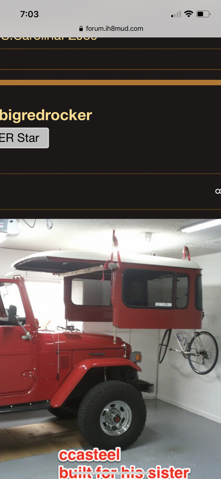

The ratchet straps work okay for lifting the top off. But bringing it back down is a complete pia. Ratchet straps don't generally "ratchet" backwards, they release completely. The picture above is what I did in my sisters garage, and it only got used once. I wouldn't do it again. The link below is what I put in my shop and it's a much better system. I used the racor lift that so many refer to. And then a few rubber coated hooks from the local hardware store. The only change I would make is moving the crank from the side of the top to the back of the top. It would allow the cables to wind up more uniformly.
