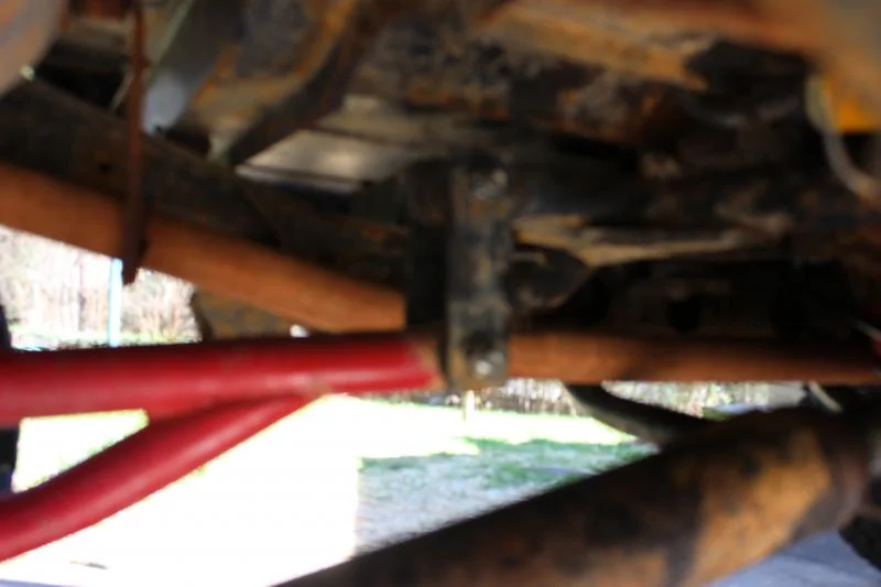

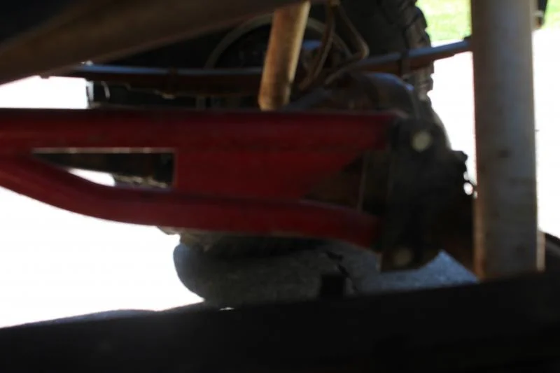

I agree. I'll bet your anti-wrap bar is not allowing your rear end to flex as it should. Post up some pics. IMO, most of them are wrong.

I'll try to get some pictures this week and try to figure out how to get them on the post. Definitely, this problem keeps me from wanting to wheel. Thx for the help.
Finally had a moment to take pictures, sorry a little blurry. These are pictures of my anti-wrap bar setup.
