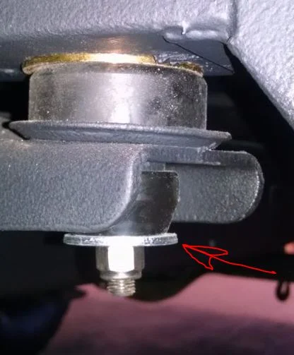

Dave,
All except the front mount just bolted in and it only required a little sanding.
Note the heavy washer on the bottom was not included in the kit and had to be purchased separately.
