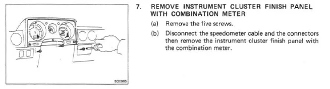

You want someone to give you a step-by-step? Have you tried having a go at it? It's not difficult. In fact in the factory service manual, it's a single step.
Sometimes the best way to learn is to try figuring it out. If you get stuck, people are usually happy to help.
