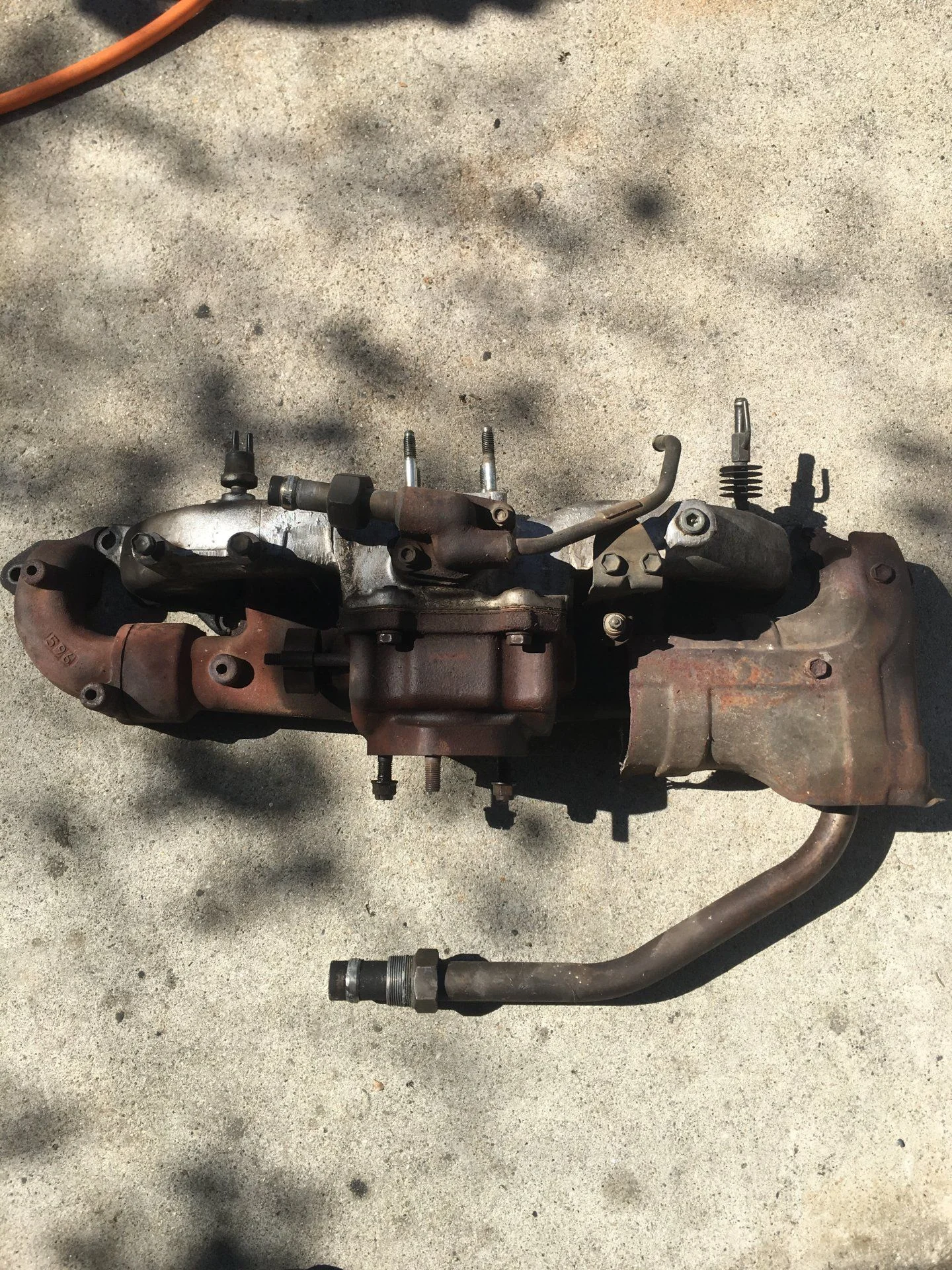

2. Define "Manifold Repair". $711 to have the intake and exhaust manifolds machined flat as a pair sound ludicrously expensive. I picked up matched set from the Mud Classifieds this spring for $200. If your exhaust manifold is cracked/broken just buy a used one.

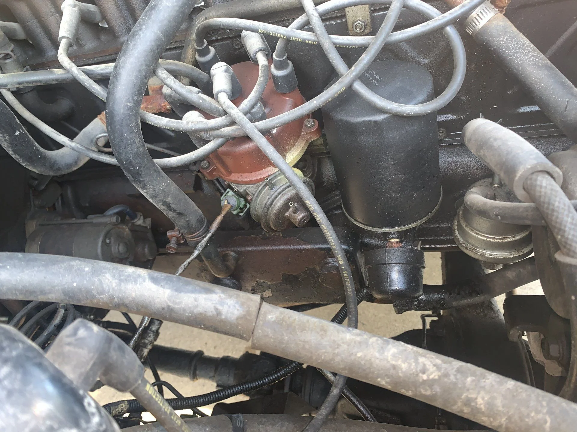

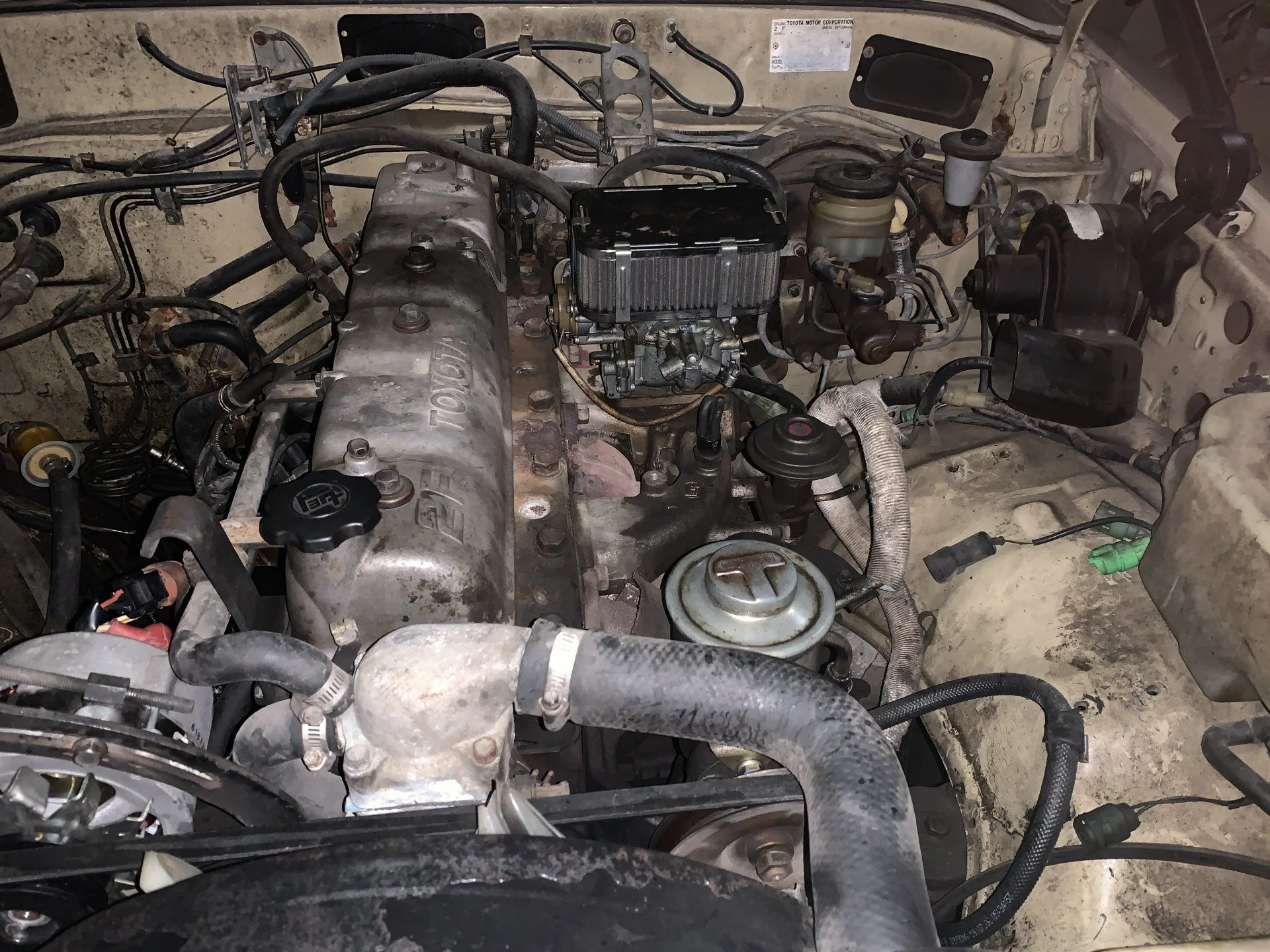

Hose that needs replacing is circled in the photo below.

Its common for these exhaust manifolds to warp over time....and to machine them properly the intake and exhaust have to be machined together....but $700 sounds very high for this work. Edit.... didn't realize this was just reflecting the labor to remove and install at the shop.

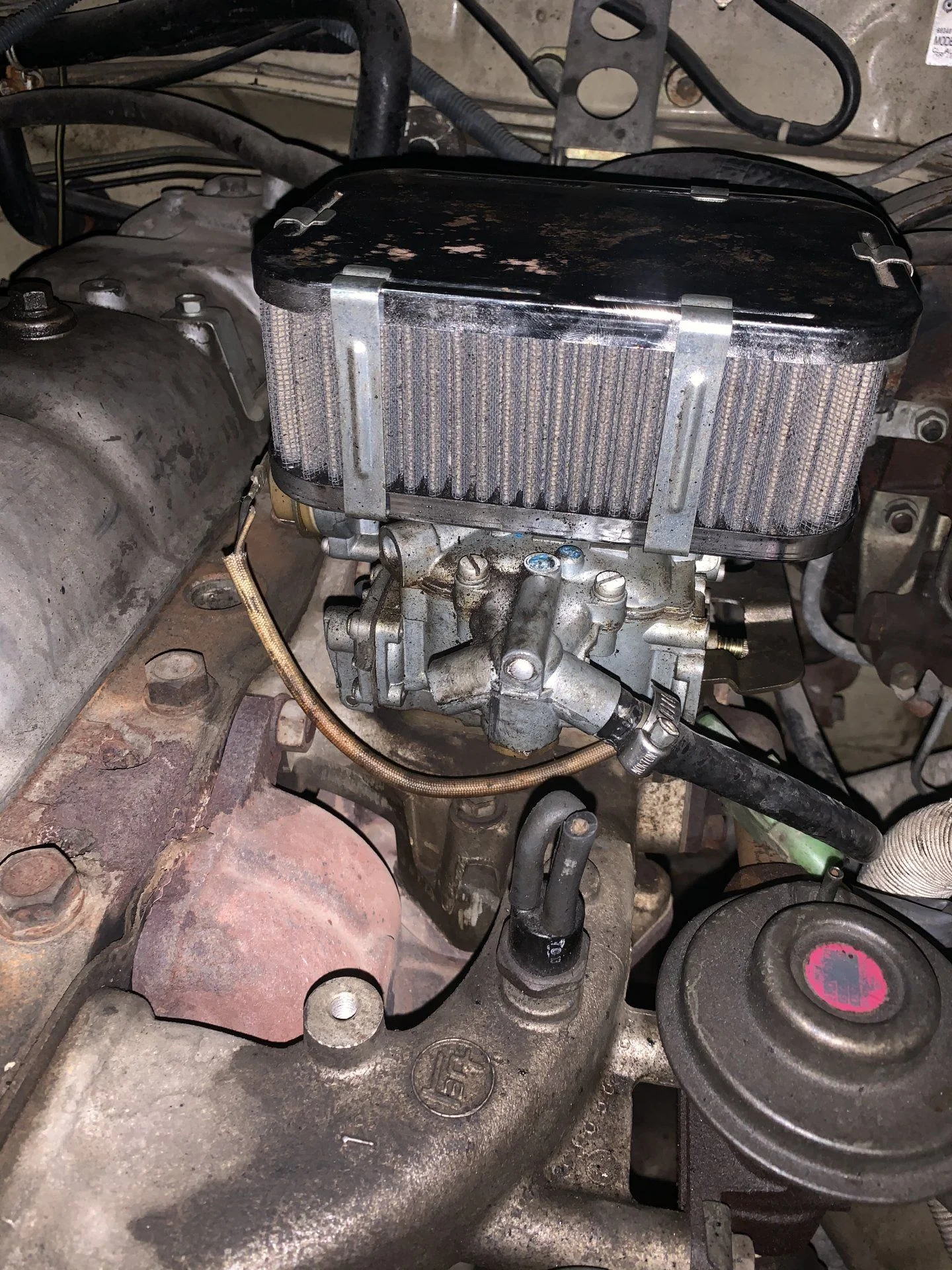

The Tech notes indicate your truck is dieseling - And as noted, will continue to do so even with a rebuild because the Weber does not have a provision for cutting fuel flow when the engine is turned off, like the stock Carb.
He's currently out of stock, but City Racer offers a Japanese Close of the stock carb and it's NEW and cheaper than rebuilding the webbah! And it has the Idle Control Solenoid which is there to stop dieseling....
HOWEVER, to use that carb you need to have the original Rod Linkage, not the cable that's there now. You still have it ?
The link above to the Intake/Exhaust combo is a good price and will allow you to have that one surfaced and rebuilt, then installed to save down time on your vehicle.

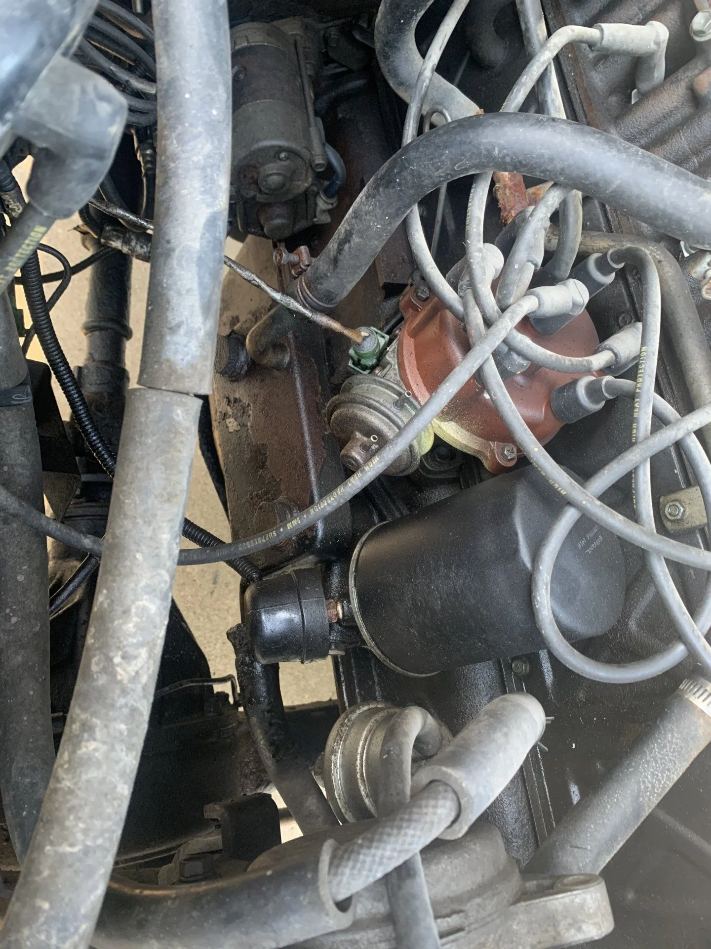

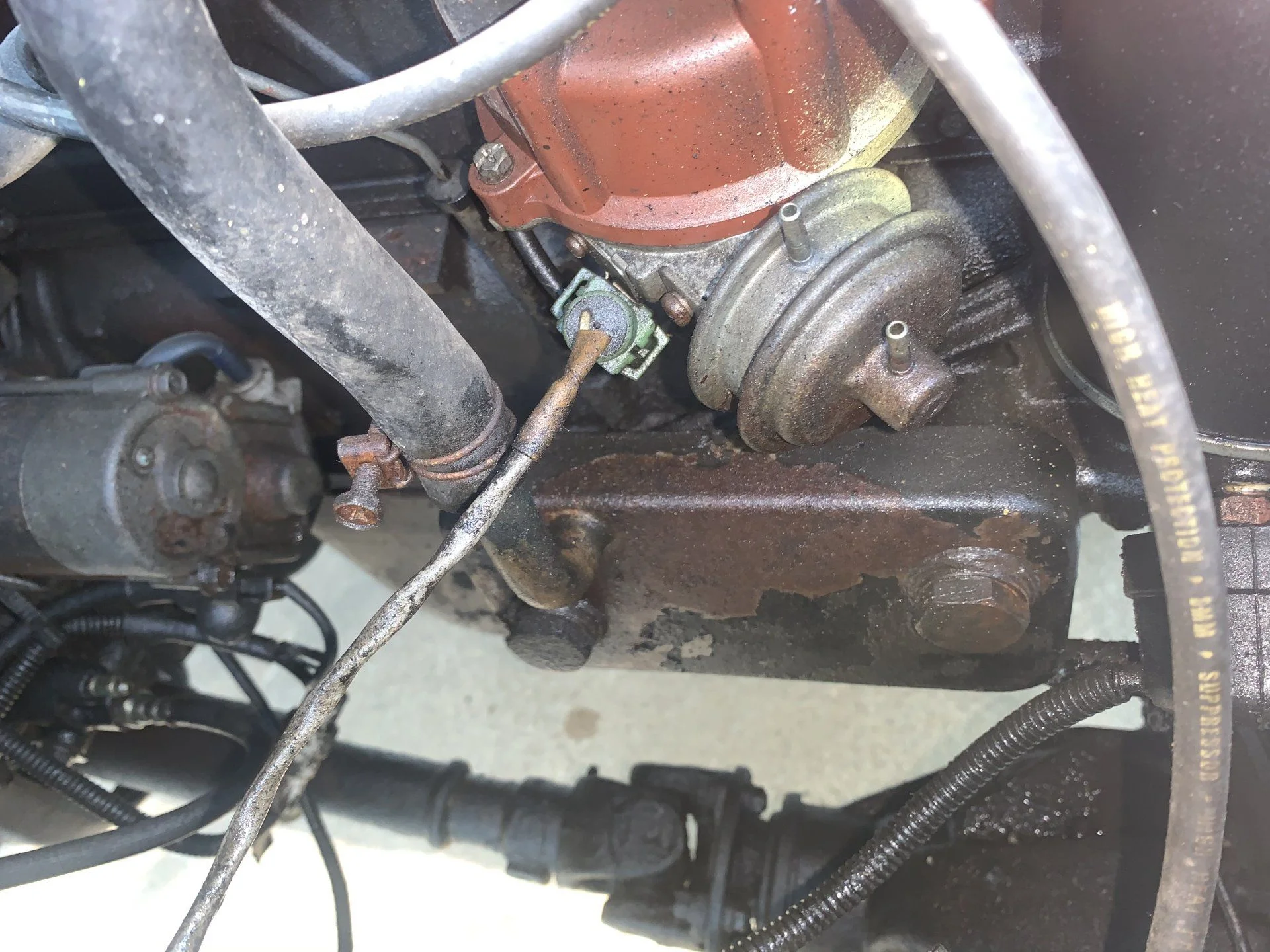

So one further point is that the air injection system has been removed from your truck. Do you have to pass any emission testing where you live? If so then you are going to need a lot of missing pieces to have any chance of passing a sniffer test. If you don't have any emission requirements then you could also remove the whole EGR system and have your distributor curve remapped....FYI Your EGR isnt even operating at this point...its missing vacuum lines currently.
I'm not seeing any vacuum lines. can you post a picture of your distributor?
Well that explains the no-Vacuum line, however the Vac Advancer may not be working ....
