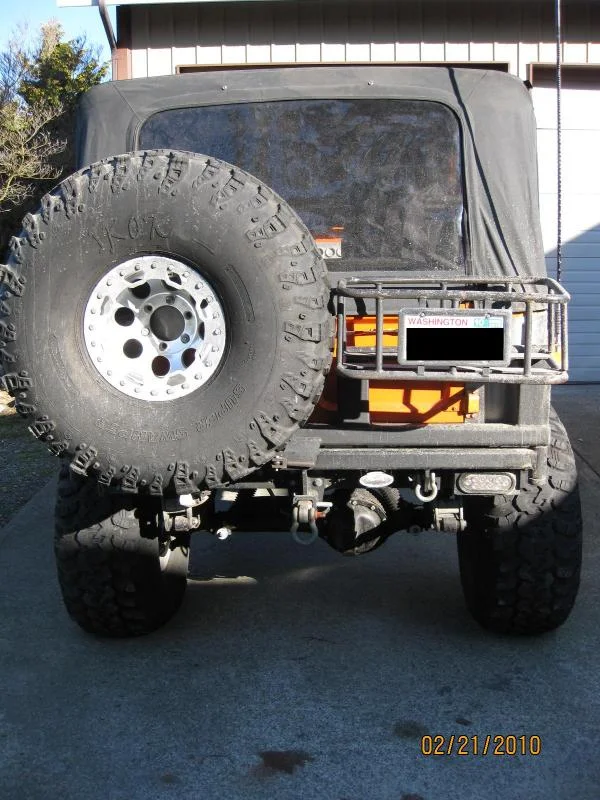

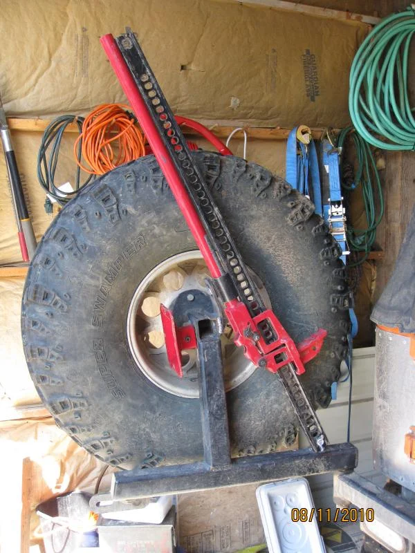

fyi a 40 can be mounted with a cooler/jerry can set up....see pic
