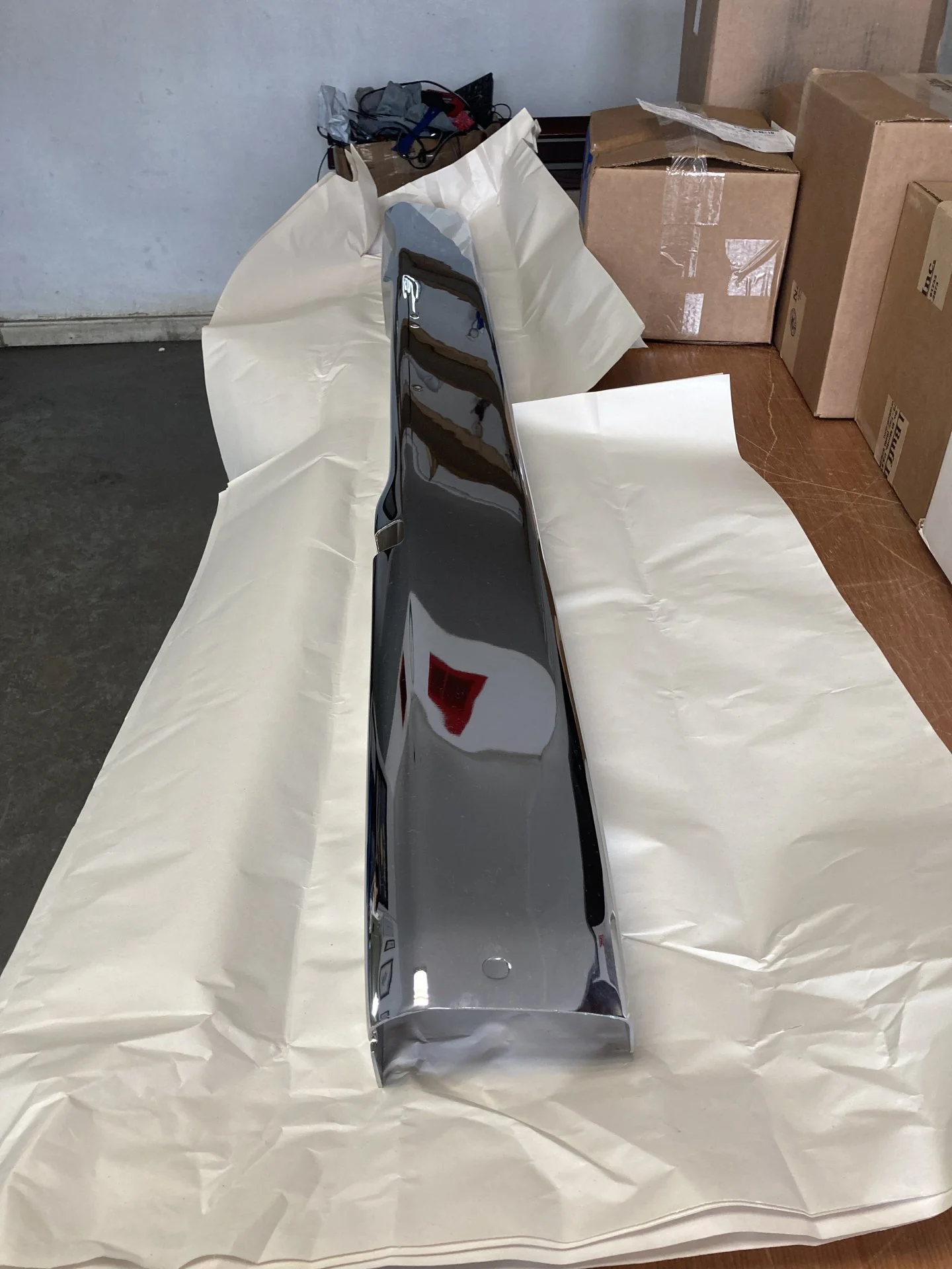

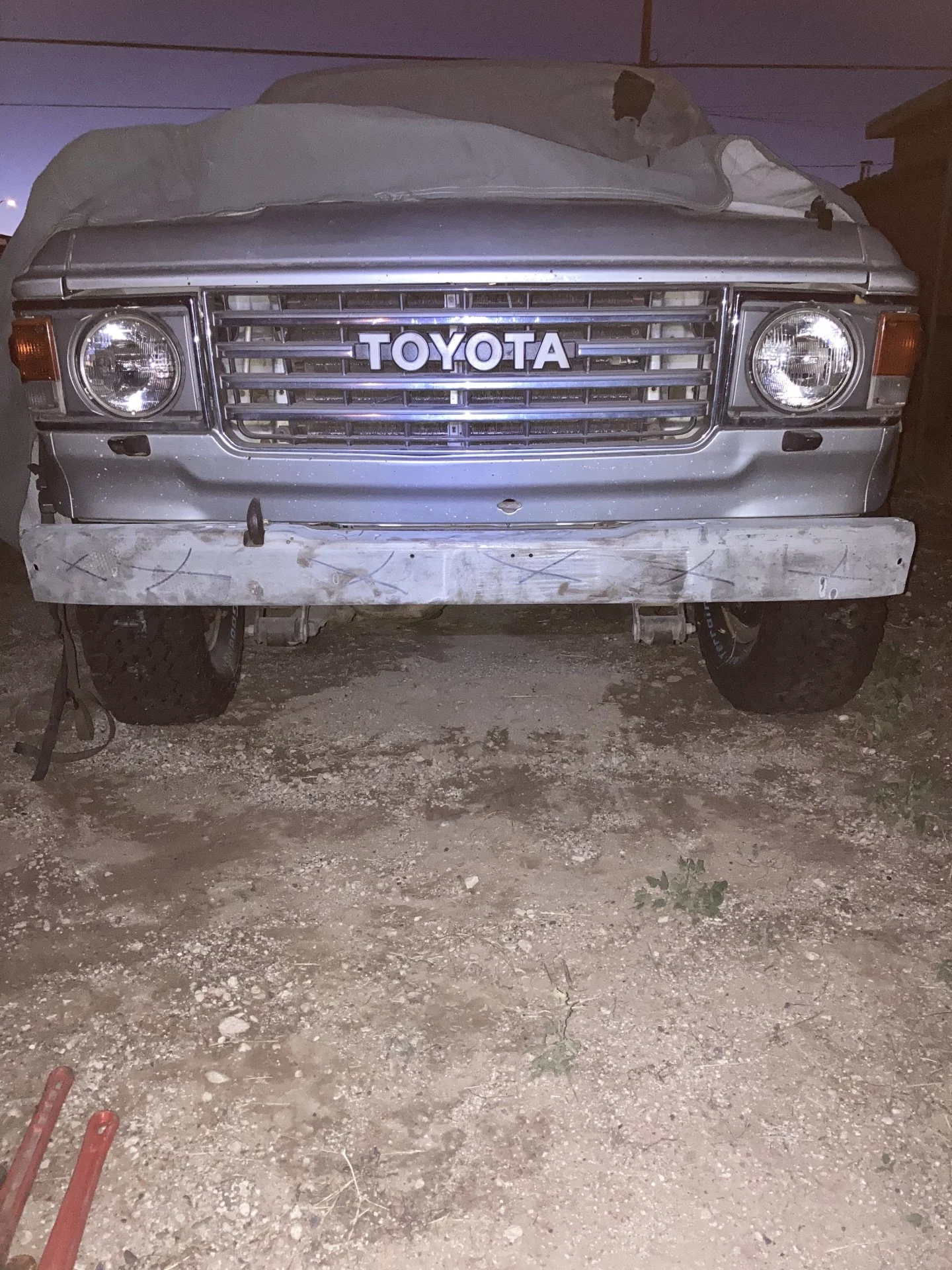

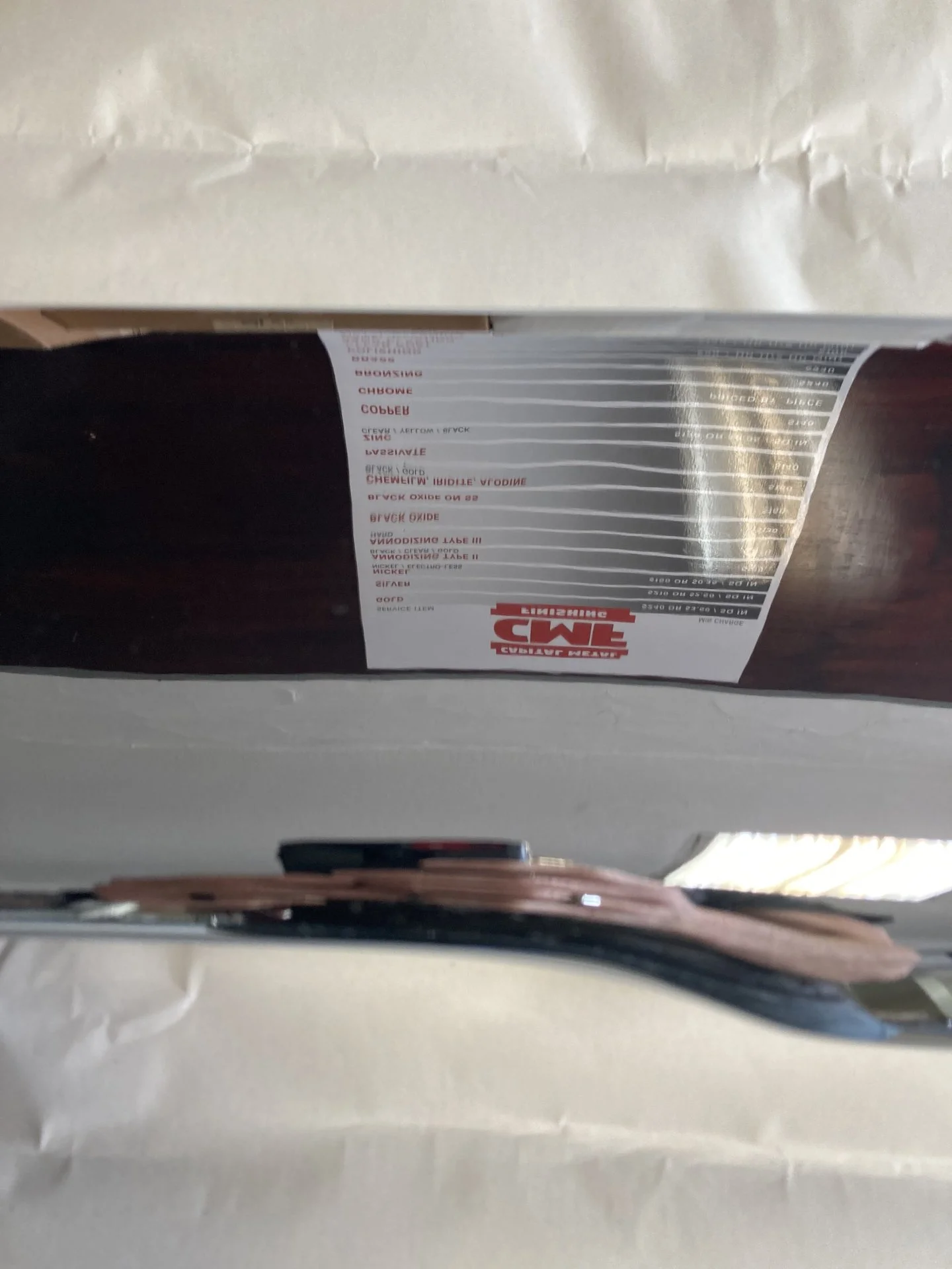

Two after photos and one of the bumper after straightening but before chroming--I was able to/asked to check fit before the chrome went on.

It was like $575 I think. May be a bit more expensive than even a new one—which I think you can find for about $450–but the chrome is honestly maybe thicker than factory. I purchased a new rear bumper because it was more bent up than the front, and I think it was a bit cheaper than the straightening/re-chroming would have been. I think you can find stock rear bumpers for less than $400.
Very nice ,may be better than new one.Last one I had done the guy didn’t triple chrome it so it rusted fairly fast. Mike
