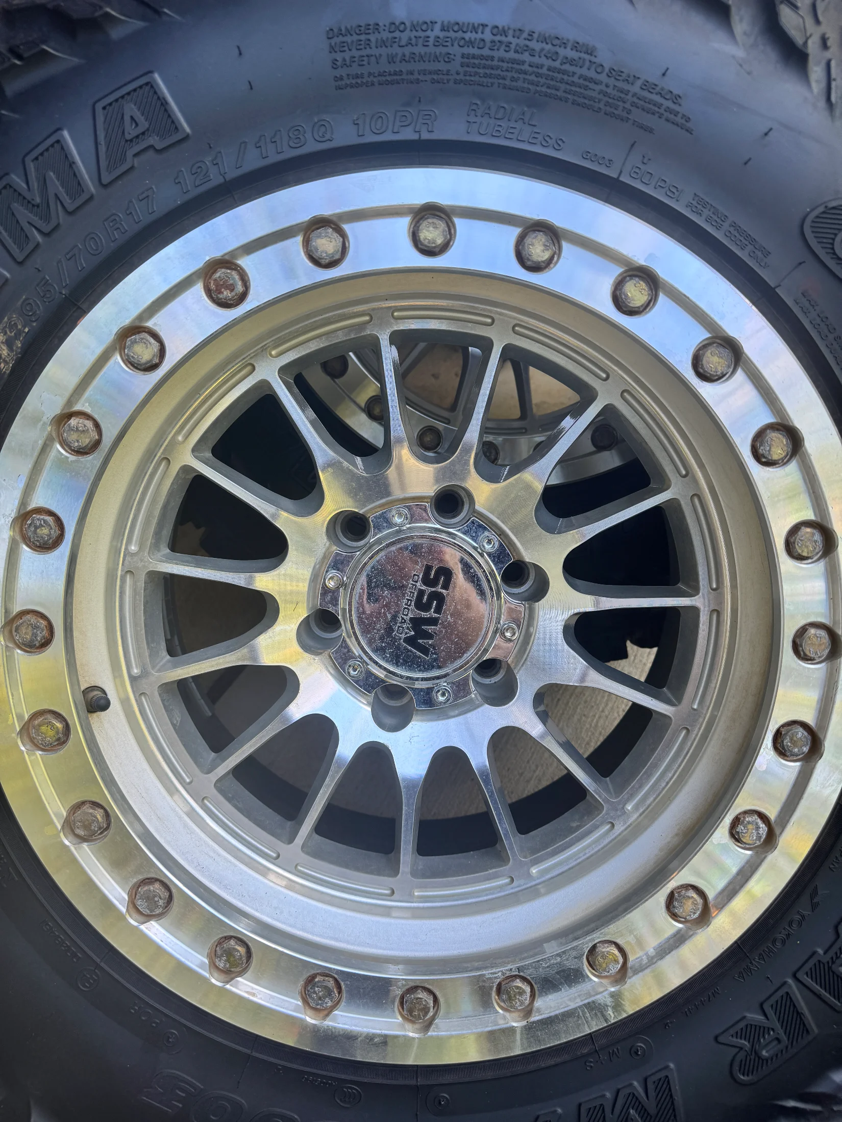

Tried to test fit fuel rebel wheels a while back and they would not fit the hub. Looking to buy a set of SSW Dakar beadlocks today that came off of a 3rd gen 4 runner, quick deal. My 80 isn’t with me so I am unable to measure. Wonder if they’ll fit?
Okay. 108mm wheels are the limit.
106mm wheels will not fit. I know this has been talked about before on here but I feel it is a common mistake made upon 80 series wheel options. Threw it into a fit guide and turns out they will not fit due to hub bore size. Also. If anyone wants a smoking deal on nearly new 17x9 SSW Dakar headlocks on brand new geolander MTs 33s hit me up. Hated to post on here to avoid the sticklers.

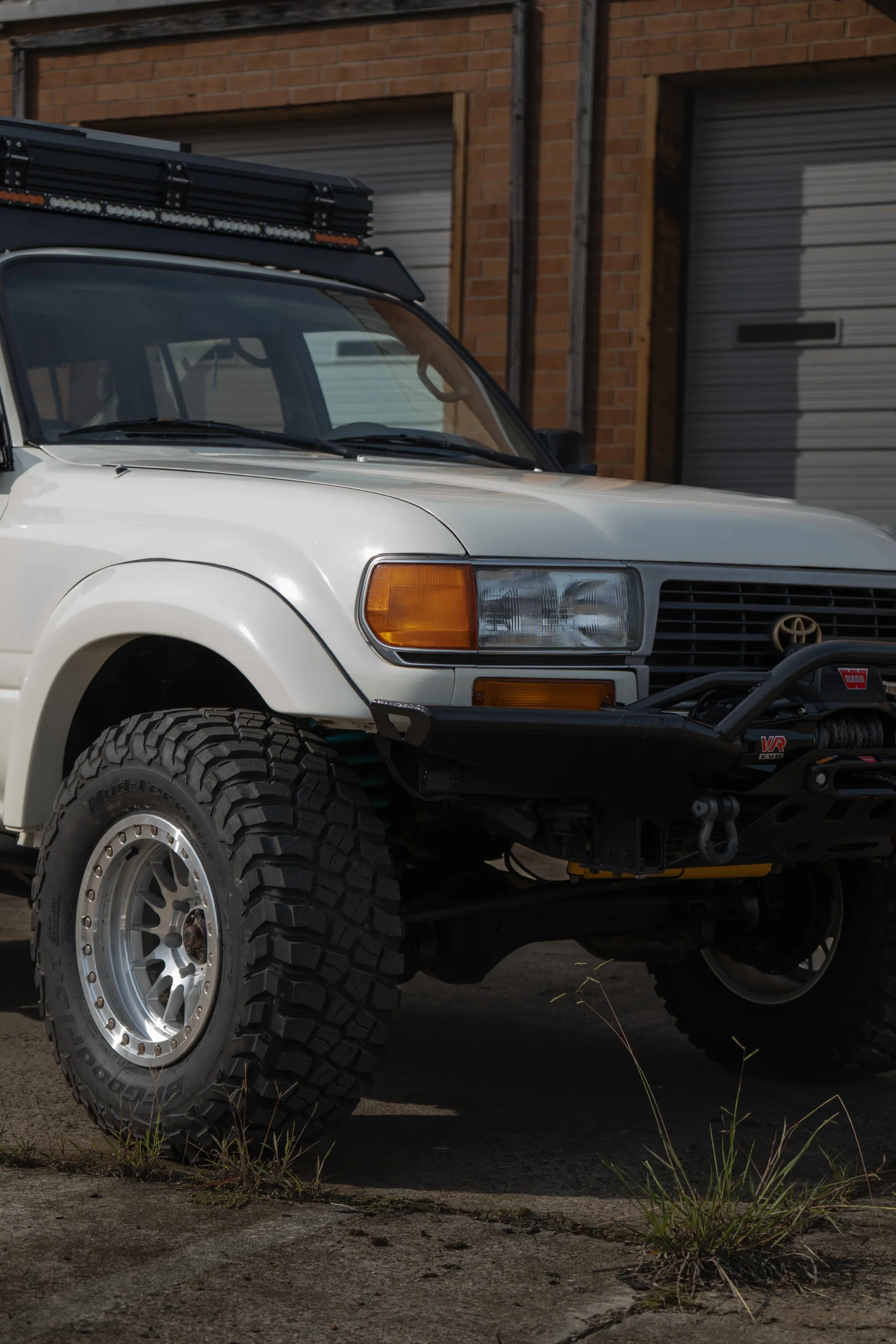

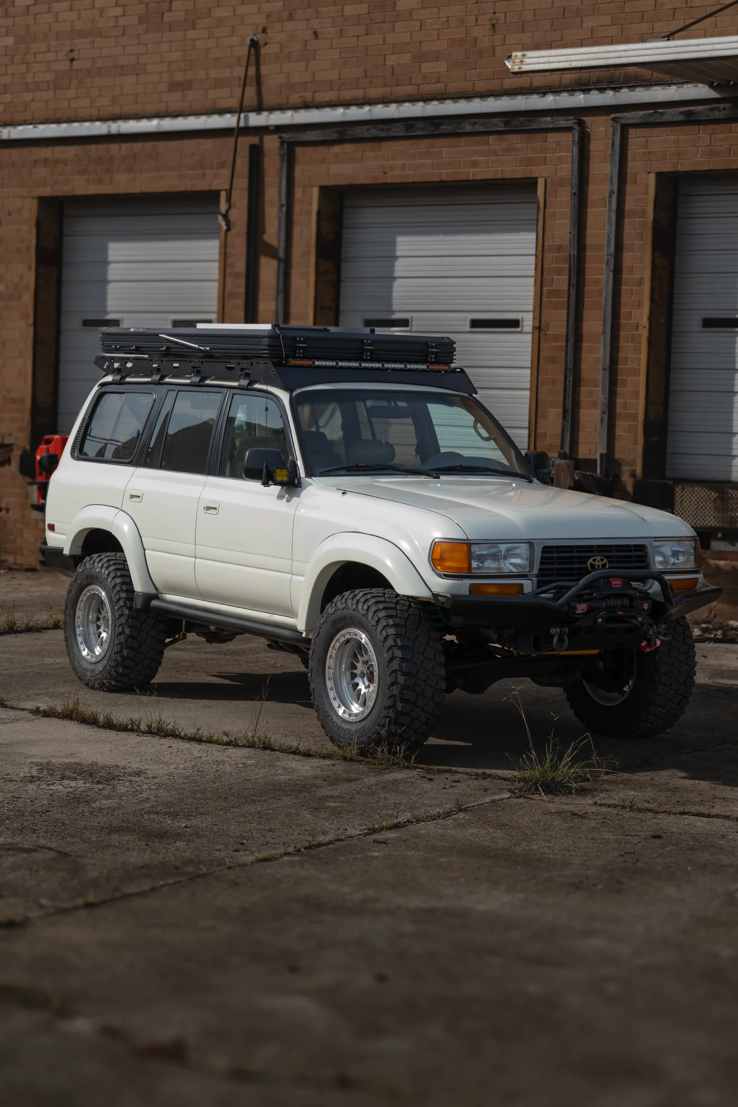

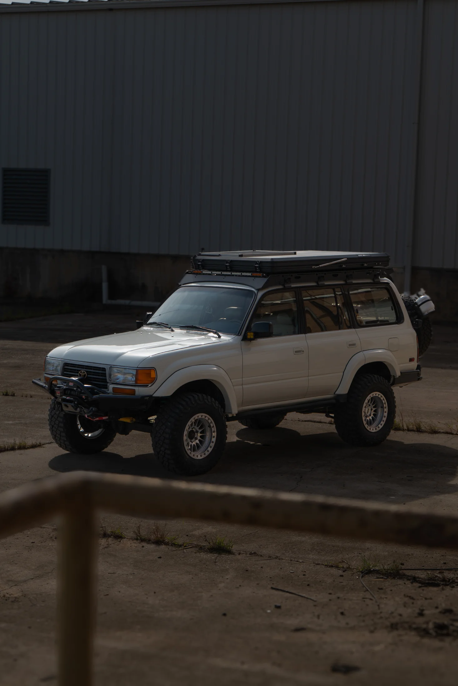

Made 2 extra trips to go get my 80 before I let the deal go, didn’t think they would fit but…they fit! The rear center caps even fit, just not the fronts. -25offset on these. Just threw on some 315 KM3’s. So far. Big fan. 106.1 bore on these wheels, no issues at all
These are the exact wheels I’m looking to get. Let’s see more pics! Is your truck lifted or at stock height?
looks great!
I’ve been eyeing the Griffon and Dakar for a while so maybe we should turn this into an SSW Off-road thread….
I like the look of the Griffon but like the weight of the Dakar better. 🤷‍♂️

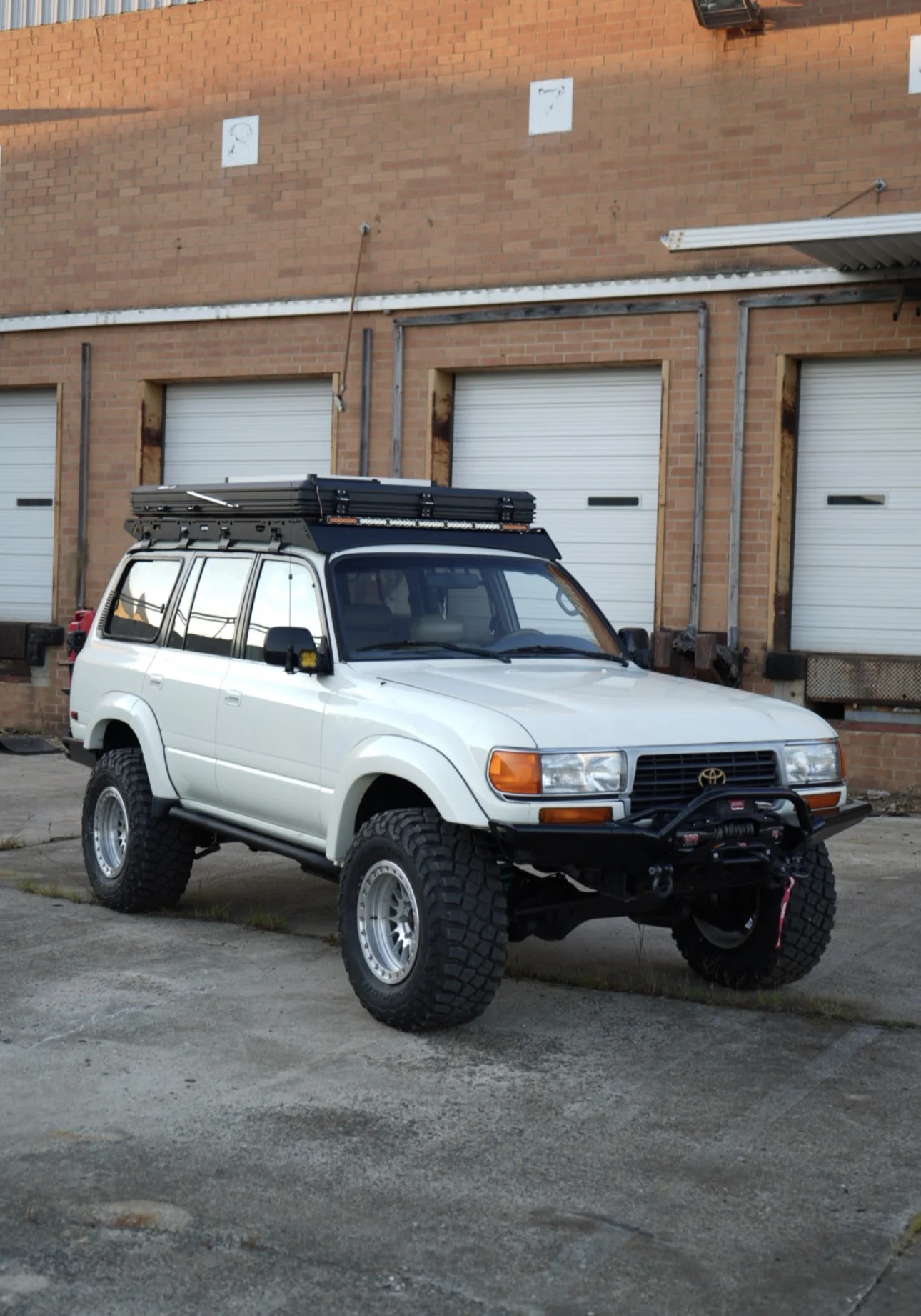

Some more pics I took yesterday, really digging this look. Took some time to get used to it. Kind of a 90s vibe. I’m FzjClay on insta
