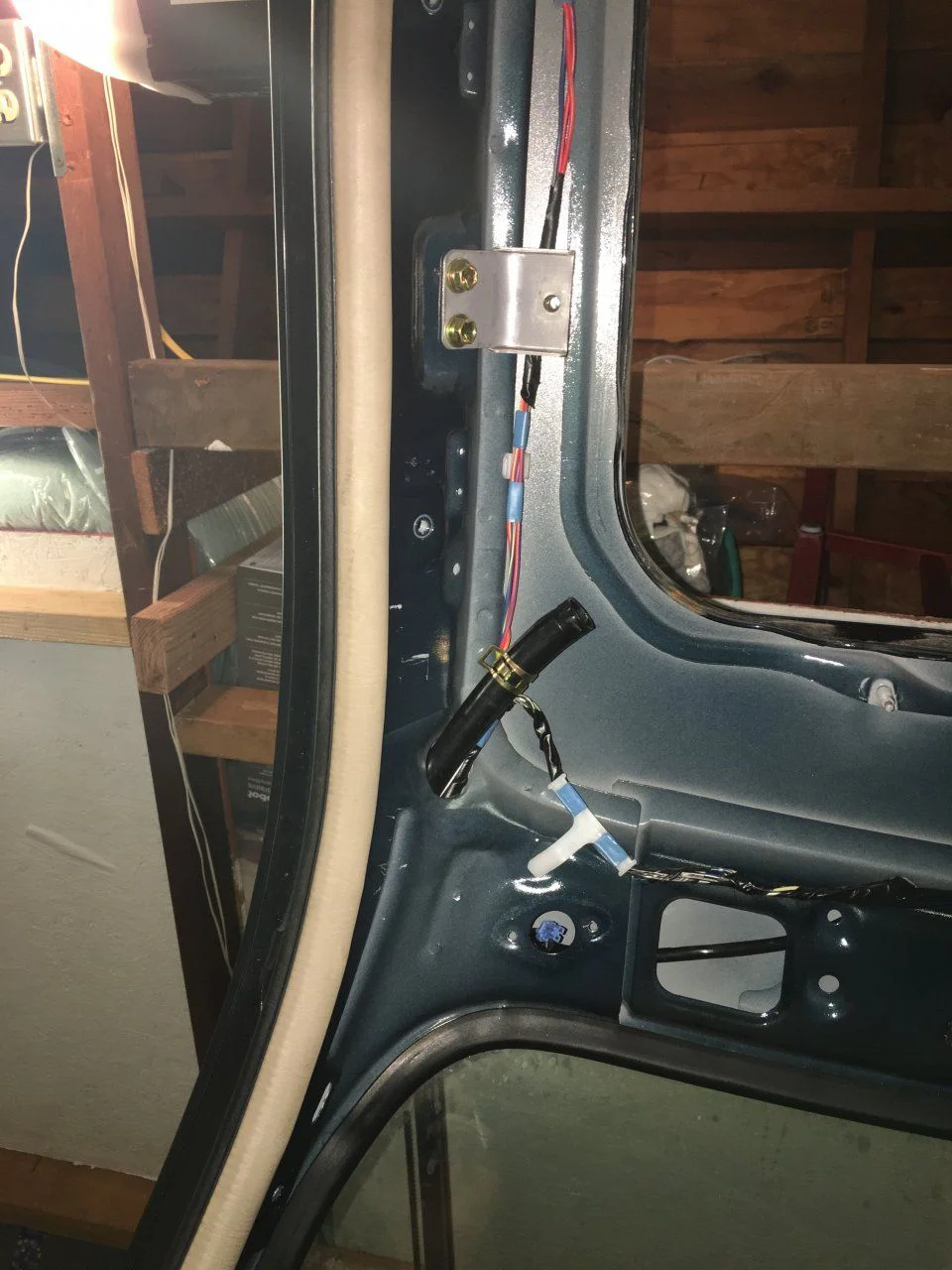

Let me take a pic for you.
Ok. You cant. That channel doesnt open to the sunroof controls. Those wires are just taped near that channel. Crappy pics but you get what you pay for

Excellent pictures, that clears it right up. I guess I'll have to try and find a clever way to retain the wires so they don't sag into the headliner.

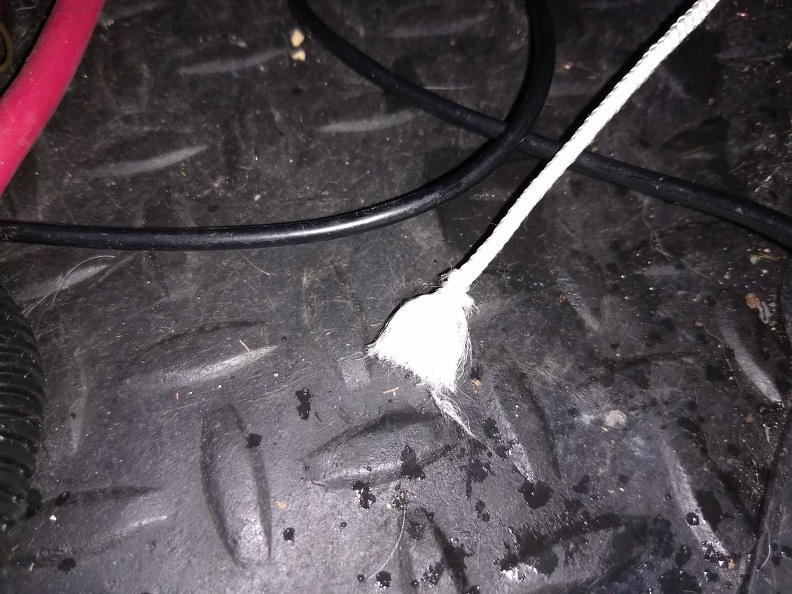

Okay, I finally got it! The solution to the A-pillar problem is to use a Shop Vac from below. It's easier on the right hand side. Just unplug the fat connector, then shove the Shop Vac hose up into the kick panel opening as far as you can:
i.php
Take some thin cord (thread didn't work for me) and fray the end out to increase drag:
