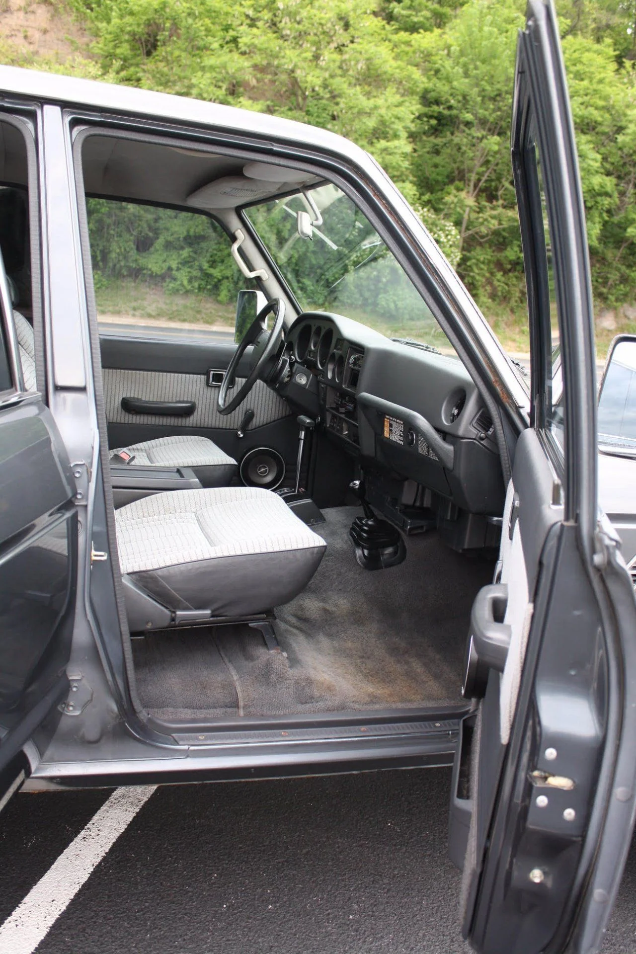

Thanks! I'll be going to see it in person this week. They did provide some more photos here:

The additional photos look pretty good, but they still don't show any potential problem areas in detail.
Don't worry, we are always skeptics here, and you're doing the smart thing by asking advice here, before you purchase the truck. A lot of guys here will tell you that they wish they had done the same.
Third pic... passenger front door, look in the sill along the A-pillar and you will see a LONG line of rust along the gutter. That is a perfect indicator that there is lots of rust in the windshield and possibly the roof. When you look at the truck pay close attention to that area and the gutters around the roof as you may have some serious roof rust that has been covered by mud and paint.
